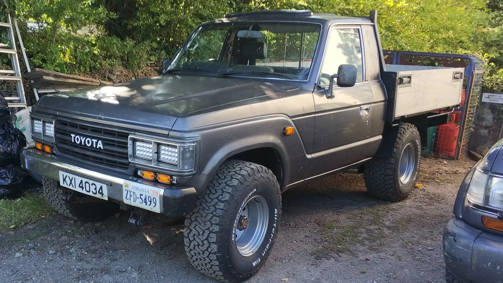

Just for some closure, I went with my heart rather than head a bought the 33x12.5s but with 15x10 rims and so far im pretty happy. When i get bored of them you can all say "i told you so".View attachment 1748416
Love your VA plate. Are you actually in the UK now?
