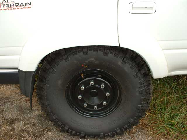

Do the lugnuts actually protrude out further than the rim? Anything you can do to keep them from getting mangled?
Yes, they do a little but they are massive and with the Volvo 6X6 I had it never was an issue and I wheeled the crap out of it.

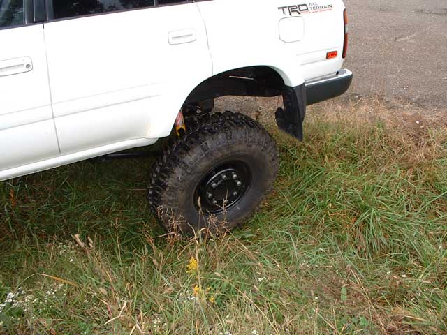

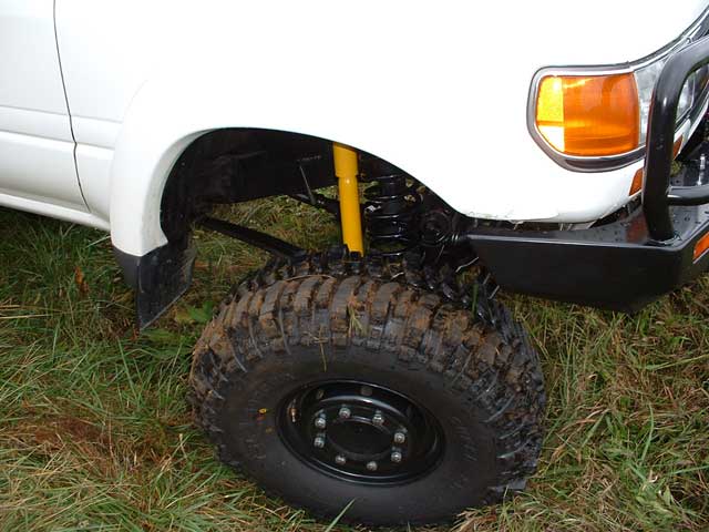

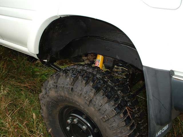

Here's the new springs installed...
Fully stuffed there's about an inch of clearance.
