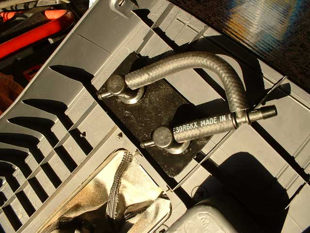

I wish you would show some more pics and some details on what exactly you had done to those axles, and also how you plumbed up the locker valves. Your truck is awesome, and this opens up a whole nother world of opportunities in tire size for us cruisers. Good luck with whatever your future mods are, so far your doin a kick ass job.
Here are some I've posted earlier, when I get caught up on everything I've neglected to build this thing I hope to do a detailed write up on it.
