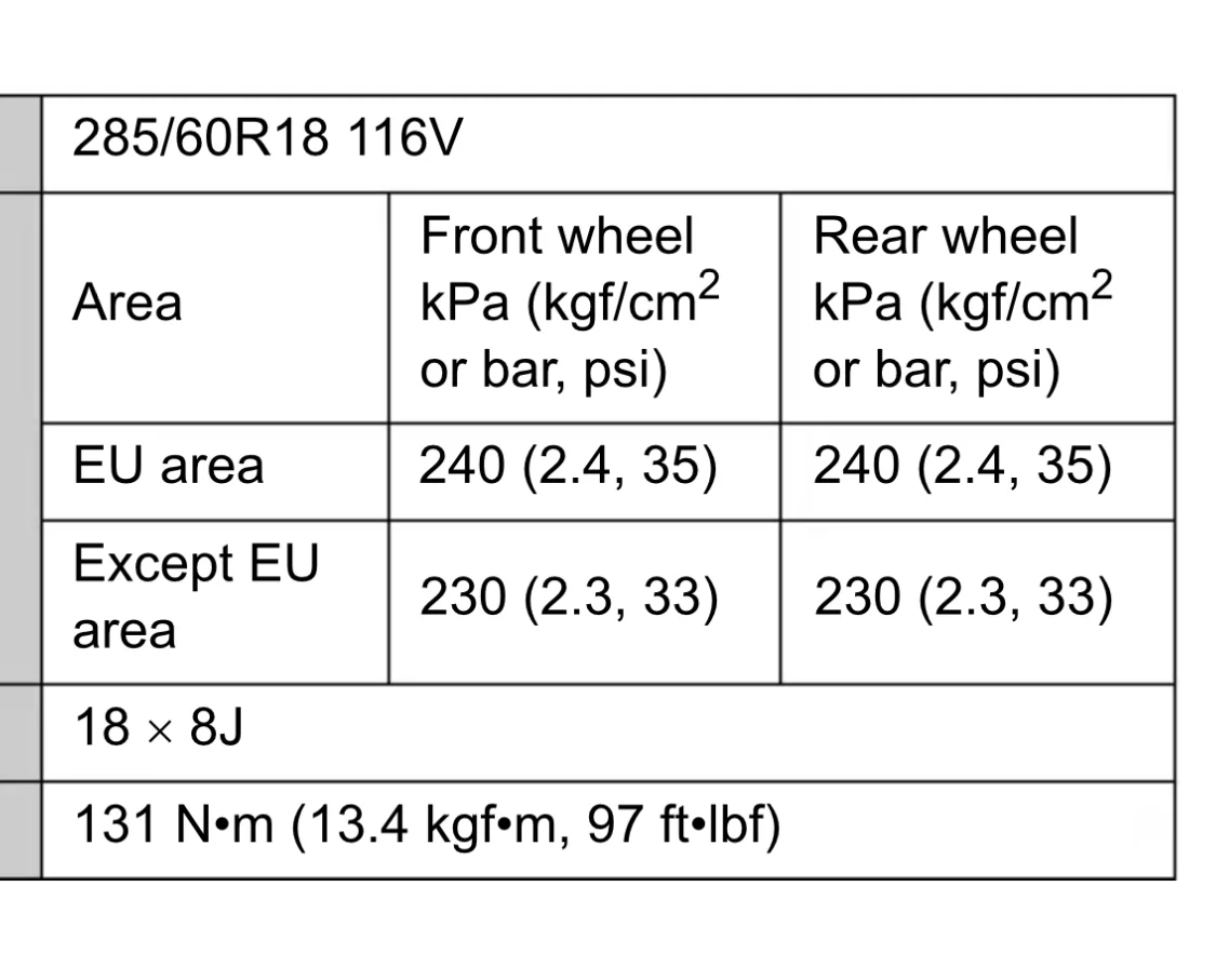

After a more thorough search of the online manual I found this. Since I am not in the EU it looks like my vehicle is rated at 33 psi with the stock 116 load index tires.
Well, i think that makes it similar to the USDM spec. So 43 PSI would be the RCTIP.

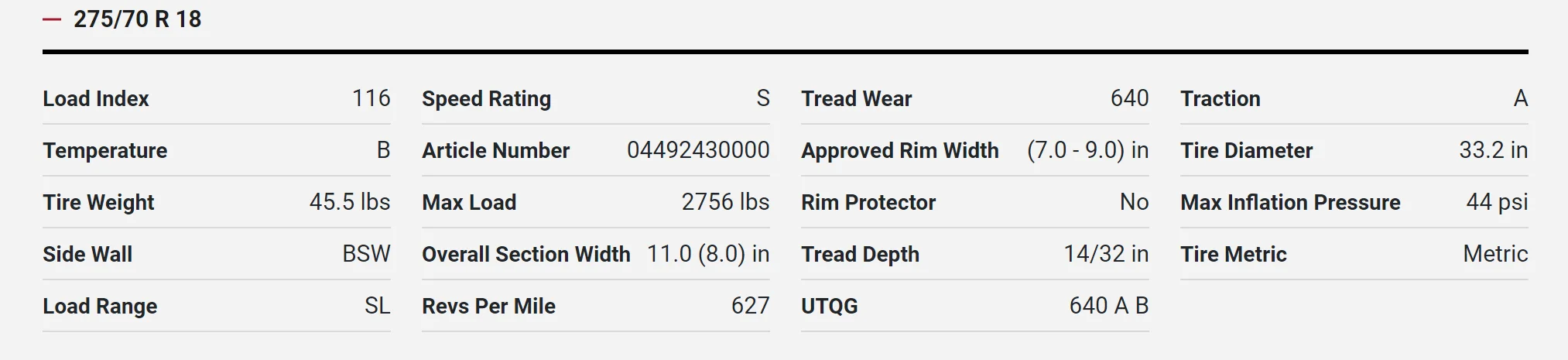

Tire pressures for General Grabber A/TX P 275 /70 R18 116S SL please.
No P-Metric tires that size listed by the manufacturer.
Do you mean this ISO-Metric tire?
And I need to know what vehicle you are planning on mounting these.
