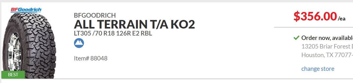

@gaijin could you calculate the RCTIP for 305/70/18 on an LX?
discount tire is going to let me upgrade my 275/70's 😏
Yes I could, but you would have to tell me whether the tires are ISO-Metric, P-Metric or LT-Metric - and if ISO Metric, what the Load Rating is. Tire make and model is always helpful so I can double check whether you are asking for a tire that actually exists.
You have asked about an ISO-Metric 305/70R18 tire, but somehow I think I would be wasting my time if that is the tire I did the calcs for.
Waiting for your further info.
HTH
Sorry! LT305/70R18 KO2s
The Recommended Cold Tire Inflation Pressure (RCTIP) for those LT305/70R18 KO2's on your LX570 is 35psi F/R.
HTH
Thank you, kind sir!
