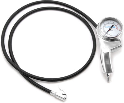

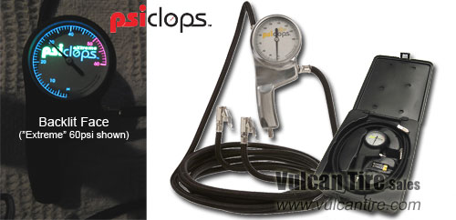

Several years ago I bought a Psiclops XPRS gauge with single hose and bleeder valve when tirerack had them on sale and it's what I use when I want accuracy. It's supposed to be accurate to 2% I believe, has a quick connect, air inlet, bleeder button and the gauge is back-lit in red and blue as soon as air goes in. It's cast aluminum with a thick braided hose, a sturdy carrying case, and I've been very happy with it. All my other gauges read somewhere around it but this is the one I count on for accuracy.
I also use it for airing up, both for it's quick connector and since the TJM compressor gauge is not as accurate.
Most analog pressure gauges have a "sweet spot"; a pressure range where it is most accurate. PsiClops gauges have a unique gauge mechanism that allows for 2% (+/-) accuracy throughout the range of the gauge eliminating the "sweet spot".
