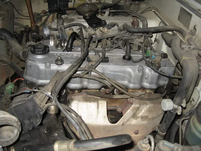

Here are some pics of the progress so far, the engine has about 170k on it and the timing chain was quite loose. Also some pics of my shop, and shop dog.
I see an FJ-40 bezel up there.
That is a stamped steel cam gear ya got there....
Not forged, holes not punched to distribute warpage and distortion, and definitely not factory. I'd at least get a cam gear that's either forged, or....forged.
Get some factory, or some real good aftermarket.
Toyota Tchain covers go for about a hundred in my parts. If you can get a Yoter one, I'd get one. Don't get one with wear rings around where the oil pump goes. It can be enough to let oil get by and your motor will have less OP. I have herd some aftermarket TC covers have fitment issues. I have no exp w/ them though, I try to use only Toyota parts as much as I can.
