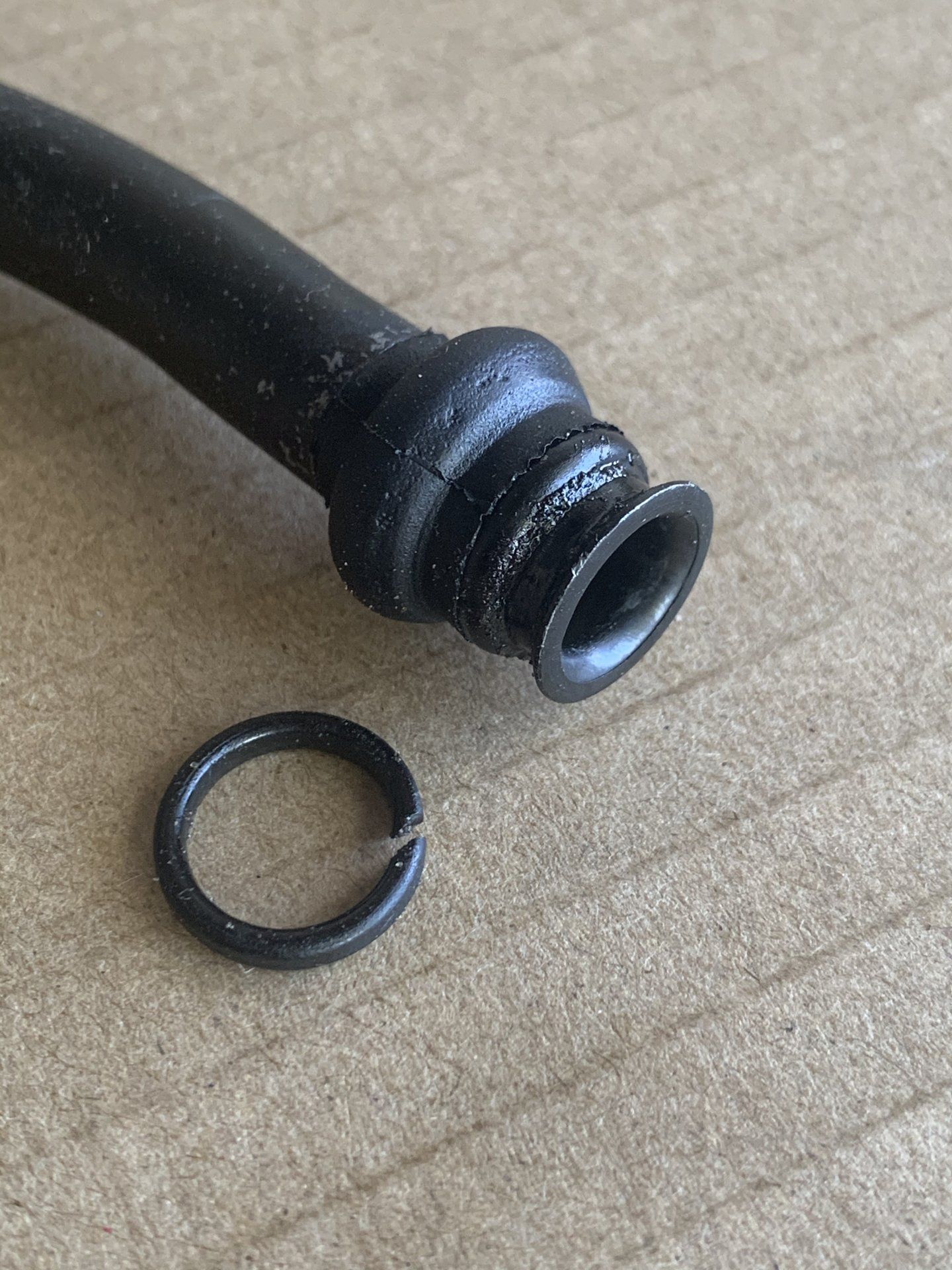

As one mudder here suggested me to check the base of the dipstick tube, I realized that too was weeping oil so I went ahead replaced it.
