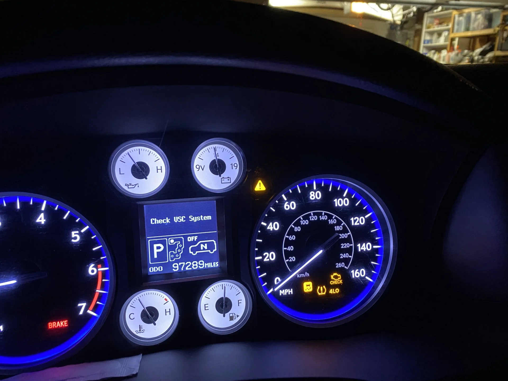

A few months back when the fuel sender unit was replaced the battery was also replaced with a new AC Delco unit. I haven’t driven the truck much between then and now, probably once every other week. Yesterday I went to start it up, and no go. Just a click, then nothing. Lights and radio on, but no crank. I put a booster pack on it and was able to get it started up. Drove around the block a few times, put it in my driveway and put a trickle charger on it. Battery trickle charger said the battery was sulfated, and it went into de-sulfate mode, which would take minimum 10 hours.
This morning the battery appeared to be ok. Trickle charger said it was charged, but the truck did not start. Even with a booster pack. Lots of warning lights- check engine, 4lo, CEL, Check VSC, etc. One click then nothing. I then tried jumping it with my Volvo but same thing, one click and it wouldn’t even turn over.
This evening I swapped batteries with my Volvo as a test. The LX battery started up the Volvo without any hesitation. The Volvo battery did not start the LX. Same thing, one click then nothing. Put back on the trickle charger and it looked good, no sulfate warning and the battery appears to be charged.
I get 12.7V between terminals, and I think the same between the battery and the starter, but to be honest I’m not sure I have located the starter correctly.
I read perhaps it’s the immobilizer and have tried a generic Lexus sequence of locking/unlocking with the metal key, but no go.
At this point I’m not sure what else to test. I hoped to get it started with the Volvo battery just to drive it to my local shop, but I can’t even get it started. I hate to call AAA but that’s the next step. Camping trip planned next weekend, assuming I can get this sorted!
Anything I missed? Any other thoughts? Thanks! 🤙
are you sure it’s not a bad starter solenoid?
Like @tbisaacs, sounds like the starter to me if you've never replaced that.
These maybe inter-related issues, all somewhat catalyzed by a low battery. Problem with batteries in low states of charge is that they really sag in voltage from significant draws. Motor and other inductive devices will still try to pull the power they want and makeup for the low voltage with more current. Current destroys contacts when these draws are upward of 30% more amps, and the starter solenoid is one of those vulnerable in higher mileage.
I believe you'll want to replace the new battery too as any lead acid is permanently damaged when drawn low. Still begs the question why the battery is getting depleted more easily?

Looks like it's the starter. Mechanic (SD Trux) suggested that perhaps its life was shortened due to the fuel pump sending units failure, causing a lot of repeated failed start attempts. It's getting replaced as we speak.
