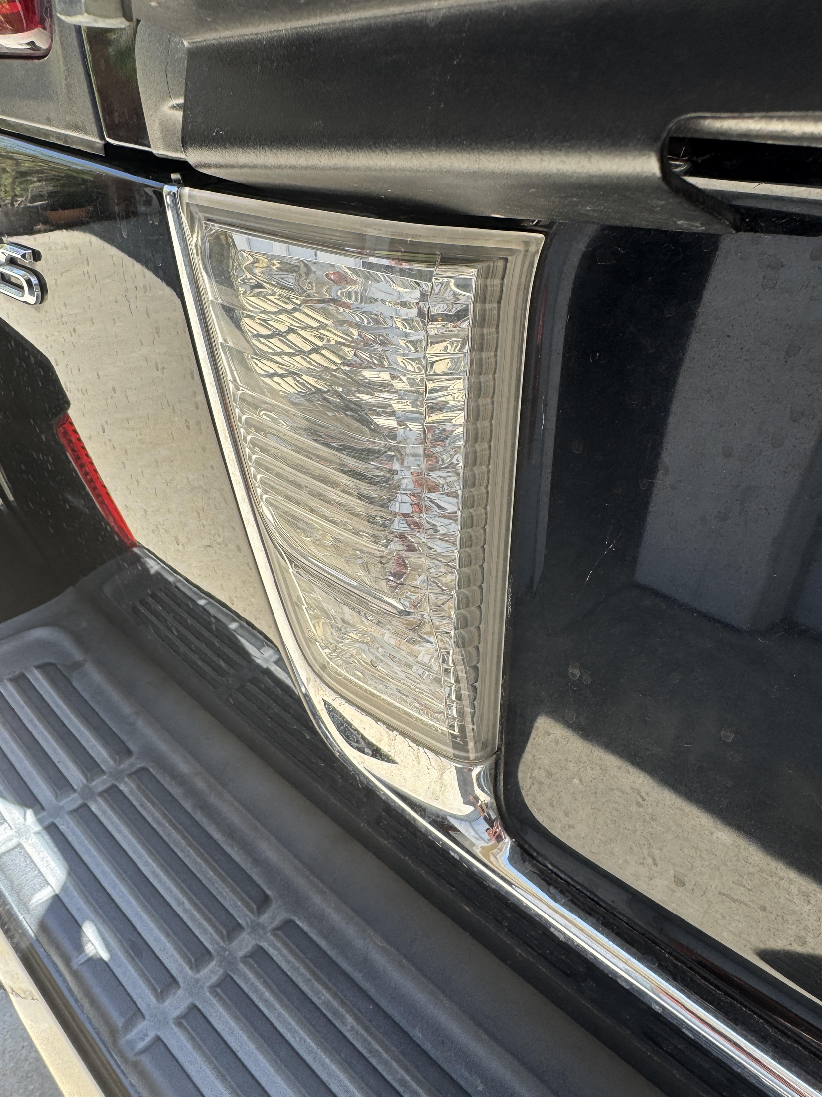

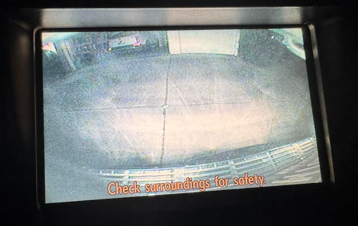

Howdy all. I don't have any big projects lined up for my LX at the moment, so I figured I'd spend a little time looking at some minor annoyances. At the top of the list for me personally is the infotainment screen. I don't want to swap it for something more modern, but I was looking for ways to get an improved image.
My biggest gripe is the image when reversing at nighttime - the stock bulbs seem plenty bright, but the image I see on the screen is all but useless. I did a little test with three 900 lumen flashlights, and the additional light certainly helps, but I don't think I can find replacement reverse lights with anywhere near that output. Any thoughts on improving screen image/camera resolution? I've looked at swapping the camera itself too but haven't uncovered anything. To anyone who's replaced the reverse bulbs, did you notice much imrpovement? I am considering these XPR LED's from Diode Dynamics...but it's a lot to spend on reverse bulbs if they're only going to provide a negligible improvement.
Any thougths welcomed...
Here is the image when reversing at night currently. You can see curved streaks of light on the ground, which I suspect are from the ridges in the bulb housing itself. This definitely does not help with image clarity because it makes it appear as if the camera is dirty...but it's not.
With a few high powered flashlights, things improve a lot. I just can't imagine I would get anywhere near this output from reverse bulbs...and even if the output was good it would still have those streaks from the bulb housing. Top pic has the flashlights sitting on the bumper, bottom pic they're on the ground beneath the bumper.

Interesting thought on the reverse bulb. I've been meaning to upgrade the bulb for awhile as it's probably one of the very few left that's still an OEM bulb. Never thought to upgrade for enhanced backup cam function, but it makes sense. I have auxiliary rear (red) fogs I often use when offroad and I do notice that it adds to visibility and contrast over just the standard backup lighting.
Are they 921 bulbs? I might just try with some mild grade LEDs and see how it goes. Probably more important that they are high CRI versus high lumen? I might even have some bulbs lying around as 921s are common for RVs.
You may find interesting, the OEM camera has more fidelity and resolution than the OEM MFD is capable of displaying. I have it integrated to an aftermarket TESLA screen that is larger and higher resolution and it works well. Also interesting is that the OEM display crops the output of the camera. You can see the bottom left of the camera FOV that it catches part of the OEM trim, which is potentially why they crop.
I've got the DD reverse LED's in mine (the XPR variant with DD SKU: DD0394P). They put of a lot of light and are seconded to only the rigid pods I had rigged up in my old truck that were fantastic for reversing offroad/dark untraveled roads. I don't think they're 921's @TeCKis300 , but could be mistaken. The DD bulbs take up the majority of the reverse housing and I could see this as being problematic if you were to leave them on for a long time with heat generation. I would recommend them for anyone who wants more light while reversing.
