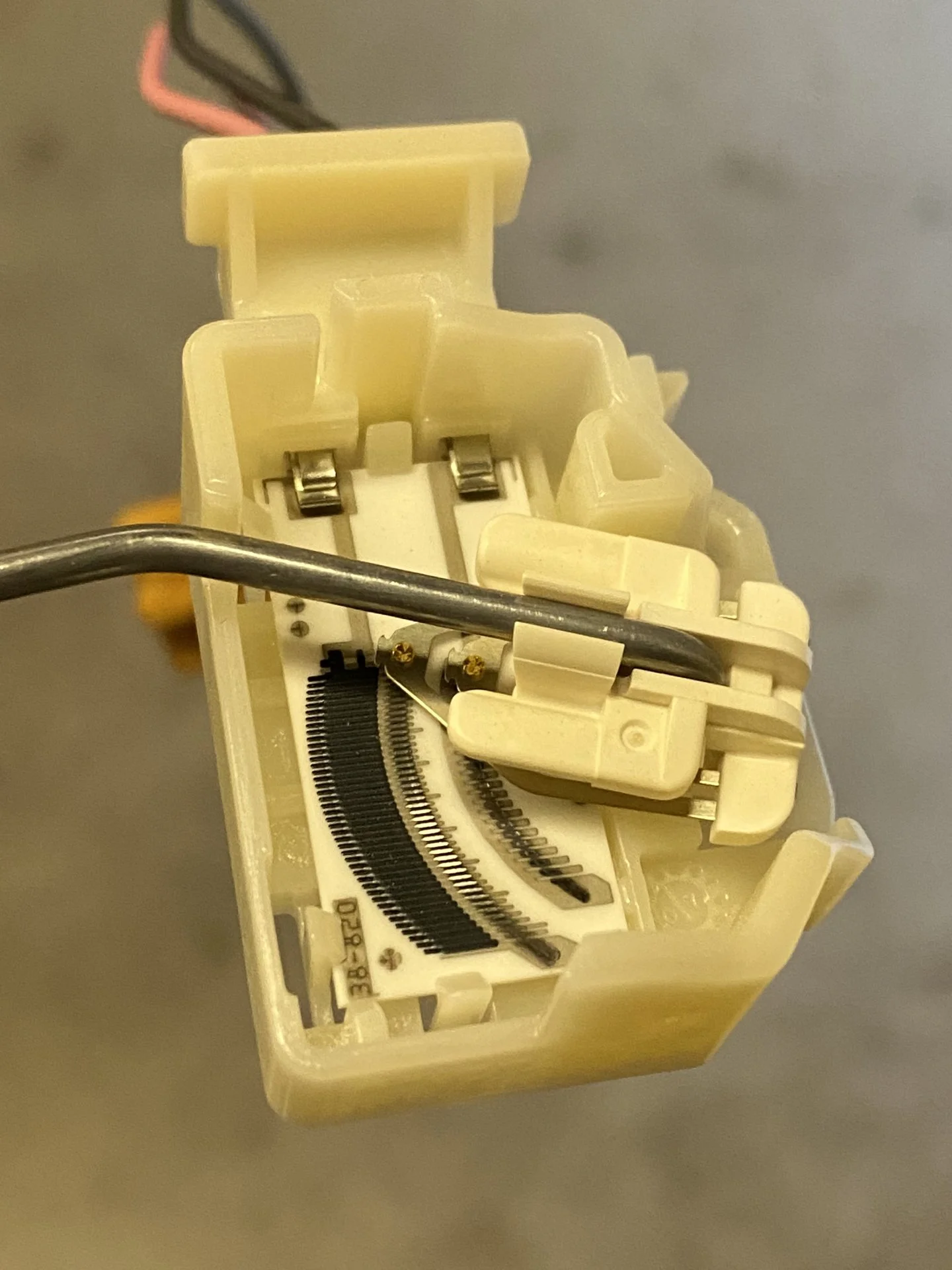

$650 for a new fuel sender unit. A bit of a drag as the repair bills for this truck have been higher than expected, but it had to be done. The old one looked brand new too (below). Hopefully this solves my inaccurate fuel gauge issue.

SD Trux helped me out with this one. The write up to remove the 2nd row seats to access the pump/sender was pretty daunting for me personally, so I opted to have it done professionally. I thought it would’ve been more $$ honestly, but they only charged 3 hours of labor. I think it was fair.
I asked both the owner and the tech if I should change the pump while the tank was dropped and they both (independently) said not to. They said they see the sender fail 10x more often than the pump itself. Out of curiosity, why did you change your pump?
I should note it’s still not confirmed that this resolved my issue- they said the fuel level read higher once the new sender was installed, but it’ll take a while for me to trust it fully. I’m thinking of putting a few gallons of gas in a Jerry can and running it to empty just to confirm. I’ll update if that plan actually takes place!

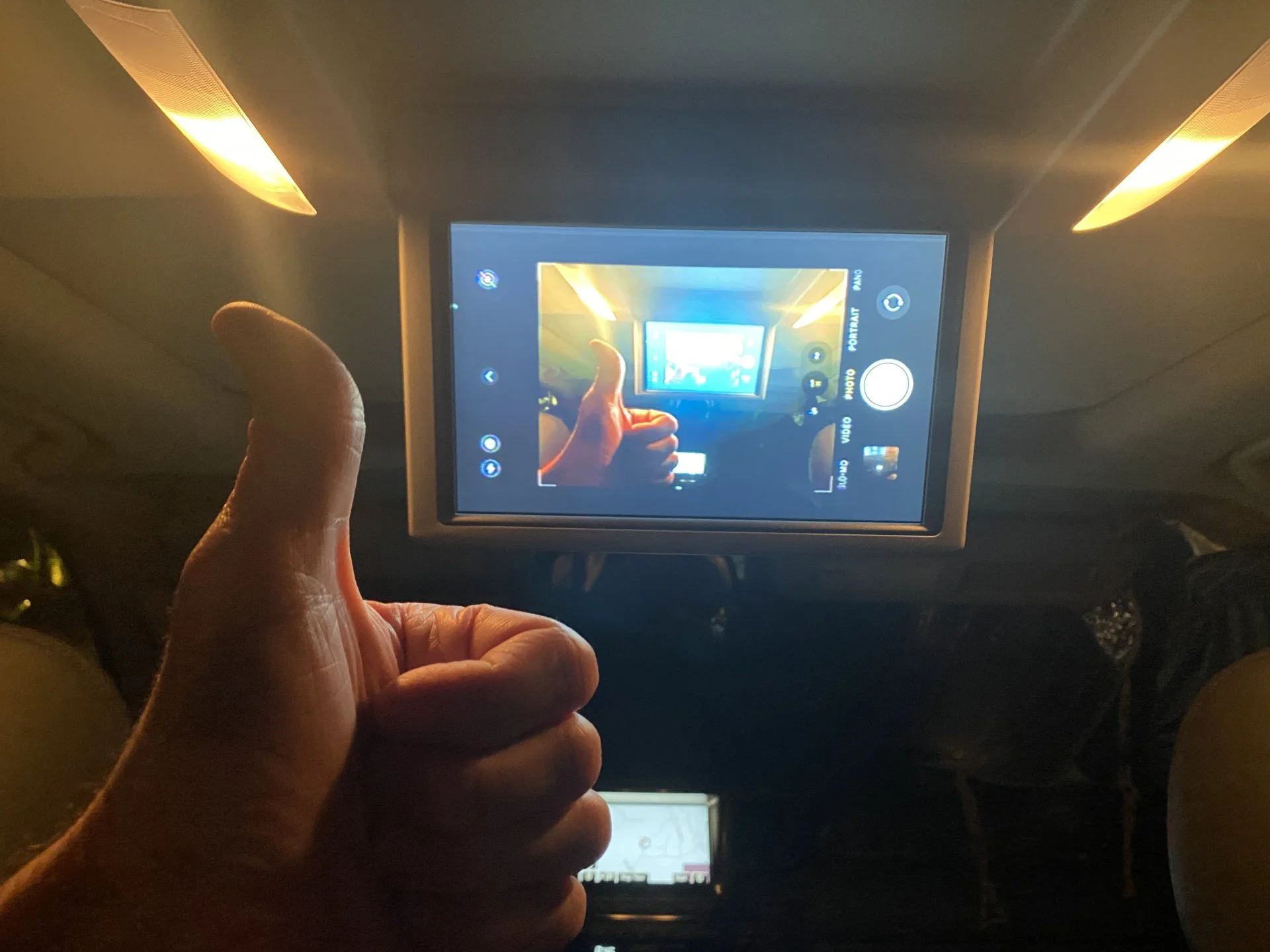

Amazon Fire HD tablets do not support Display Port Alt which is a requirement for any of the USB-C to HDMI/RCA adaptors to work. A laptop would probably work, or the easiest thing to do is get a Fire Stick and an HDMI to RCA adaptor.table (Amazon Fire HD) to register on the screen. I'm using the USB C --> RCA adapter
Looks like a wonderful adventure with the family and 200!Went on a fun camping trip last weekend in Temecula with two of my kids. Finally got to experience some autumn weather which was a nice change from the heat here in SoCal. On Saturday it started to rain pretty hard, and after being cooped up in the tent it occurred to me that we could do a movie night with the fold down screen in the middle row. This didn't pan out because I couldn't get the table (Amazon Fire HD) to register on the screen. I'm using the USB C --> RCA adapter in the link below, but never got any video or audio. I just ordered a USB C --> HDMI adapter, as well as an HDMI --> RCA adapter, so I'll report back on whether that works. That seems to work according to some other threads on here.
This is what I have, and so far I have not gotten it to register on the screen:
Amazon product ASIN B09BMW8BD8
Awesome, thanks for the info! That’s surprising about the Fire, what a budget piece of tech! I do have an old iPad that’s still clinging to life, I’ll see if I can that to work. Appreciate all the troubleshooting you just saved me from.Amazon Fire HD tablets do not support Display Port Aux which is a requirement for any of the USB-C to HDMI/RCA adaptors to work…
Copy that, thanks! Looks like I’m starting over now with an early generation iPad. Will update once I get down the road a bit.Looks like a wonderful adventure with the family and 200!
I have also had a hell of time getting the RCA to android and Apple cables to work…
I tried the alternate route today thanks to @lx200inAR. I didn’t have my old iPad handy to test but I used my iPhone, and it pretty much worked.Amazon Fire HD tablets do not support Display Port Alt which is a requirement for any of the USB-C to HDMI/RCA adaptors to work…

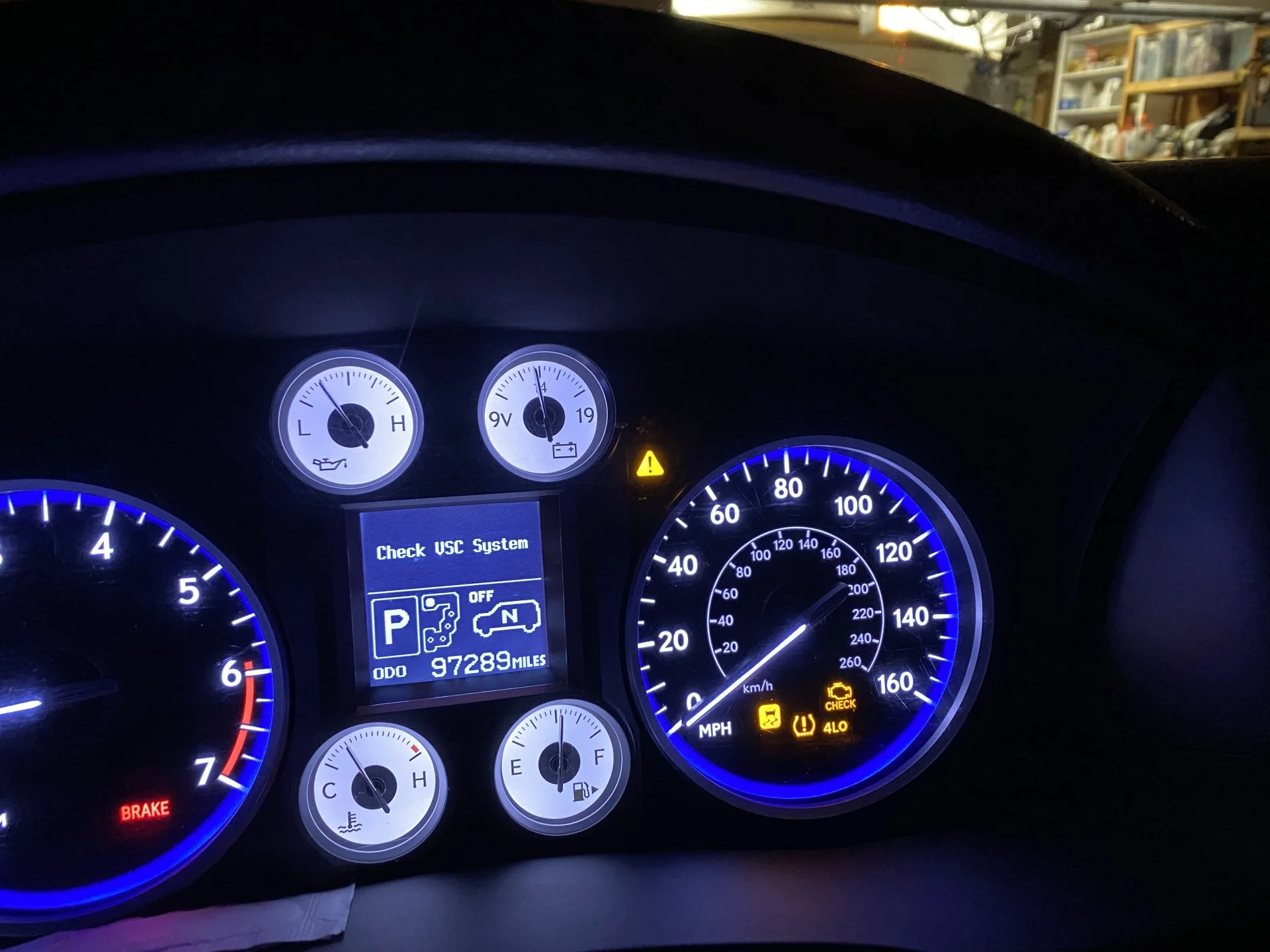

It may be worth having the battery tested. I have read through an embarrassing number of service histories. These trucks eat batteries. Maybe the Volvo battery can't quit turn the big v8.More issues, looking for some guidance before I have the truck towed to my local shop.
A few months back when the fuel sender unit was replaced the battery was also replaced with a new AC Delco unit. I haven’t driven the truck much between then and now, probably once every other week. Yesterday I went to start it up, and no go. Just a click, then nothing. Lights and radio on, but no crank. I put a booster pack on it and was able to get it started up. Drove around the block a few times, put it in my driveway and put a trickle charger on it. Battery trickle charger said the battery was sulfated, and it went into de-sulfate mode, which would take minimum 10 hours.
This morning the battery appeared to be ok. Trickle charger said it was charged, but the truck did not start. Even with a booster pack. Lots of warning lights- check engine, 4lo, CEL, Check VSC, etc. One click then nothing. I then tried jumping it with my Volvo but same thing, one click and it wouldn’t even turn over.
This evening I swapped batteries with my Volvo as a test. The LX battery started up the Volvo without any hesitation. The Volvo battery did not start the LX. Same thing, one click then nothing. Put back on the trickle charger and it looked good, no sulfate warning and the battery appears to be charged.
I get 12.7V between terminals, and I think the same between the battery and the starter, but to be honest I’m not sure I have located the starter correctly.
I read perhaps it’s the immobilizer and have tried a generic Lexus sequence of locking/unlocking with the metal key, but no go.
At this point I’m not sure what else to test. I hoped to get it started with the Volvo battery just to drive it to my local shop, but I can’t even get it started. I hate to call AAA but that’s the next step. Camping trip planned next weekend, assuming I can get this sorted!
Anything I missed? Any other thoughts? Thanks!
