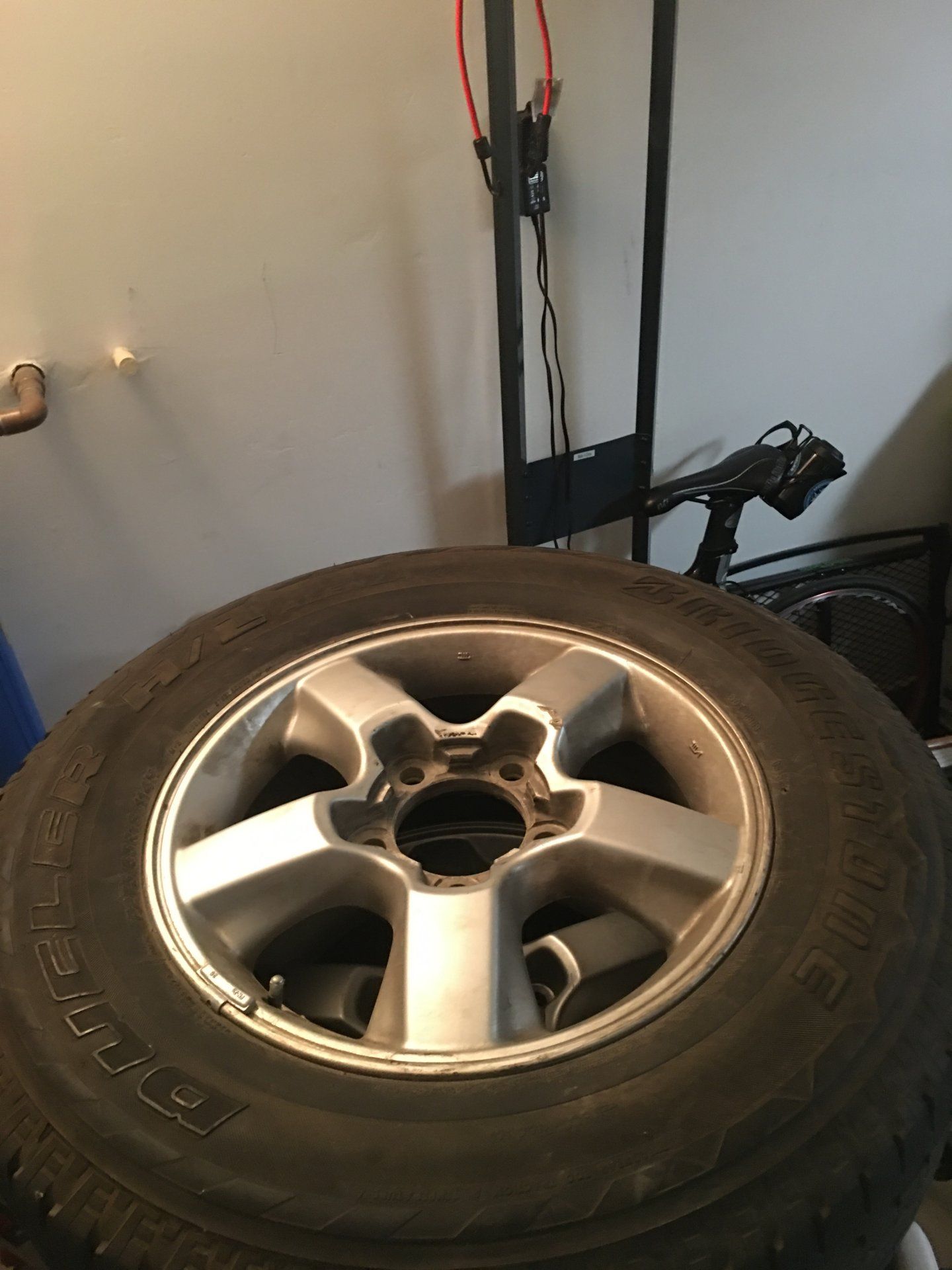

Could anybody chime in on whether the 18” x 8” 100 series wheels will fit on the LX570? My brother has an extra set laying around, and if they fit it would save me from having to purchase off-road rims. He’s a few hours away so I can’t just pop over for a test fit.
I believe they are p/n 69479A, photo below.

...but it’s still a little inconclusive from what I’ve read. Bolt pattern matches, and I assume the bore’s the same. I am hoping to avoid spacers, so I’d like to determine if they’ll fit around the 200 series brakes without any modification.
Thanks for any input!

Small fix here, the 200 uses 5x150mm. 5.5" is the recent Jeep wheel pattern. Lots of rim in that pattern of course, but the offsets are all bad for our rig.
They will fit. You will need spacers depending on which tire you choose to fit, to either clear the UCA, or to fix scrub radius. Those only come into play if you are sizing up significantly. I have run 275/65r18 with no spacer and no rubbing.

Thanks for the clarification. Given the clearances offered by the AHC lift, I was hoping to get slightly larger tires - 275/70R18 , or 285/70R18, however I was also really hoping to avoid spacers. I wonder if perhaps these are not the best rims to use to meet these criteria...
You will rub the UCA at some point. You can go out and measure how much vertical room you have to it, but AHC lift doesn't move the UCA.
Yes, a less positive offset wheel (RWs at 50mm, Evo Corse at 40mm etc) will help this.
my bad! looks like the 69479A your brother has are a 60mm offset, same as your stock wheels and most other oem wheels (except the RWs @ 50mm).
