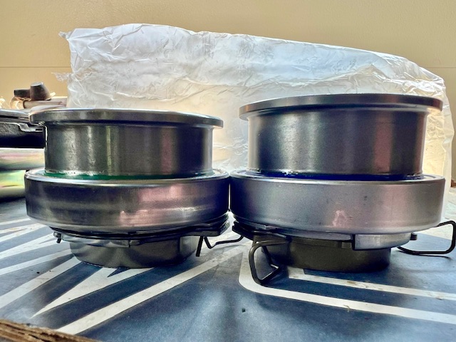

Can anyone confirm the correct part number for a 1HDT with a H151 or 152 transmission? I seem to be getting different part numbers.
I ordered a 31230-60181 and it is a touch shorter than the generic one that came in the Terrain Tamer kit for my truck.
Can anyone steer me right?

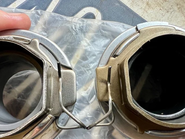

This is what I’m looking at. Slightly taller one came in the TT kit 6874. I’m reasonably certain I grabbed a throw out bearing for a later truck but I need to check.

Yup, that's the difference between s clutch that works, and a clutch that does nothing

31230-60130 is what you are looking for
31230-60181 is for an FZ
Yeah the throwout bearing for the VIN my engine came from (via Partsouq) is the 31230-60120. Not 60130. But then my engine/trans came from England with a 275mm flex instead of the larger 300mm which I upgraded to.
Just need to figure out now where I stand with the mishmash of early & late parts. Ugh.
EDIT: Wrong Part Number listed first.

FWIW measuring the distance from the carrier seat to the end of the input shaft is identical btw the early H151 and new H152 (with 1HDT shaft).
The difference in bearing size is ~1/4"
Completely a guess but I'm guessing Toyota changed the clutch cover dimensions and matched the bearing to that. The TT clutch kit must use the earlier style cover bearing for all years since it doesn't matter as long as they are matched.
At least that's my theory unless anyone drop any more knowledge bombs on me.

The difference for mine was 5mm.
