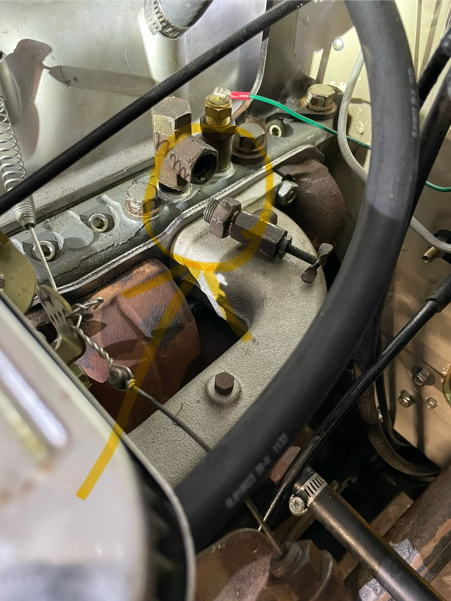

Lil help please.
Does anyone know the thread size and pitch for this heater petcock coming off the head of a 2F Engine?
1/2" BSPT is the correct size. 1/2" NPT is close so you can make it work. They both have the same thread pitch of 14 tpi but the taper is different.
When ordering 1/2" BSPT fittings on Amazon or Ebay, who knows what you 'll get. I've ofthen found they fit no better than 1/2" NPT and I don't have to means to know if it really is BSPT with lousy machining or just simply NPT passed off as BSPT. Good luck!
