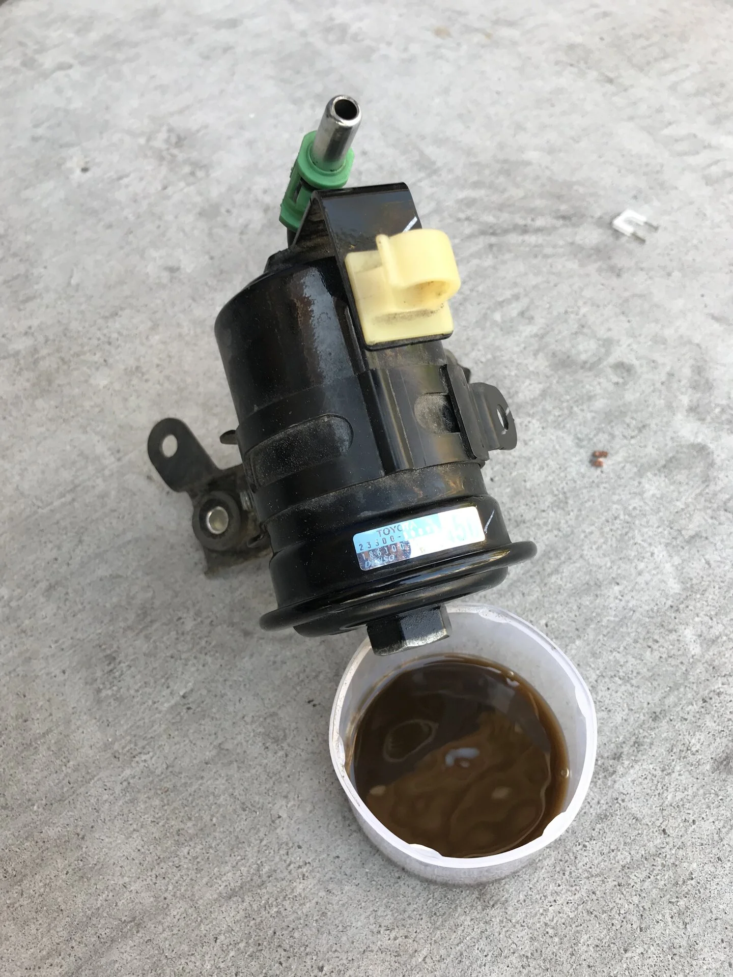

Here’s mine at @ 235k miles and this one was still original from factory. It’s really hard to compare pre and post fuel filter replacement as the 2UZ’s idle was already smooth.
No big sediments at the bottom of the cup, just dark fuel from the filter.
