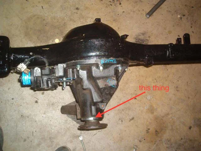

Check he rear pinion. The little metal crush washer or whatever. On the diff behind the york. Mine came loose. Sounded just like that.

The dust shield on the pinion was my first thought.
