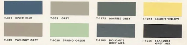

J Mack would know if it's nebula... I always liked that 45, but the colors and white walls killed it for me.
