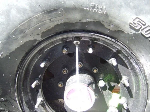

Had fun getting ready for the TB jambo next weekend.
I am not a huge fan of full throttle vertical climbs and I heard that water in teh tires will give you a bit of an edge. So I decided to try it.
fancy dancy little adapter allowed me to hook a garden hose directly up to the front tires. I used a ball valve (green thing) so I could control the flow better. It actually worked great with a slow rate and the Klune R.A.D valves I have. The valves allowed the pressure to dissipate and then basically told me when the tires were full.. Course, I still overfilled one ;)
It is just odd watching water spray out of your tires :D
BTW, I weighed the tires before and after.. 130# without water and 308 after water..

Just filled to the top of the rim.
Yeah, the spring rates will change because of the water (water does not compress) but the little pocket of air makes it work fine.
no real handling differences on the road.
