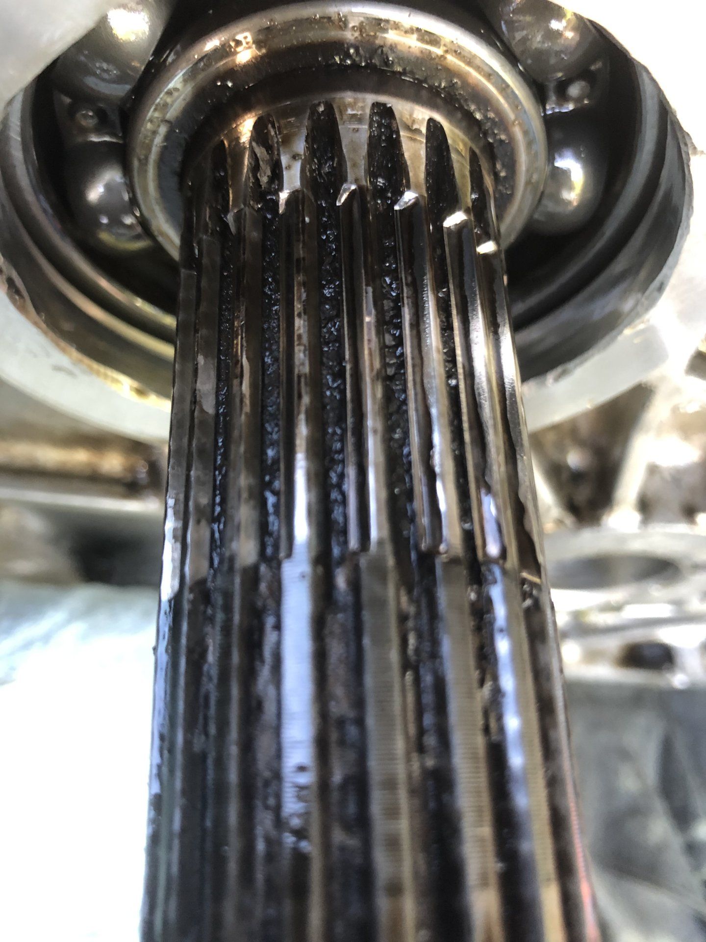

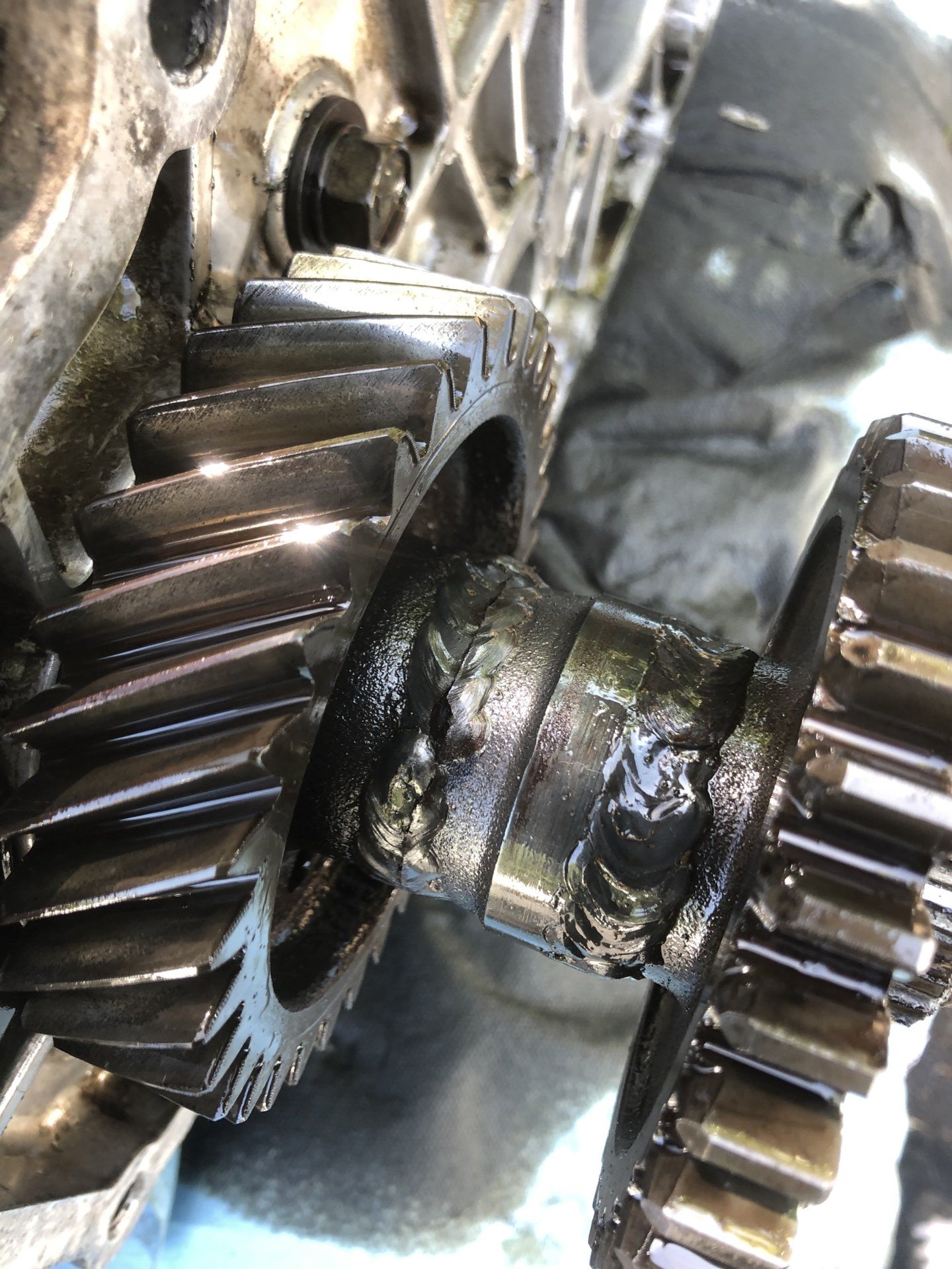

Tearing open my transfer case today for a rebuild and I find this:
1974973
Now I haven’t been inside of one of these before, but something tells me this isn’t how the input and drive gear are supposed to look. Also that weld looks pretty broken to me, but I’m no expert.
Thoughts? What’s the prognosis?
Wow. Never seen that before.
Maybe the transmission output shaft wore out and this was the idea of how to keep using it. Get the fresh splines with the pto gear
Someone made a homemade Mcnamara gear, and did not weld it very well.

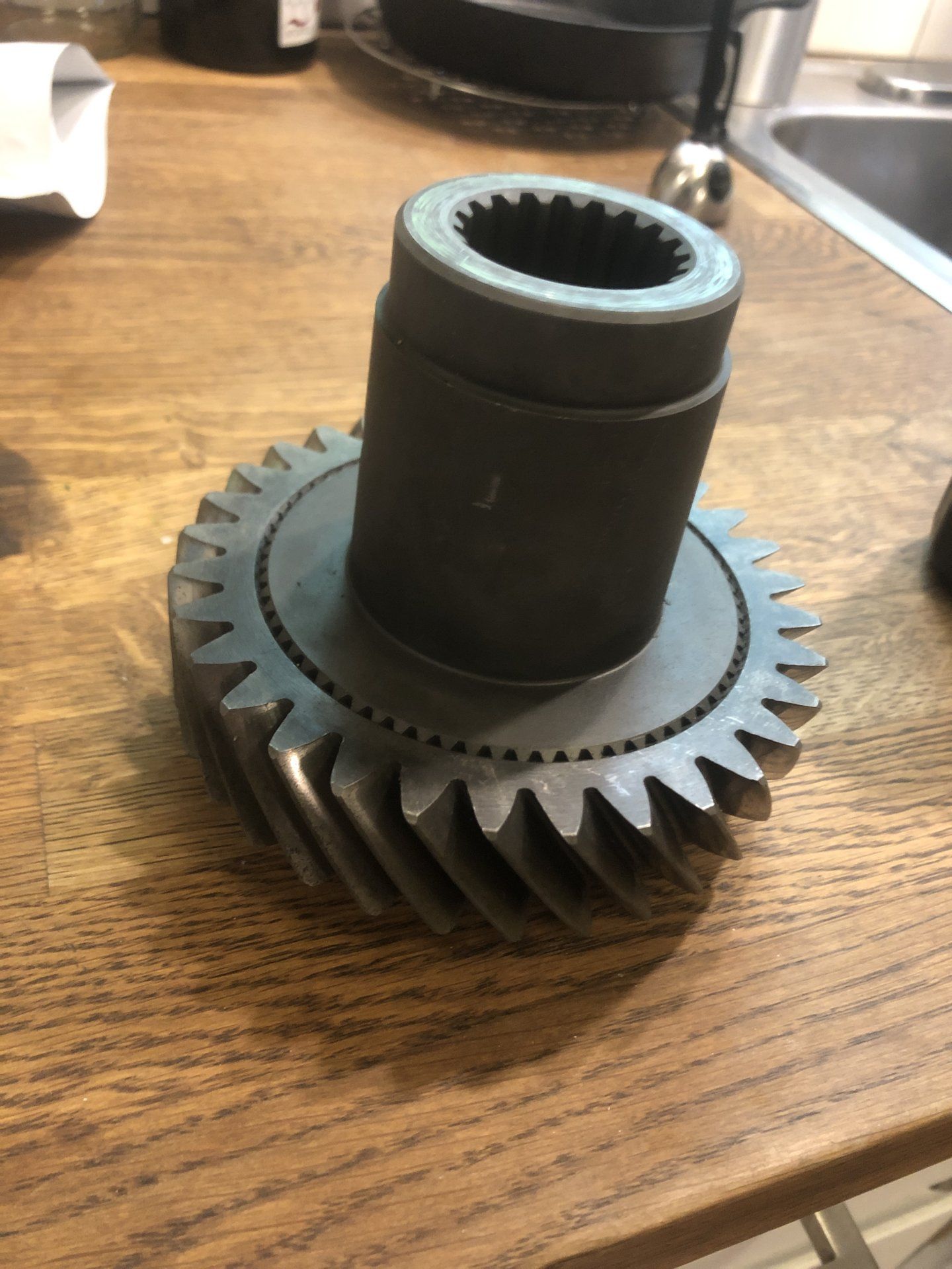

Rebuilding because while doing the clutch i found the input shaft was toast. Looks like the bearing froze in place and started wearing away the metal. Since pulling the input shaft requires disassembling the transfer case, figured this was a good time to rebuild. You’re all right about what was going on in there, and thankfully a real McNamara gear magically appeared and I’m hopefully back in business.

Yeah your first post was a DIY McNamara gear. Weld looked okay, but I'm betting it cooled too fast and weakened. To do it the right way you need to clean it well, put it on a jig (Georg @orangefj45 uses a repurposed tranny output shaft to keep the splines aligned), weld it and then wrap it in weld blankets so it can cool slowly and not get brittle. Had the PO done it right that weld wouldn't have broken. But now that you've got a real McNamara gear and are doing a rebuild, you're good to go.
