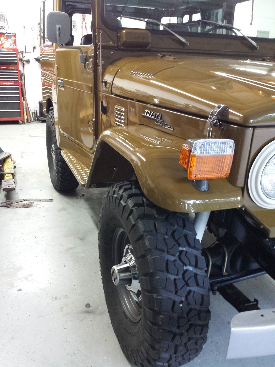

Every day I get one step closer. Last night my son and I spent several hours aligning the aprons, fenders and hood. What a pain. They aren't perfect, but I am thinking it wasn't perfect from Japan. The replacement fenders needed a lot of tweaking and some holes redrilled. I couldn't have done it without his help. I went to put on the hood hardware and realized that I never got the windshield bumper brackets painted! So, I dropped them off at the painter and he said he would get them done in a day.

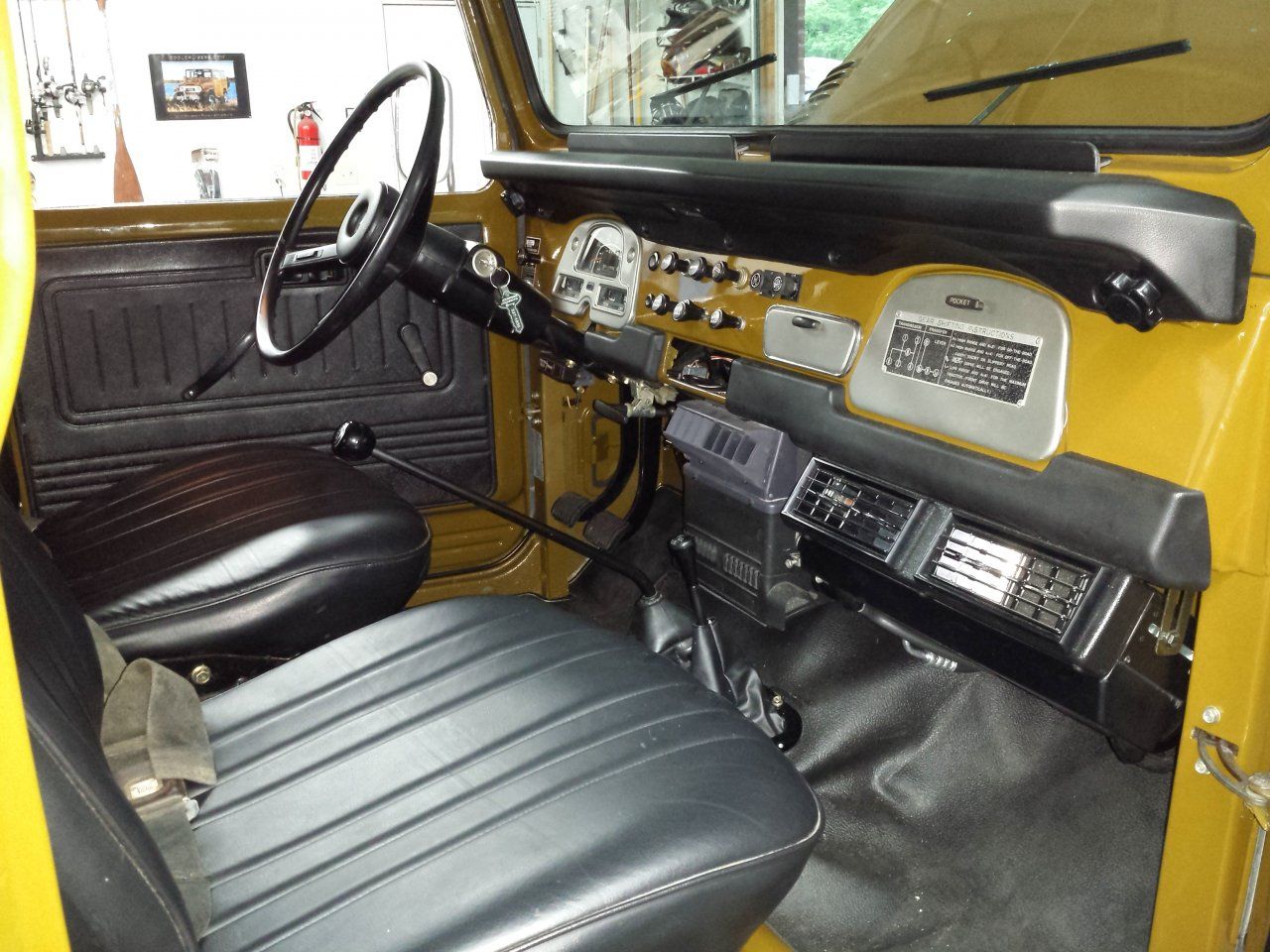

Well she is complete once again. I took it on my first shake down ride today. I went about 20 miles. A/C blowing cold and engine temp stayed steady on the gauge just under the high normal mark. It was about 96 degrees outside. I can live with that. The ride was very nice, smooth and quiet. I think I could out run it on my road bike!
Now for the problems:
1. Second gear is grinding at times, and I am going to pull the tranny later and figure that one out. I replaced the syncros, so I am curious as to what I missed. I should have taken some of the advice I got and just found a good used 4 speed. But what is the fun in doing that!
2. My brakes suck. I have bled them, adjusted rear shoes, burped the rear cylinders, and bled them more. Everything is new, except the brake booster. I am thinking I have a bad new master. The pedal is very soft and gets better with several pumps. Sometimes the brake light flashes. Yes, I bench bled the master.
Those are the two big issues. Funny, as I didn't see those coming. I really thought I would have issues with some other stuff. I have several other minor fit and finish things to take care of, but, for the most part she is on the road again.
Thanks for all the support.
