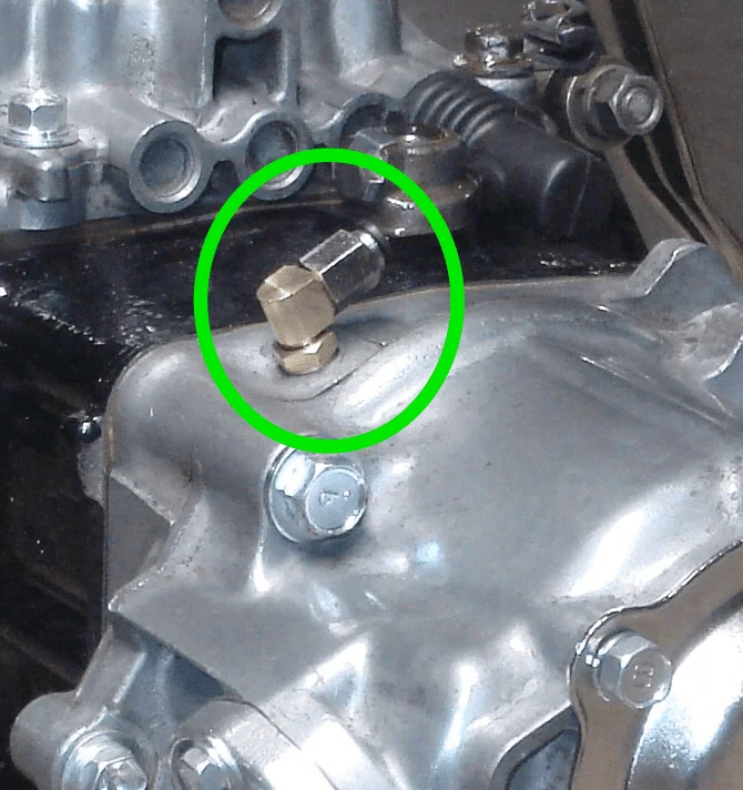

One of the possible causes of transfer to transmission oil migration is the one way breather installed in the transfer case. It lets air out (as it heats up) but doesn't allow air in when it cools down. This cooling after every engine shutdown creates a vacuum inside the transfer case and when the seals age, oil can get sucked from the transmission into the transfer case, especially on the 5 speed transmission.
If a breather hose extension is installed in the transfer case and routed up to the engine compartment, the transfer will then breathe freely and air pressure will equalize.
ARB makes a differential breather kit that has the hose & fitting & filter mount. The brass part that goes into the transfer case you can get at McMaster Carr

Sorry for the thread hijack, but I'm looking for this part on Mcmaster Carr and I'm not sure i'm finding the right one, does anyone have a specific reference? Thanks!
