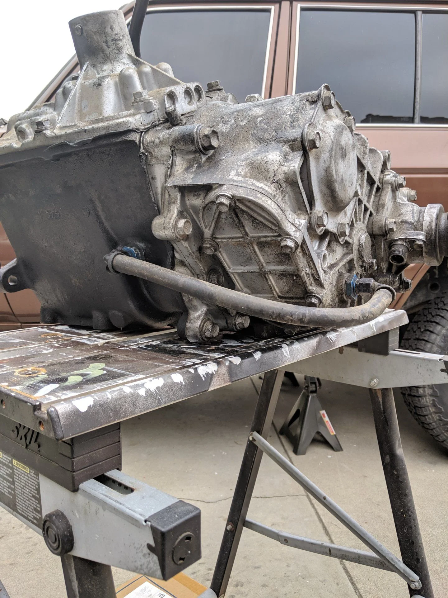

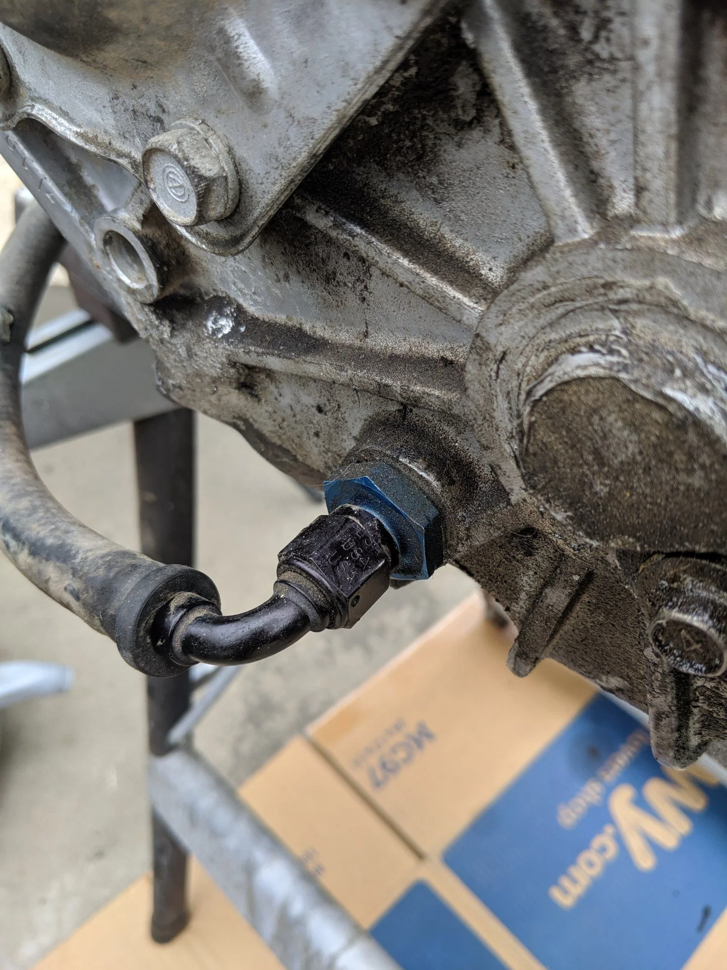

This brings me back to not really understanding why the bypass hose can't be used as a long term solution and why it would be good for me to remove it if/when I rebuild the t case. Everyone keeps telling me that it's a bandaid and that it's not good for long term use, but no one has said WHY. If they both use the same oil, and the hose evens out the levels if there is some migration, what's the harm in running the hose? Not trying to be a contrarian dick head here, just trying to understand why a land cruiser specialist with God knows how many years of experience would tell me the bypass hose is a great solution if it isn't. I really appreciate everyone who's responded so far.
Do you take your truck off road? What if you snag the hose on a rock or branch? A hose has a greater chance of developing a catastrophic leak than the case, or the fill or drain plug. Is the hose supported in a few areas so it won't bounce? It can develop leaks. You will have no reason to run with it on there after the seal is fixed. You can check your gear oil often and make sure it's not over/under filled, and I would check it several times after you rebuild.

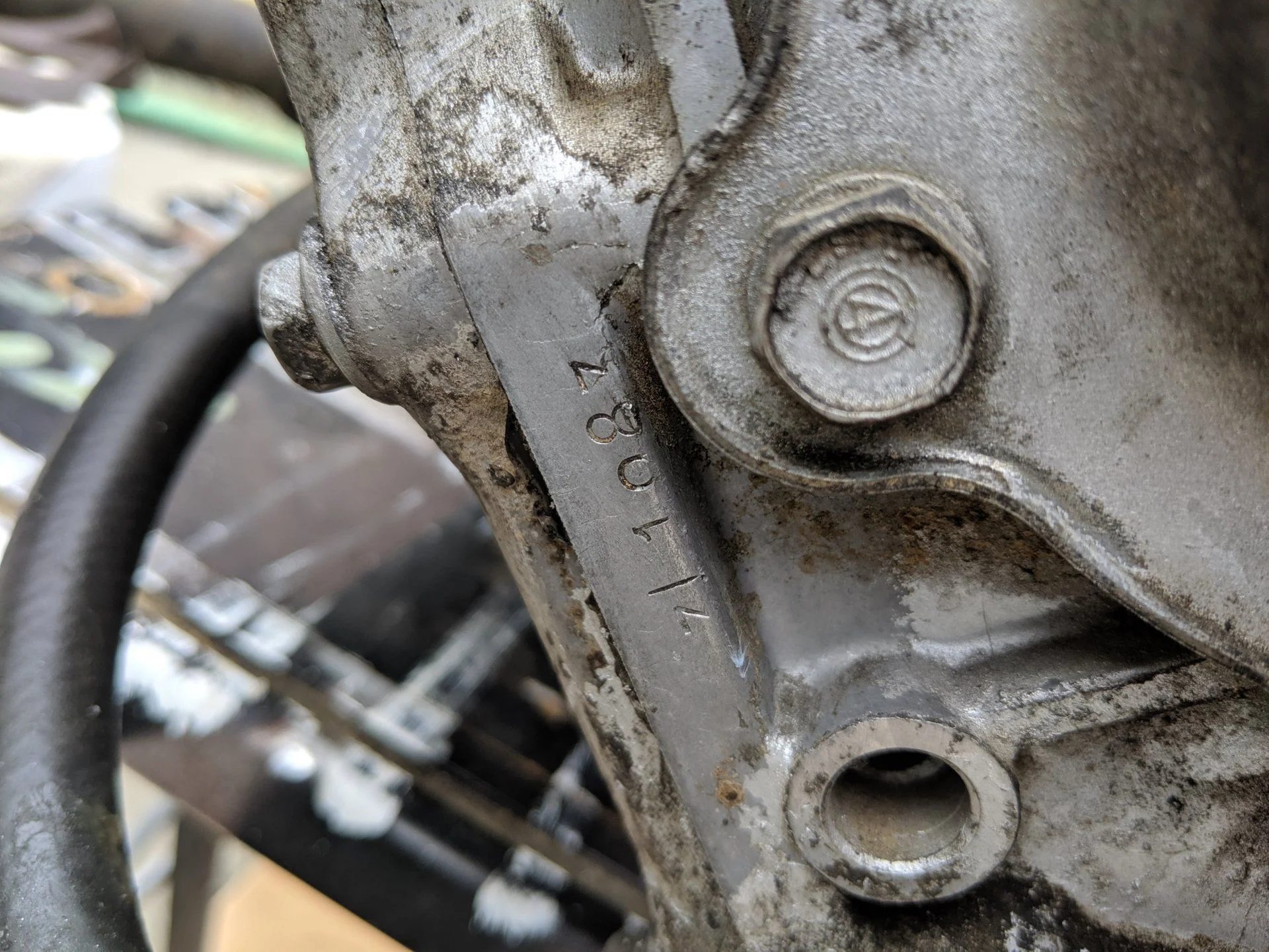

Looks like my idler shaft is 34mm. I attached a photo of the numbers I found on the t case.... Looks like the bottom half of them didn't make it out of the factory. From what I can tell the first number is a 3, followed by an L. My truck is from 12/1983. Should a t case from this year have the 34mm idler?
Can you measure the idler shaft? It sticks out right there in the middle of the back 1/2 of the split case. There is a retainer bolt and tab holding it from turning.
Yep, I measured it and it's 34mm. And yes, I do wheel my cruiser a little bit. The hose seems pretty tucked away, even with the t case sitting horizontal. Jim used quality fittings for his bypass. The hose can be removed with the black nut at the end of the 90 degree bend, the remove the hollow blue bolt for filling/level checks. I started another thread on where to get an h55, gonna try to convince the wife to let me pull the trigger on one before pulling the t case apart to reseal the 4 speed I don't really want. Cross your fingers for me.
So I just got off the phone with Georg at valley hybrids and he confirmed what you've all been trying to tell me: the bypass hose is a bandaid. He even used the work bandaid. Haha. Looks like I might buy an h55 from him, just need to source a t case linkage from an 85-87 60. Thanks for all the replies and for not bashing me too hard for not wanting to give up the bypass hose. I really appreciate it.
