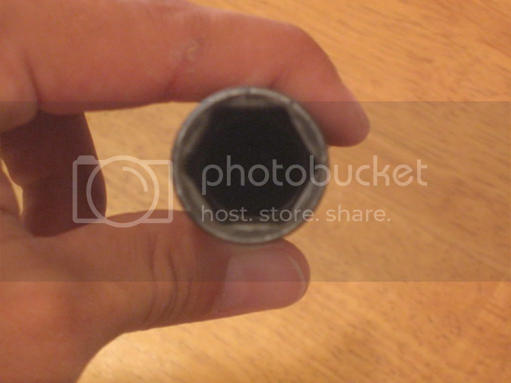

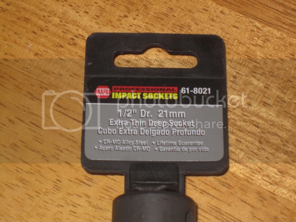

Thought I would provide an update:
I had a number of guys PM me possibilities which I pursued but they didn't pan out. I also tried a spark plug socket, deep socket, and a 12pt cheap socket to no avail. So, instead of making phone calls (I had already made a number of visits), I went into a different NAPA store and the guy there was much more helpful than I had experienced before. He ordered an extra thin wall socket for me that he dug out of the catalog after I had a failed attempt with "just" a thin wall. At any rate, my success was with a 21mm Extra Thin Wall Deep Impact Socket, Part No. 61-8021.
Unfortunately, I do not know the brand of my spacers for everyone's reference and I didn't think to look at them when I had the wheel off. I'll take a look when I pull them off again.
Thanks to everyone for their help and suggestions. Hopefully, this will make it a little more definitive for the next guy trying to get spacers off.
