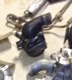

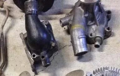

Sarge - Would a unit off an FJ60 work? I have this one that needs a new home. :hillbilly:

In the first photo you see the thermostat housing that came on my '79 motor. In the second picture you see the housing that came on the '83 FJ60 engine now installed in my '79. Has anyone ever used one of these sensor ports ('79) for a water temp sending unit? It would give me a much more accurate reading than at the rear of the head.
