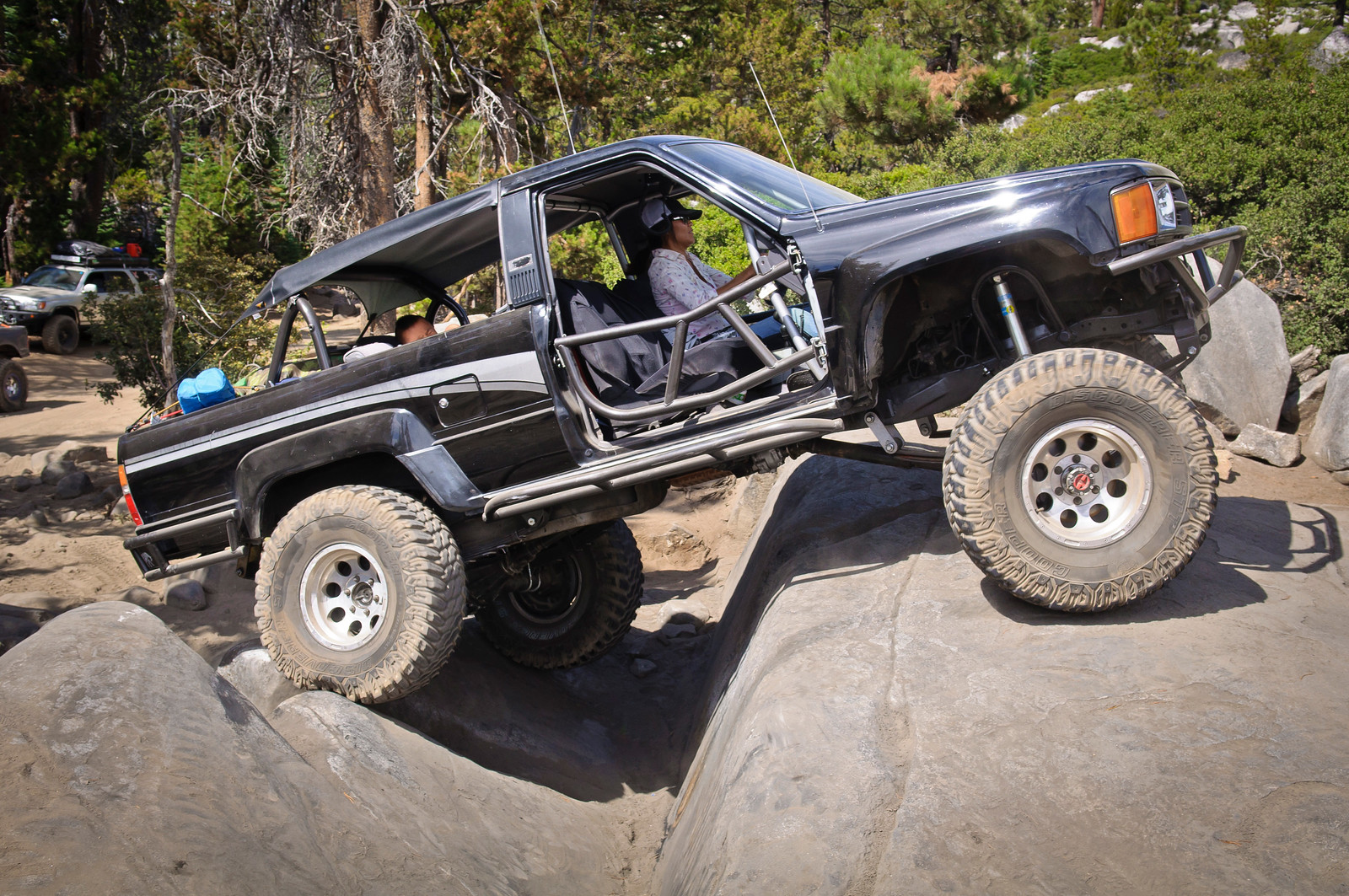

Okay so now that I know this thread exists, can you simply cut off the back half of the roof and add a half roll cage? Or is the entire roof structure compromised requiring a full interior cage/reinforcement? This is what I've always envisioned doing.
I am by no means an expert and have very very limited experience with hardcore/race scenarios.
I would want some type of cross bracing for the roof structure after you chop the back off. Something to resist being pushed over to the left or right and flattened. Also, most 80s, when rolled, tend to smoosh the front of the cab. I always imagine in a bad roll you could draw a line from your forward most structural rollbar to the front of the hood and assume the cab will flatten at LEAST that much.
With mine, I think I will put a pretty substantial rollbar behind me in the b-pillar area and triangulate it back to a bodymount and run it like that for a while. The final product will be an A-pillar cab bar that runs outside the body and down through the front fender. I'm 6'3" so I'm not crazy about having a bar in the cab near my head.
The rollcage idea has changed about 500 times since I started this endeavor.

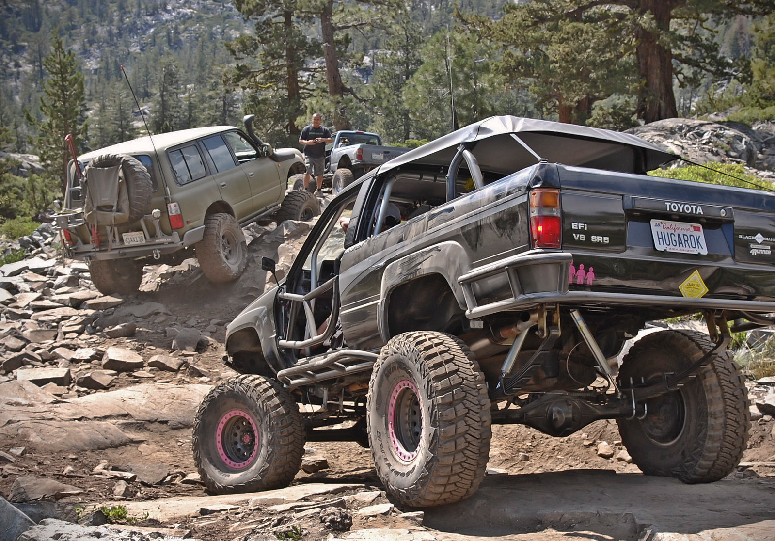

Inspiration I hope? Your post made me remember this truck, yeah, not an LC, still cool. This was last winter, on a trail ride in Uwharrie. He bought the truck after rollover, put the cage on and the tarp over it and looked pretty sharp. I didnt take any other photos but the tube frame was attached to the A pillar.
Yeah I think you're right. An interior cage would probably be essential after removing most of the roof. The more I think about it, the more I think I should just chop like you did. I sure do love them early 4Runners
Yup. Early 4runner is the main inspiration. I think I'll beef up the B-pillar with some plate and tube to act as a "roll bar" and stretch a large bikini over the rear cage and call it a day.
Let me put it this way. Even with my roll cage frame and the big A bracing behind the pass seats that is welded to the frame, and the rear corners are bolted to the tub, close to the frame attachment points (no return to frame) I have had to adjust my tube doors so they would latch. The point is that I have had some twisting or movement. I think that an interior cage is needed and I will likely add A pillar returns the next time I take her under the knife.
Let me put it this way. Even with my roll cage frame and the big A bracing behind the pass seats that is welded to the frame, and the rear corners are bolted to the tub, close to the frame attachment points (no return to frame) I have had to adjust my tube doors so they would latch. The point is that I have had some twisting or movement. I think that an interior cage is needed and I will likely add A pillar returns the next time I take her under the knife. View attachment 1253844 View attachment 1253845
I would not have expected that. even my wrinkly chopped body seems pretty sturdy. I guess hard wheeling/potholes/washboard/and general driving are a little tougher on a vehicle than sitting in a garage though...
I have always heard that the doors add rigidity to the vehicle, so I have assumed that missing those have made some of the issues I have.
