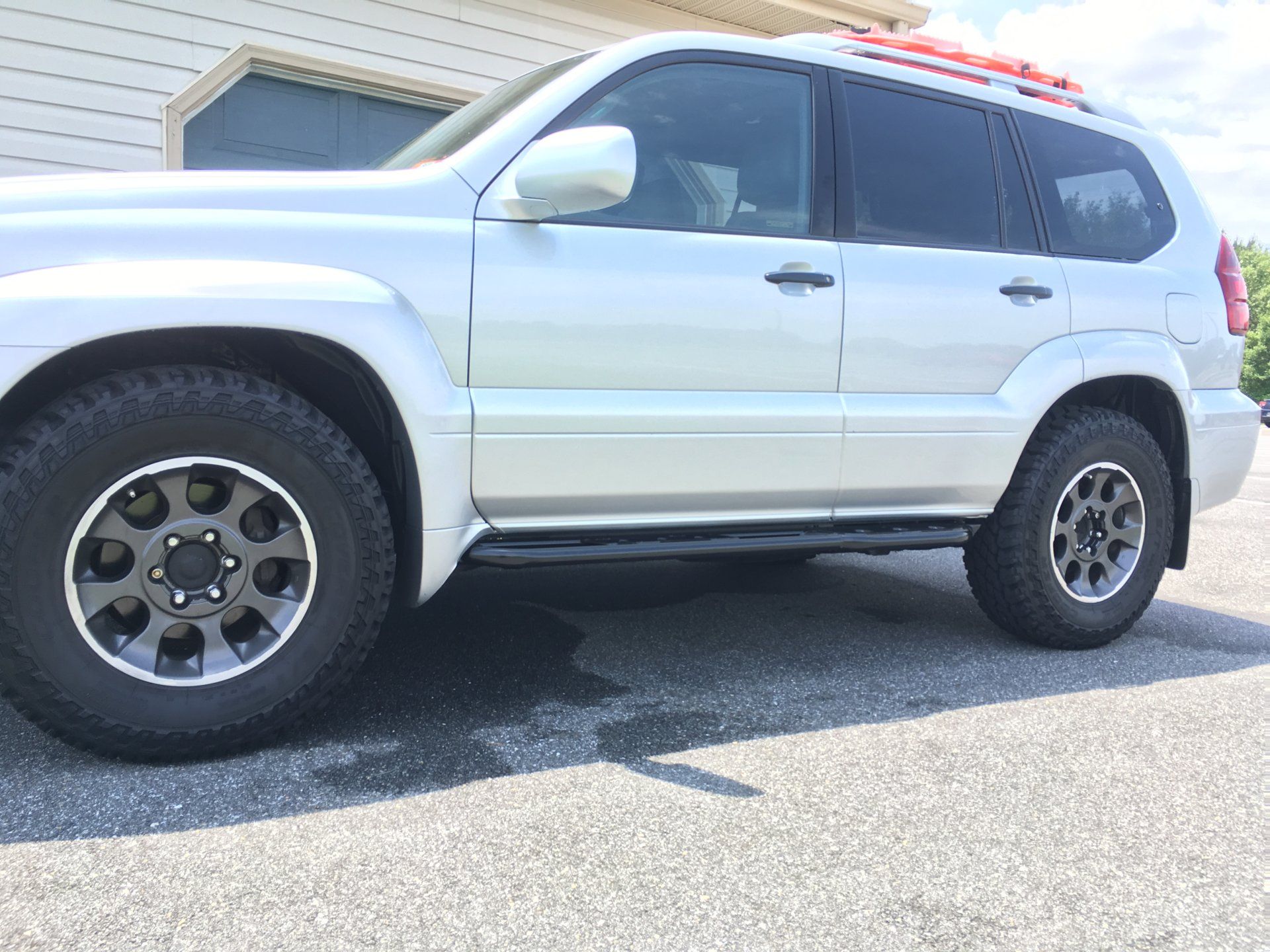

OPOR sliders come in this week. Planning that install in a week or two...

Yeah I’m worried about the install on these sliders...🤦‍♂️

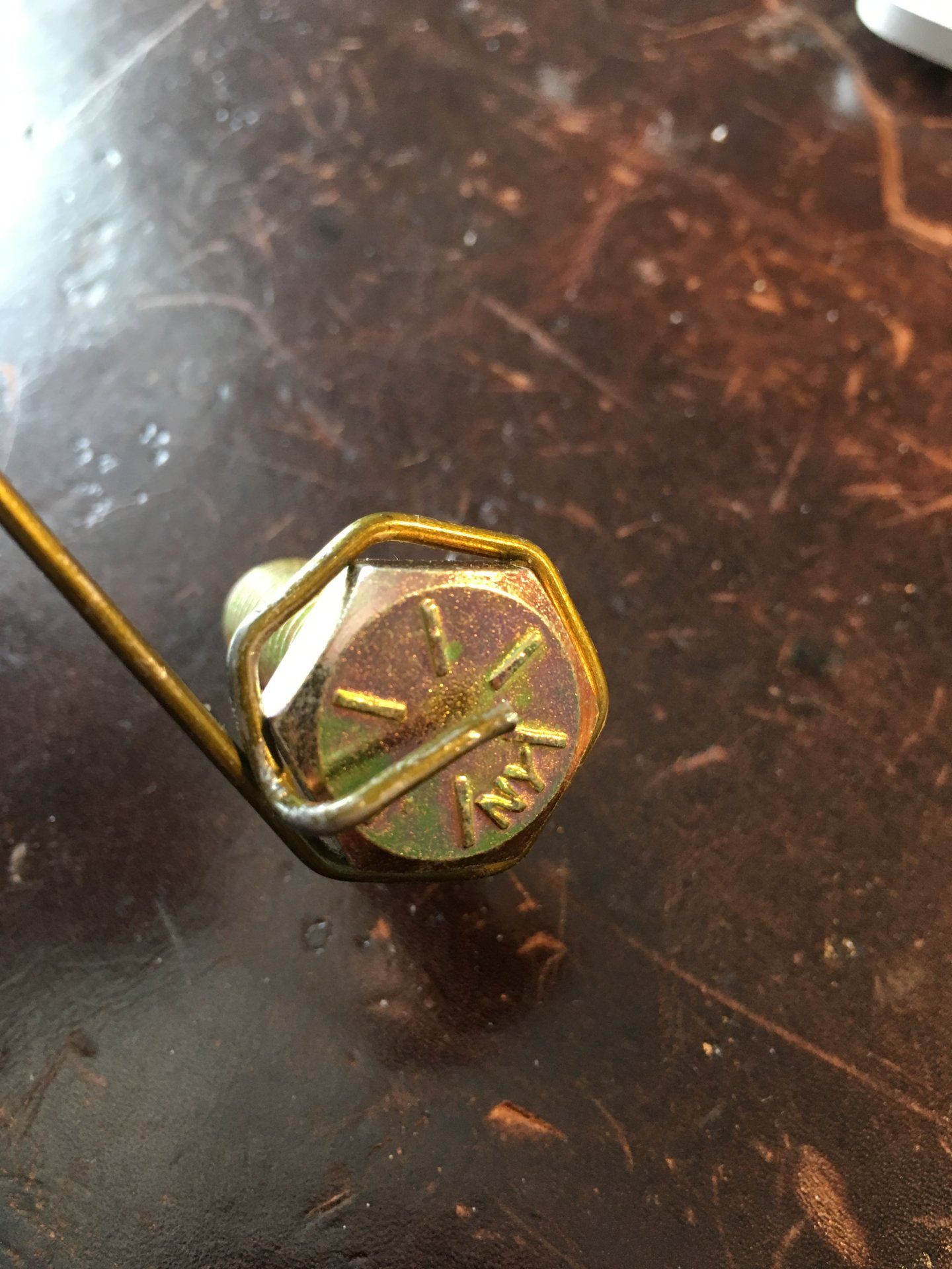

Installing the OPOR sliders... #friendsdontletfriendsuseNUTCERTS! These are a royal pain to install got to say...
So here is my solution for the front leg mount. I went out got a grade 8, 1/2” bolt (since I had already drilled out the lower hole for the nutcert) took coat hanger wire and carefully wrapped end of bolt. Then cut down a 1/2” washer to slip through the access hole.
1. Fish the bolt inside the frame. 2. Once inside carefully slip washer onto bolt. (Both won’t fit through access hole at the same time.) 3. Poke bolt through hole. 4. Mount this bolt to slider first, so that you can easily keep it in place.
So that’s my front leg solution. On the other side I might just use the standard provided bolt instead of the 1/2”. This will be easier to fish in and with the center leg I’m not as worried about the strength as I was the driver side.

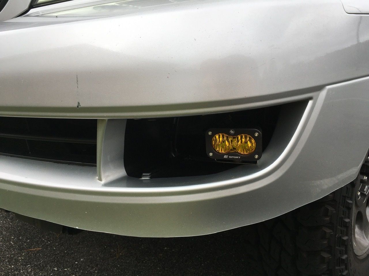

New fog lights finally!
Baja Designs S2 sport wide/fog. Tore out the old lights, sold them on eBay. Then painted the area where the lights had been. Mounted these and wired to the factory switch. Still have space for some spots in the future.
