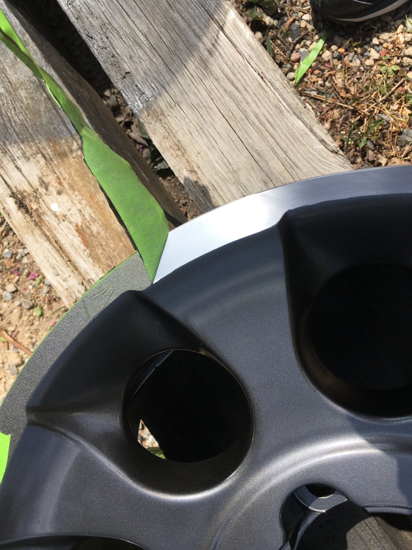

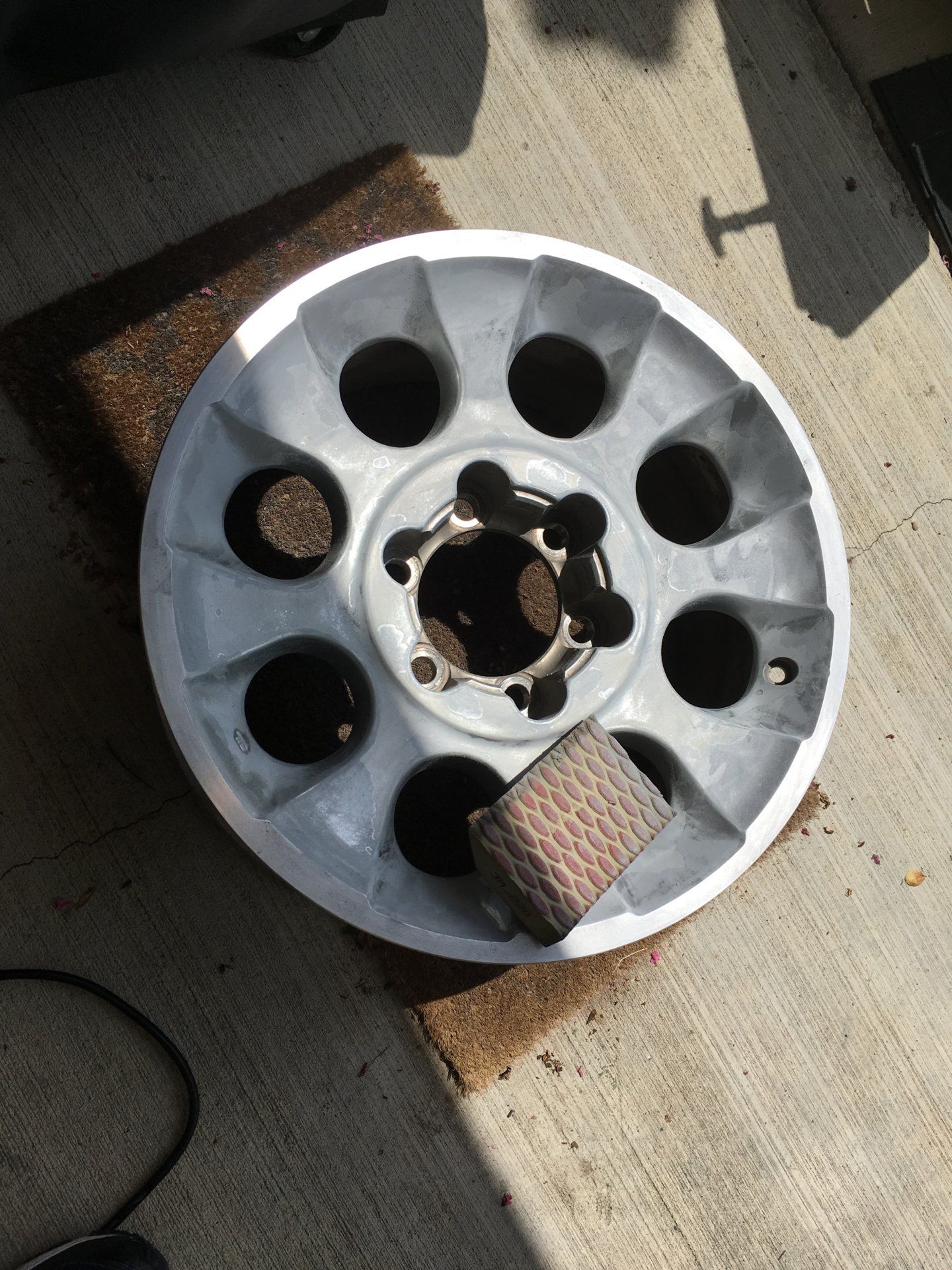

So got my ST Maxx 255/80s and I picked up some 8 hole FJ wheels. Decided on the 8 holes since there are less of them out there and it’s nice to be different. Also these are way more low key than the new TRD offerings. I’m going to paint them. Question is what? I’m leaning toward gunmetal grey.

Preserving the FJ 8 hole wheels brushed rim edge. Figures this will help keep the wheels looking better longer. If I painted all the way to the edge any little chip would really show.

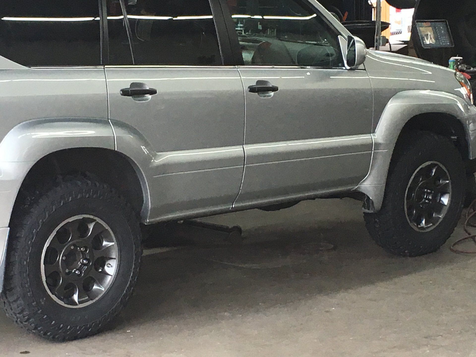

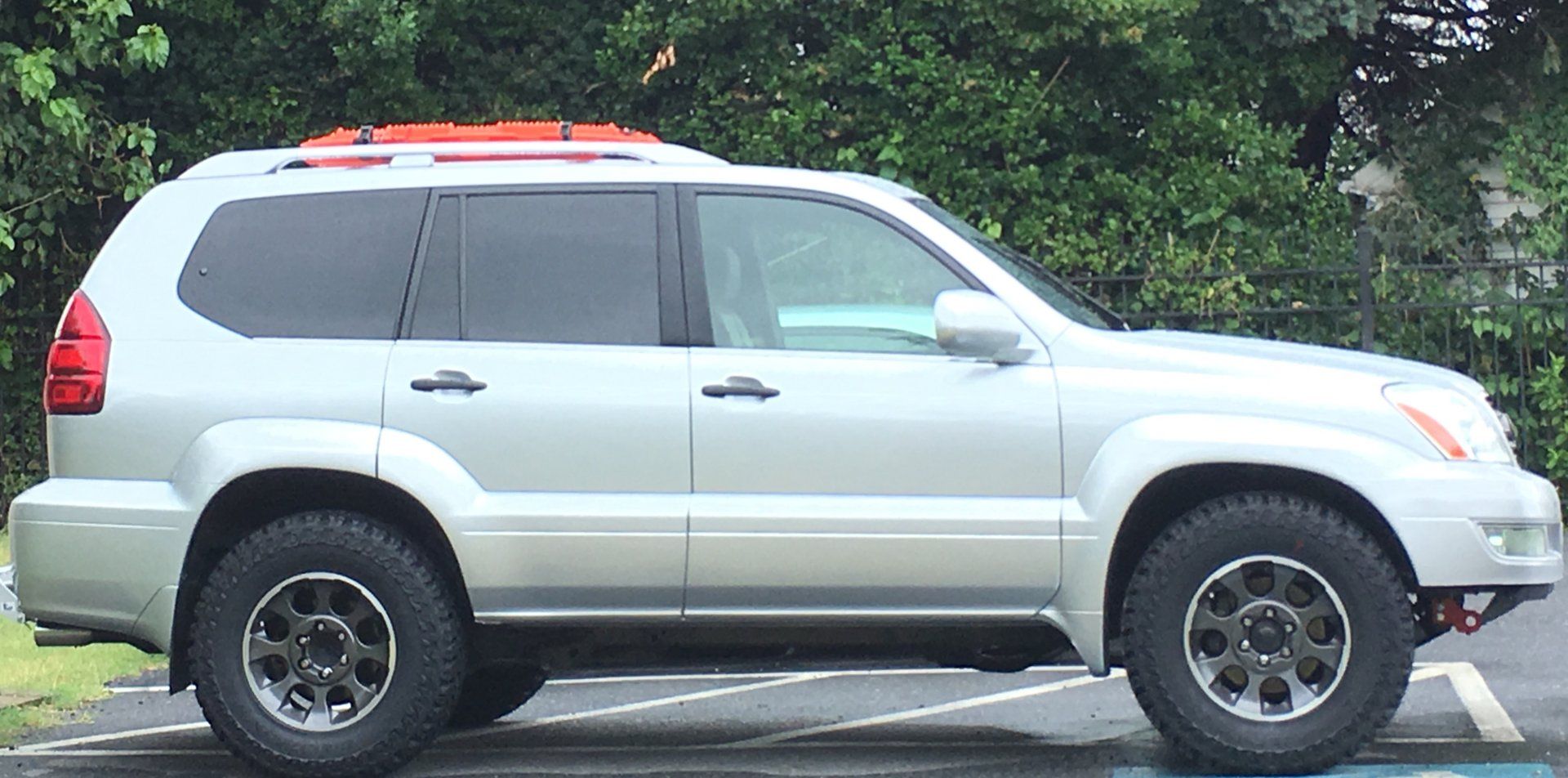

Wheels and tires on...
255/80/17 St Maxx on FJ 8 hole wheels. Painted. No lift. Front bumper trimmed no other rubbing.
Those wheels look great! I'm between those, Trails, or Pro's with that tire size or 75. Just trying to make decisions. Haha
I went through all the same options. I liked the rarity and low key look of the 8 holes. Personally I think the 80 series tired are worth it over the 75. Extra inch is great and fits easily.
