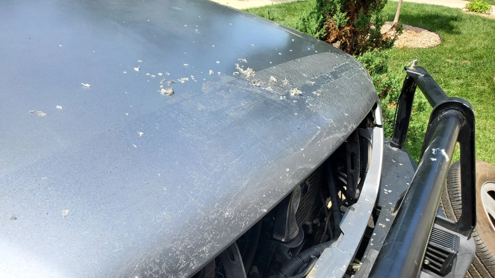

Speaking of which, removing the dried and cracked up clear bra is a miserable job. Soak it in GooGone, scrape it with plastic scraper, invent new swear words, and repeat.

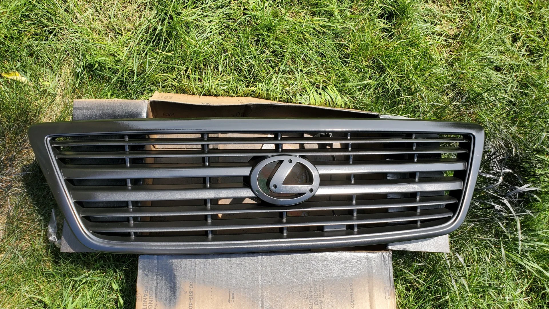

Half way through the job, I decided to reward myself with a fun little painting project.

Wonder what kind of cheap Chinese film is on that poor Lexus. Even the 40 year old crap Porsche used on their cars at the factory came off easier than that.
Lexus dealer installed and then cooked mercilessly for 20 years in the SoCal sun.

Meanwhile, I was able to scrape off the clear bra and am happy to report she is all natural and perky underneath :cool:
Also, put the freshly painted grill back on.

Larry at AmmoNYC uses a hot water method to remove clear bra. It seems much more effective to soften the glue with hot water than to melt the glue and film together with heat. Check out his videos for all things detail related.

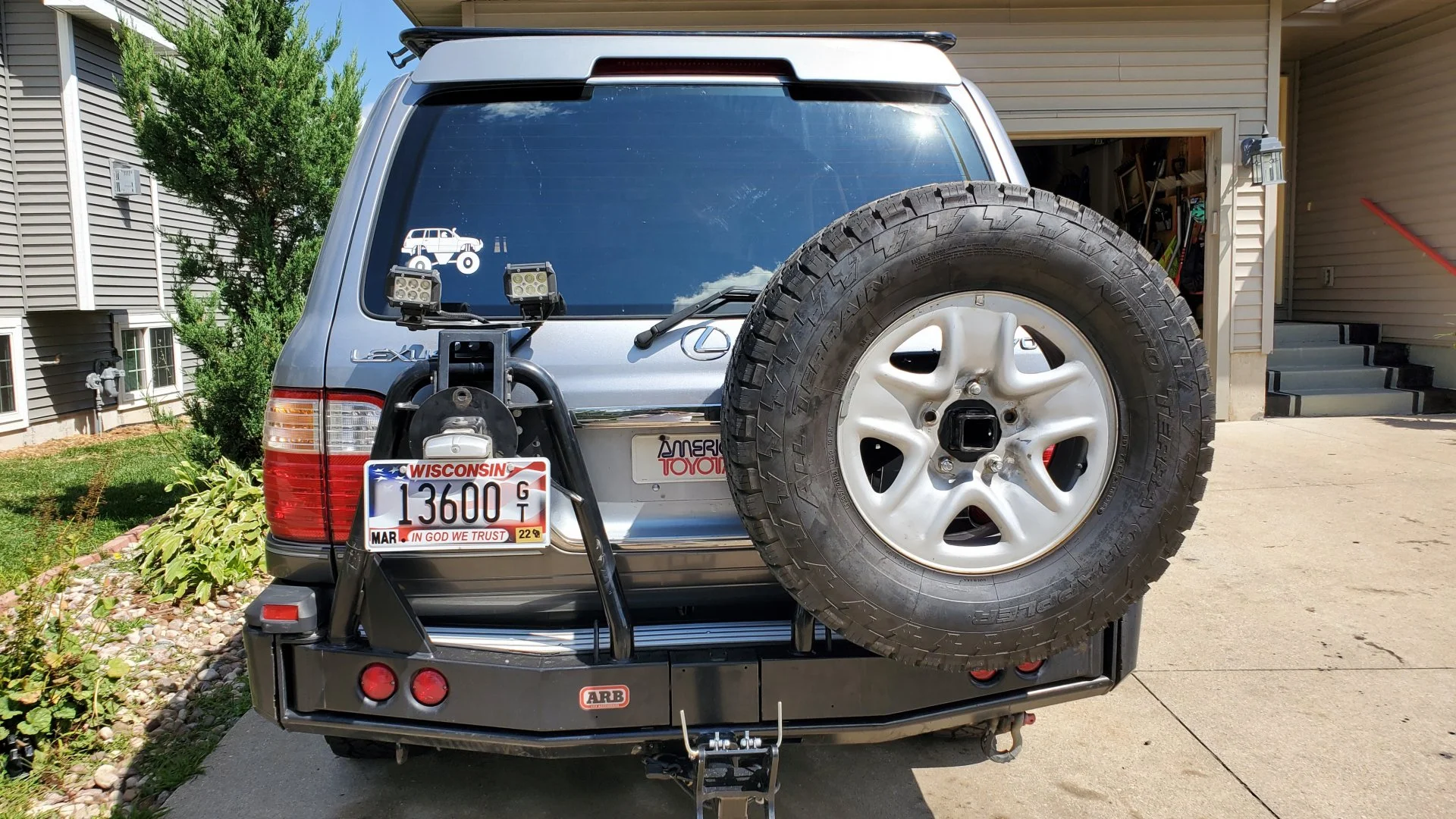

What do you do with a truck you can't really drive but still can't stop tinkering with it?
You take off all the wheels and confirm that all the wheel spacers are still torqued to 100 lb ft.
Then you move the spare from left swing out to the right.

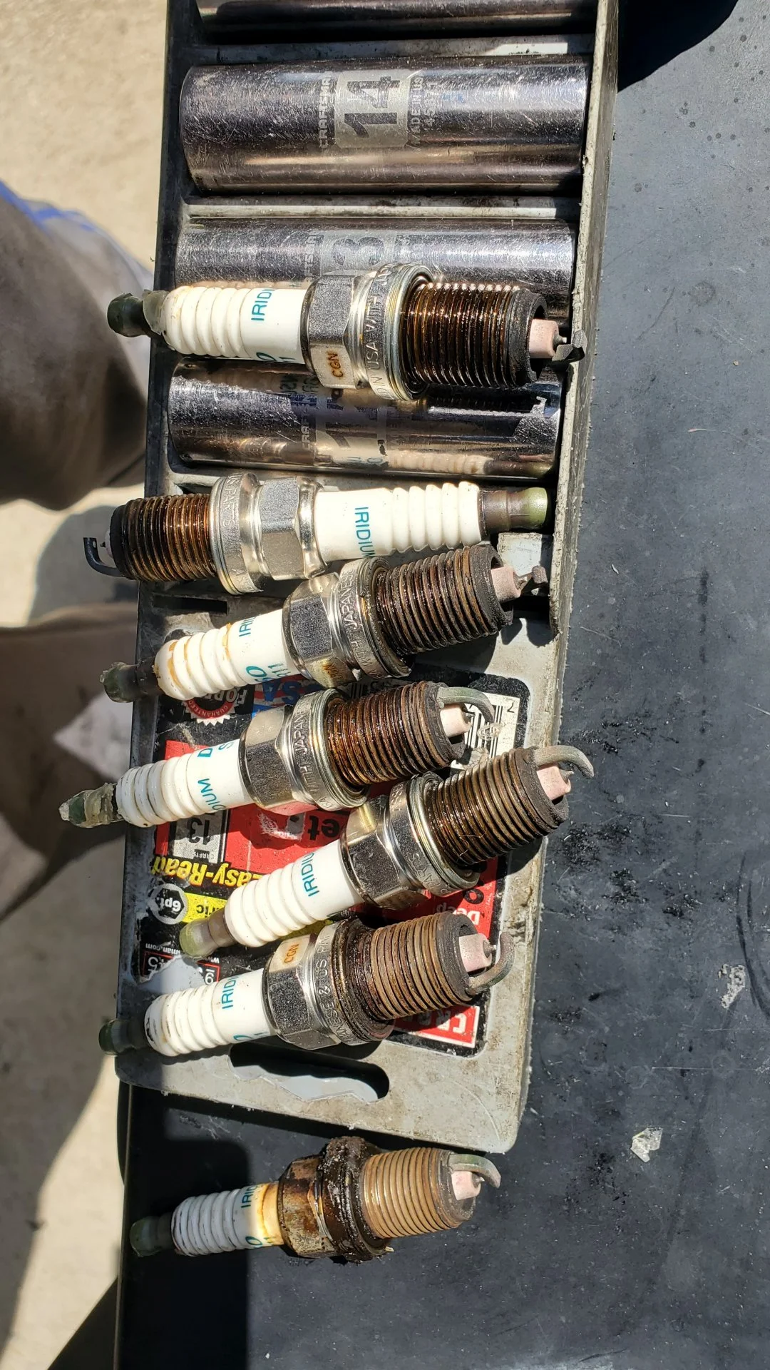

Replaced all 8 spark plugs with new Denso ones. Old plugs all came out easily and had no indication of burning oil and running rich.

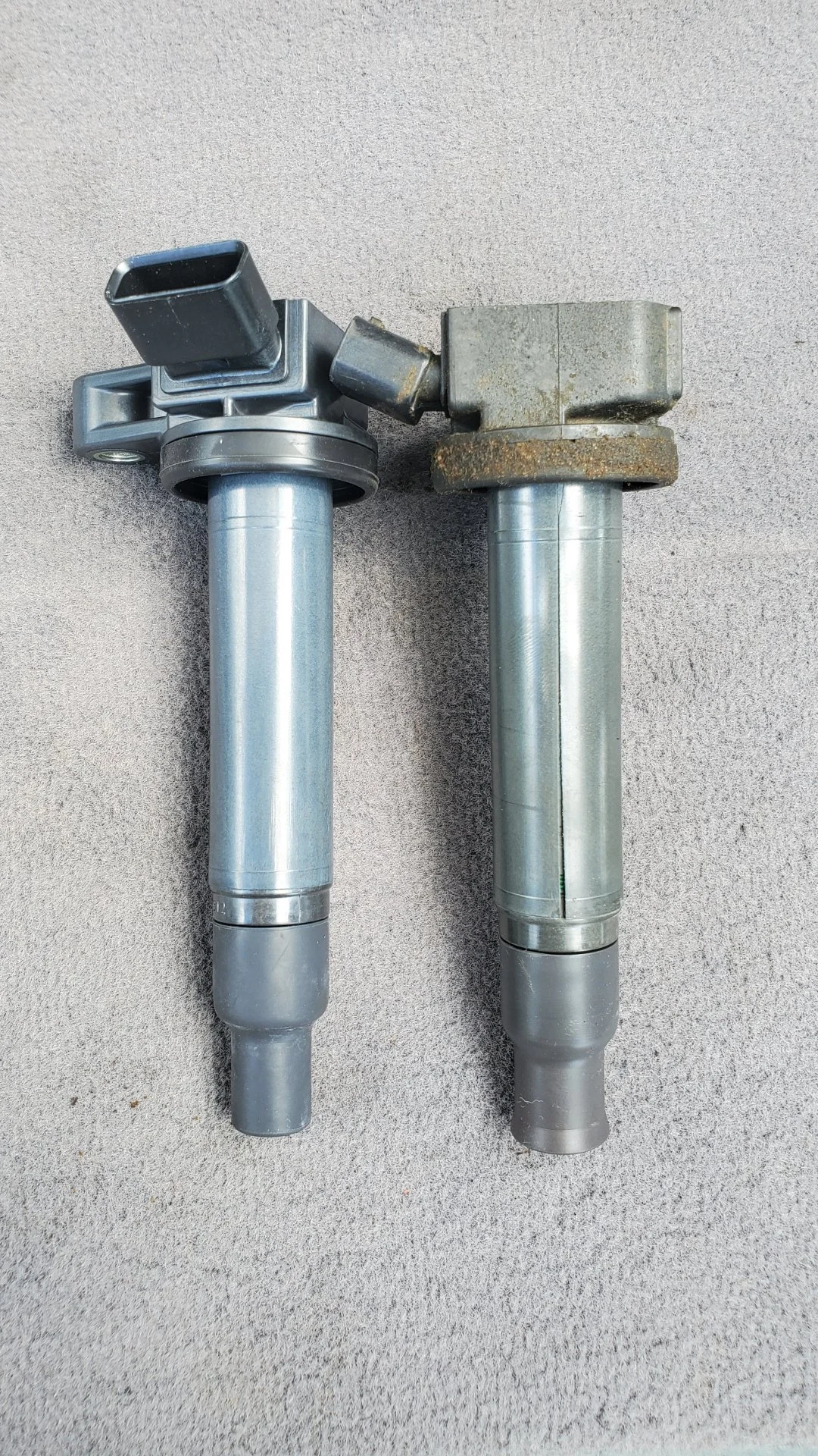

Also, found 2 of the coils had cracks in them so replaced them with new Denso coils as well. She continues to purr like a kitten and hop like a damned kangaroo!
