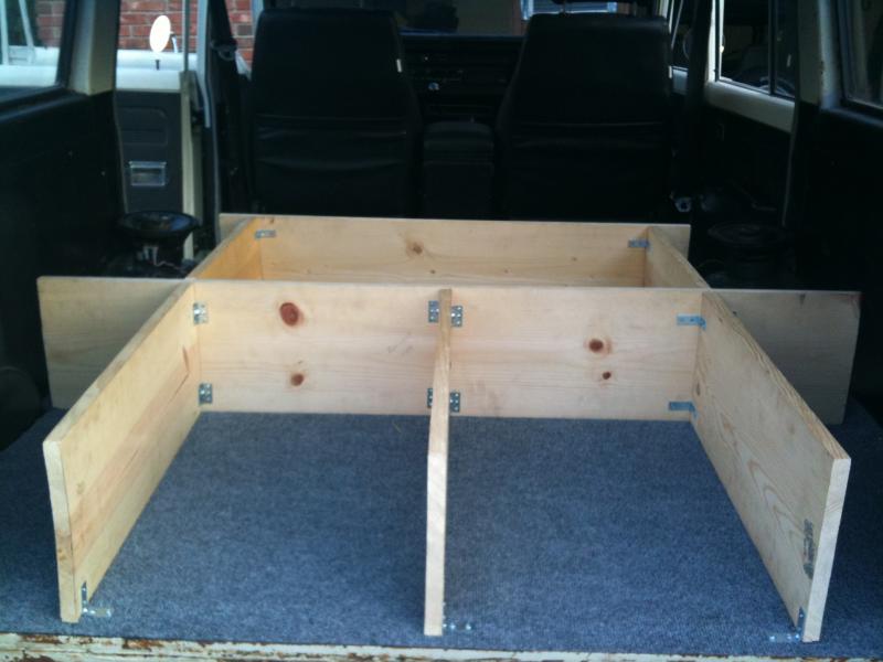

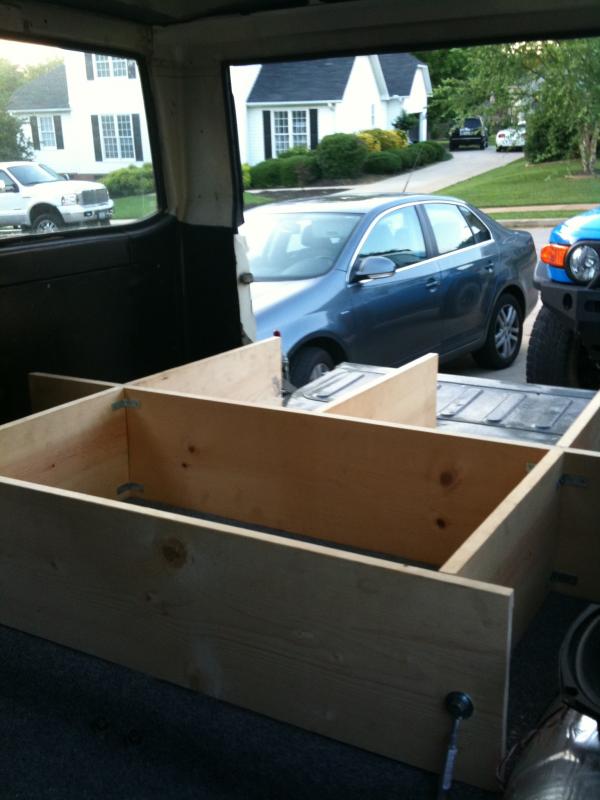

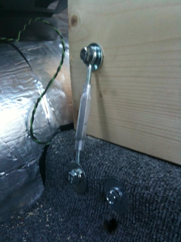

I fabbed the lower structure of my sleeping platform. It went together pretty easy. I used 1x10 shelving (lightweight) and tied everything together with a ton of corner braces - then tied the rear of the platform to the bed with metal screws, and the front with whatever those things are called (see pics) which allowed me to not drill anymore holes into the bed. I did leave enough room on the sides so I could fold up the sides (on hinges) and get to the quarter panels if needed.
The platform so far is VERY sturdy. The :princess: saw it and was impressed - she said "you are actually measuring!" :o :bang:
Platform from front
Platform from back
Corner braces

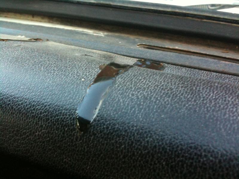

Worked on the dash a bit too. I was thinking about installing a dash cover at some point down the road and knew I would need to prep the current dash by cutting down the current cracks and filling them. I found some weatherstrip adhesive sitting around and used that to fill the cracks after I trimmed them down with a razor blade. It might turn out OK - and should be good enough to skip the dash pad for awhile. The weatherstrip adhesive dries different than it looks wet (is wet in the pic). It seems to shrink and I'll have to go back and add another layer.
