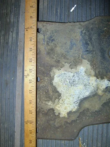

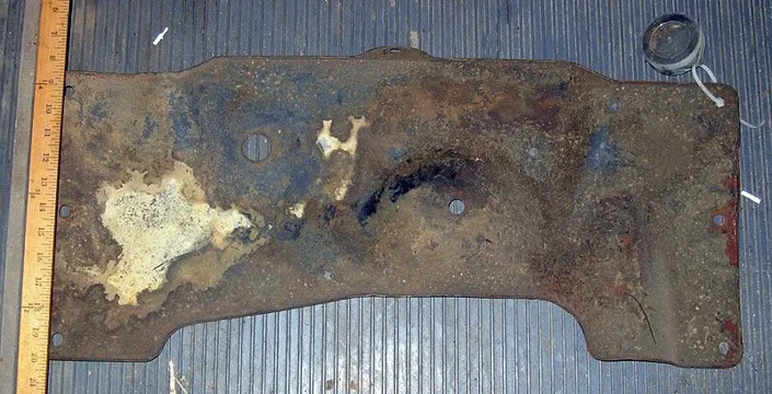

Did the pic Yooper posted up look like the splash plate? Any armor is good armor...heck, the Piggie isn't a flyweight!
Here's a couple better pics finally. It takes 7 bolts, of which I saved three for some reason. One of the bolts goes in horizontally, I think to the front crossmember. It's not super heavy duty but it would protect the radiator from a rock for sure. If it looks like it will fit say the word and I'll ship it.
I'll take it! Let me know what I owe you.
