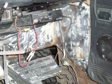

I hoped to get some work done yesterday but the rain kept me from getting much done. The inside is not totally cleaned out yet but here are a few pics to give you an idea of my progress. The pics are pretty bad. I had to take them inside my garage b/c of the rain.
A few more pics. Before I POR the interior and as much of everything else I can reach I am going to remove the CB, rear heater, and weather stripping. I am going to POR and Durabank pretty much everywhere I've ground paint off - all the way up to the bottom of the windows.
