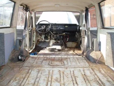

So I feel bad about not giving any text...here is a little...
I spent about 10 hours this weekend cutting out rust so I can weld in new metal, install bucket seats, and lay down a bedliner. I didn't get as far as I wanted to but I am pretty happy with my work. Some areas look better than I expected and some worse but nothing I can't deal with.
Pic 1) Shot of the inside at beginning of work this weekend. At the end of the weekend I pulled out the rear wood panels, speaker boxes, speaker wire, wheel well covers but didn't get to the heater. It will come out soon.

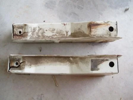

Pic 1) front bench mounts after being cut out. Both were cracked in the rear but that's OK as I won't need them again.

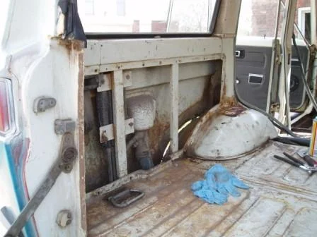

Pic 2) Rear quarter inside w/ wood panel removed and rear wheel well cover - some rust at wheel well...still to be fixed.

What are these? Nasty cracks.
Yup, under rear seat. It wasn't too bad. I cut out all the rust and will weld in some new metal. The only place that I am still figuring out how to fix is between the rear passenger's door and the bed hump.
Those cracks are on the old front bench mounts that I cut out. No worries though as I don't need them for anything.
