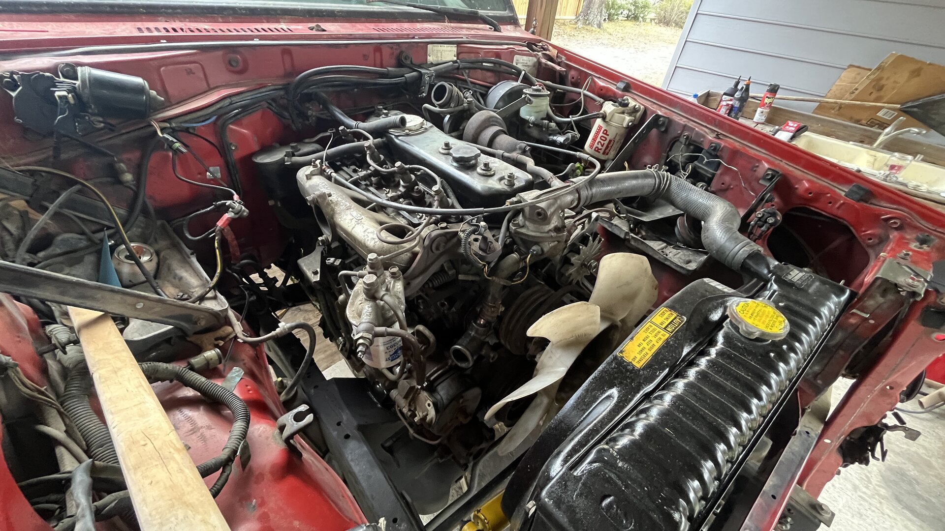

progress! the engine has been in and out of the troopy at least 20 times now... motor mounts have started to have been welded in. Will try to get everything solidified tomorrow as these are just tacks.

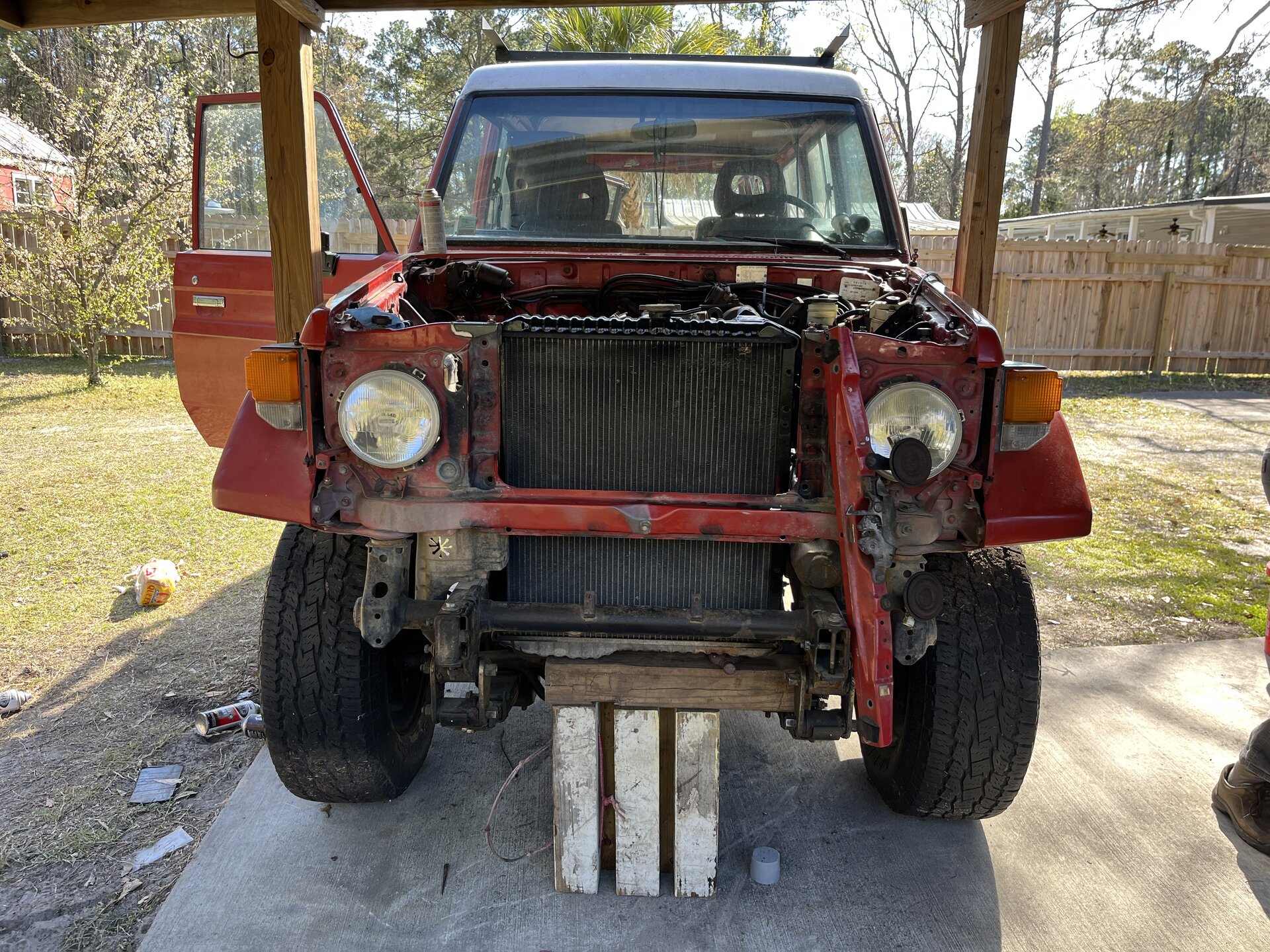

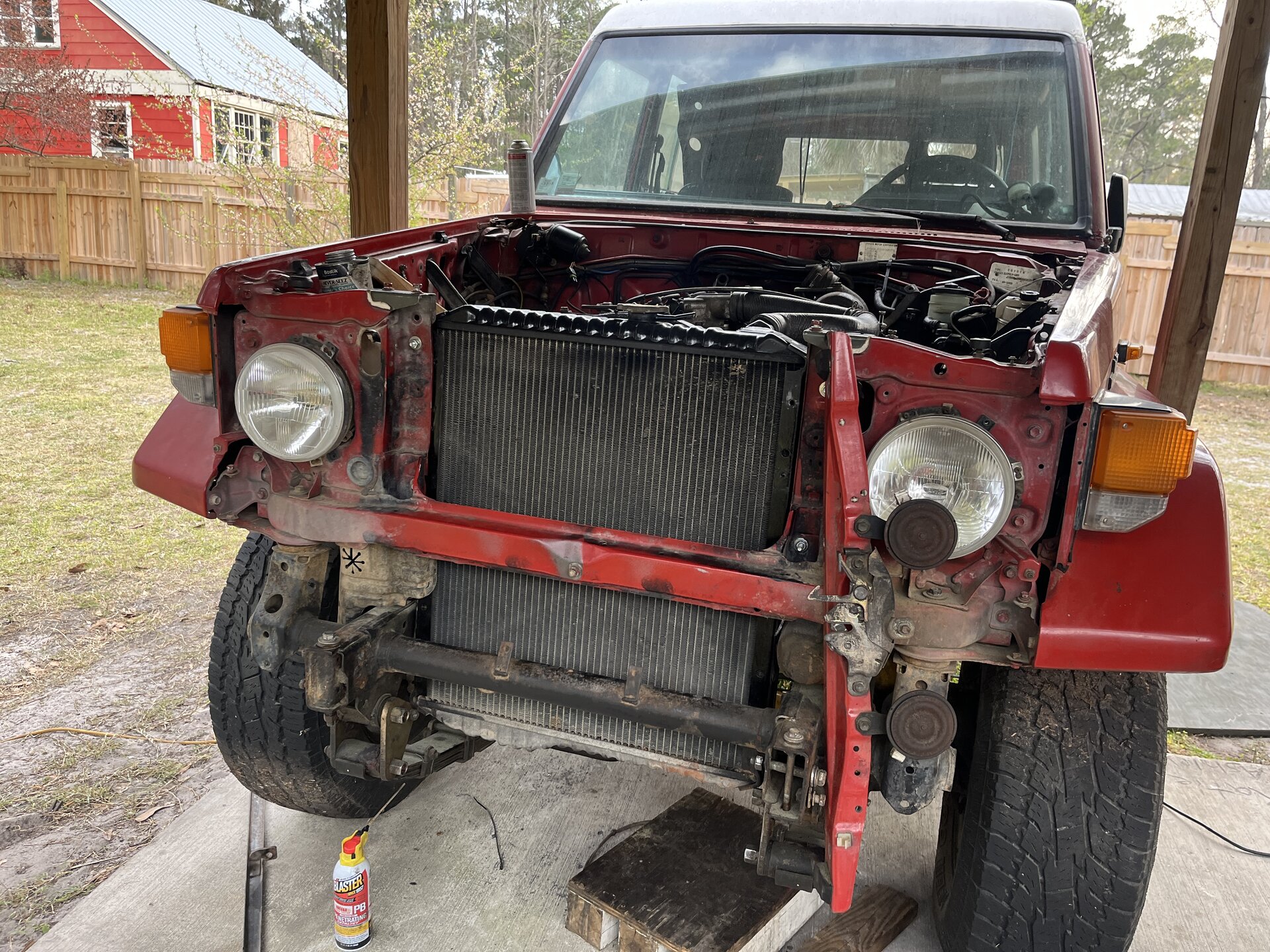

The radiator from the box truck, after grinding off most all the old existing mounts it had, fits literally PERFECTLY inside the 2 frame rails of the troopy. It's taller than the stock 3B one so I'll have to make some sort of skid plate to protect the bottom of it. It is old but only has 89,000 miles on it just like the rest of it. I would prefer to keep as much of this old Japanese steel vs the new Chinese stuff. Plus its cheaper, now I don't have to buy a $250 ebay radiator!
obviously taller much taller...
this photo doesn't show it perfectly but it fits in just right between the 2 body panels and frame rails

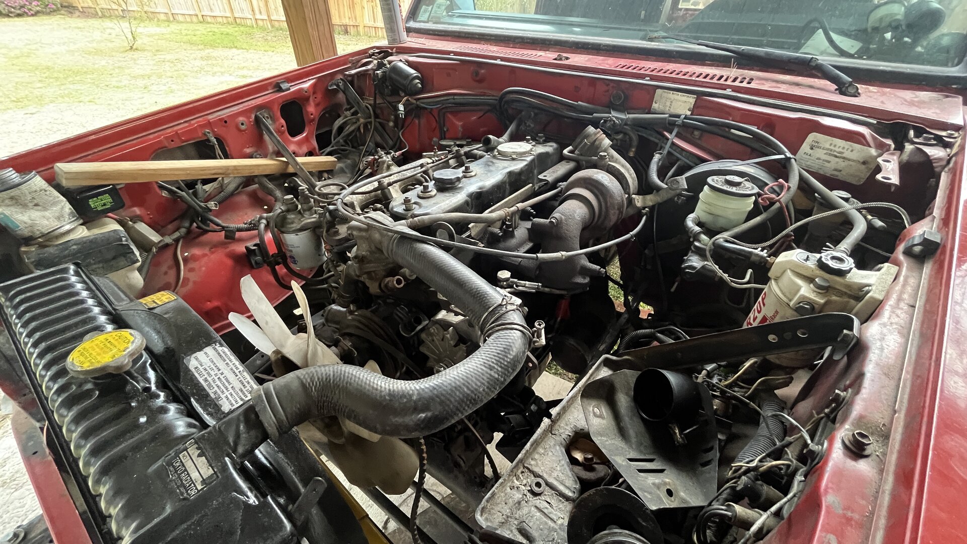

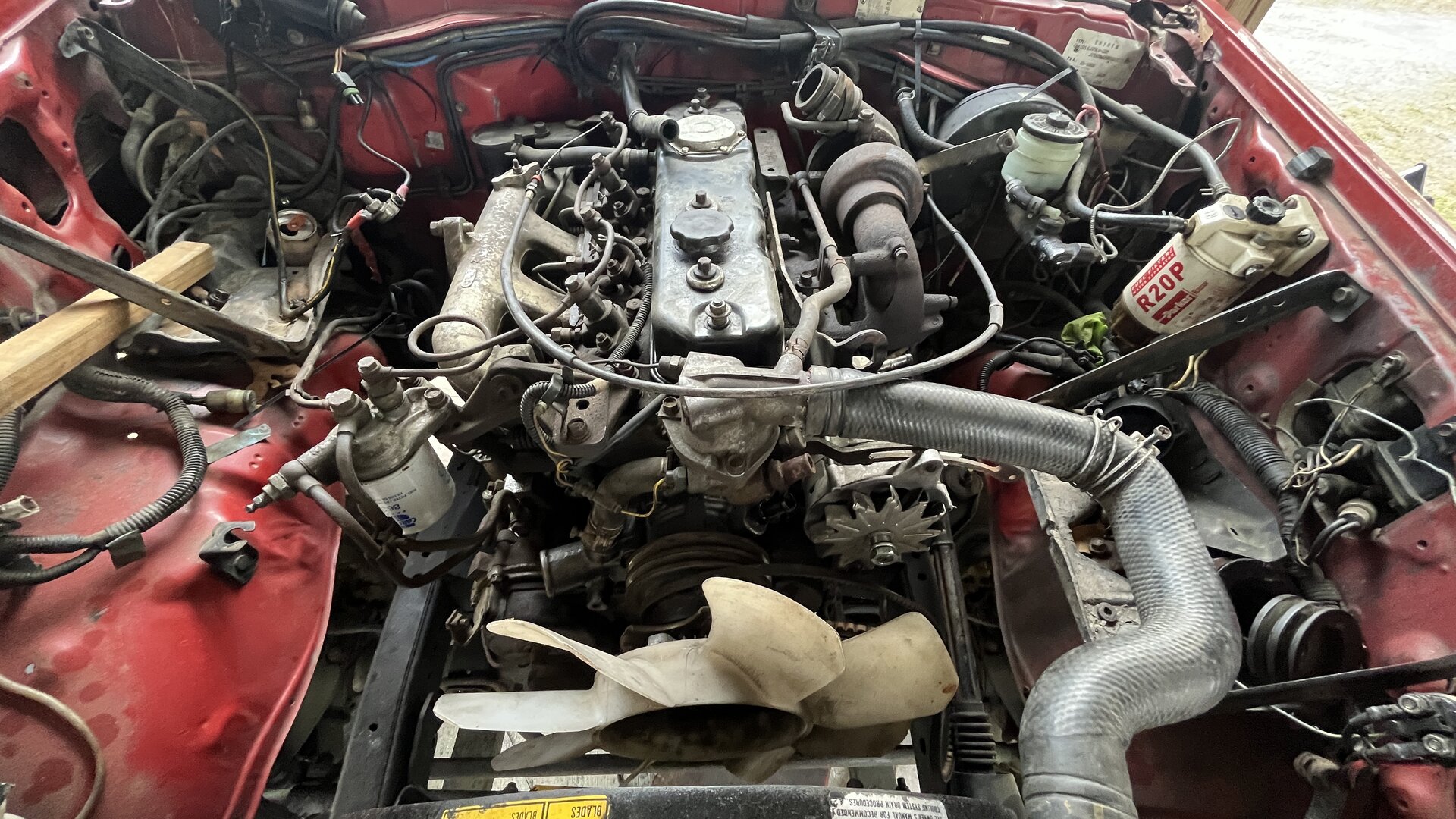

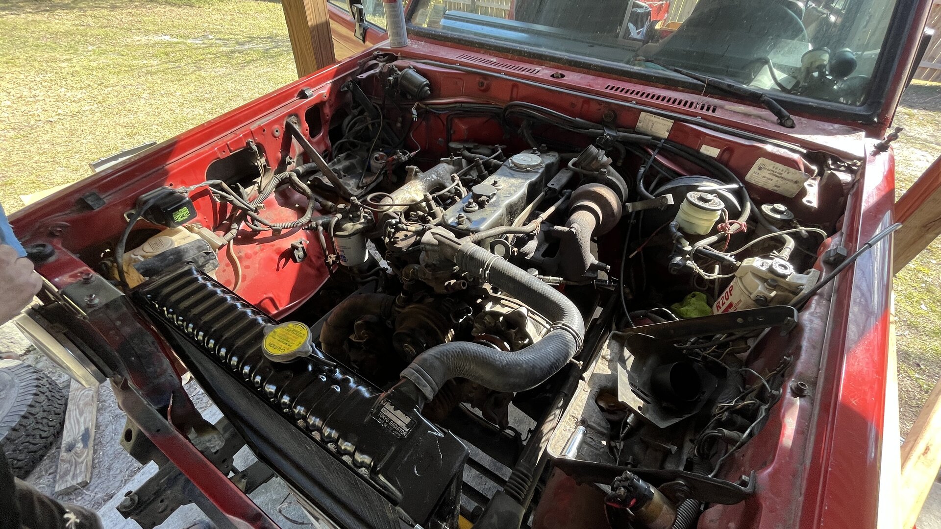

The 4BD1T is in! sits in there perfectly fine, mounts are solid and painted. Everything lines up great for all things considered.
Tallllll radiator. I'm pretty glad its so big, my endless nightmare of cooling the 3B using the windshield wiper squirter will hopefully be resolved. Will need to fab up a skid plate of some kind later down the road.

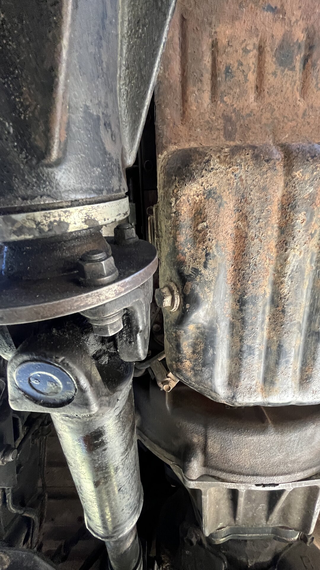

The oil pan almost clears... there are only 2 fingers worth of room between the drain plug and the joint but from straight up and down they are about parallel. Video below shows more of a 3D view.

Maybe an allen head plug for the oil pan drain plug, similar to the ones used in the diffs for a lower profile?
That all looks awesome. I'm guessing you don't plan on jumping your troopy at high speed. You can probably put a jack under the front spring and jack it way up and see how close it comes to the pan. If it hits the pan it will probably squeak and make noise. If it doesn't hit it too fast it might just dent the pan in and precisely "self clearance". If you know it won't interfere with your pickup tube or anything (drop the pan and check) you could probaby get 1/2" with a ball peen hammer. I carry epoxy putty in my "off road repair kit" You might consider that too if you don't already have it for the radiator and oil pan.

I'd second Robmobile to jack the thing up, flex the axle and check for clearance. If needed, you may dent the oil pan with a ball hammer, as Rob suggests. But make sure the pan is back on the block, so it won't twist.

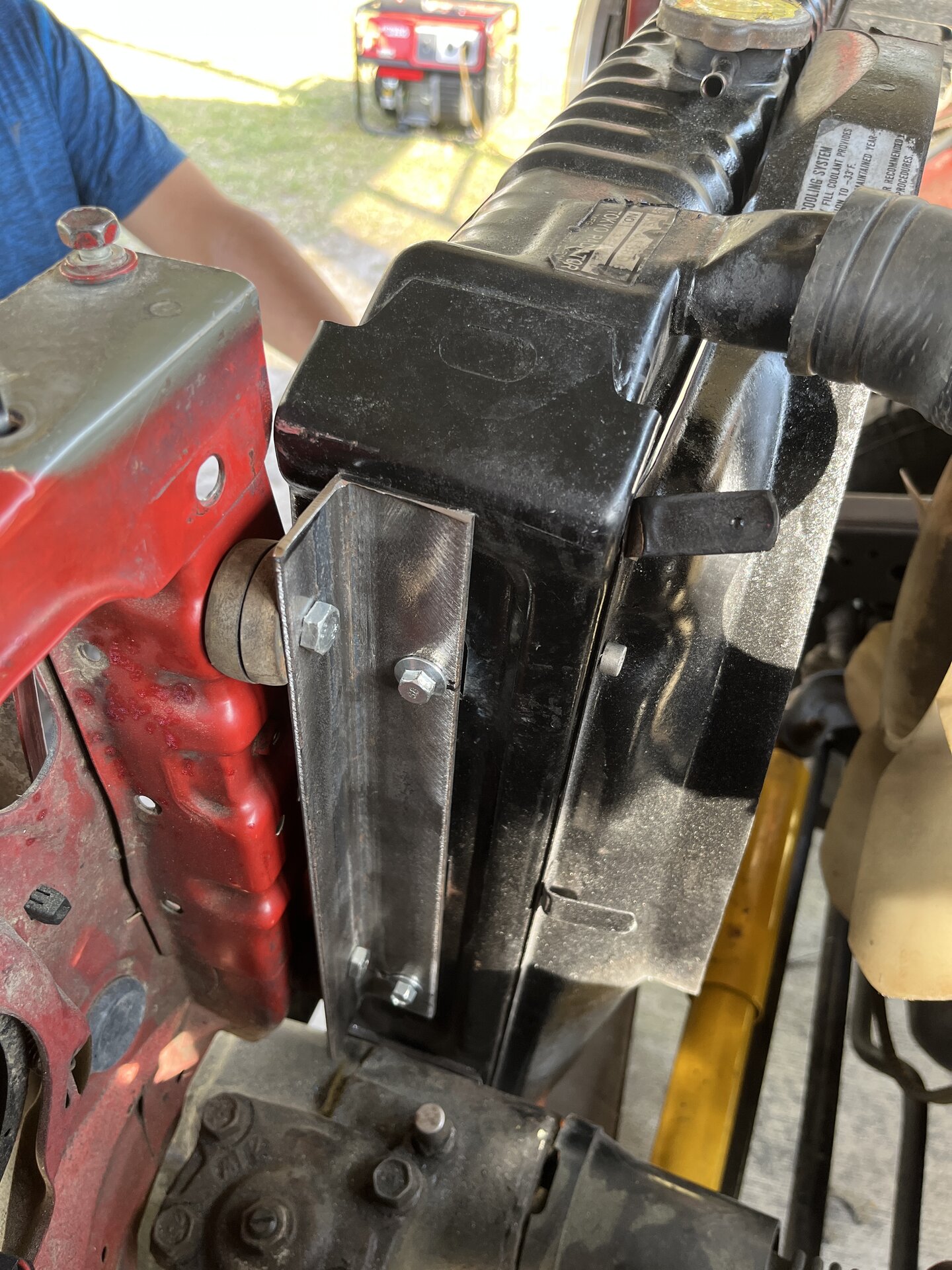

The radiator is mounted! Kinda, it needs some provisions and is actually so long that it runs into the anti-inversion part of my leaf spring shackle on the passenger side, will just make the rubber spacers about an inch longer as well as the bolts so it won't contact the shackles even if i hit a bump SUPER hard.
Well... that's it. This is how its gonna look, all of the major stuff is pretty much out of the way.
Genius! Thanks for the smart idea. Will figure out the thread pitch and size whenever I do my first oil change and put an allen in.
