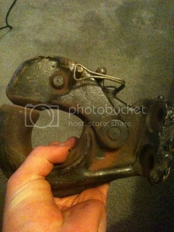

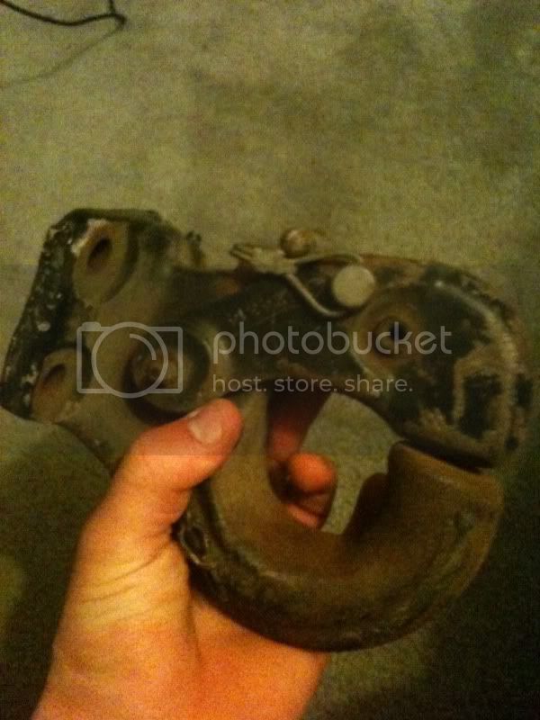

Here's a couple of photos of a crusty old military surplus pintle hitch with the chain plate.
I bet that thing has pulled some cool stuff! Looks authentic. :smokin:
