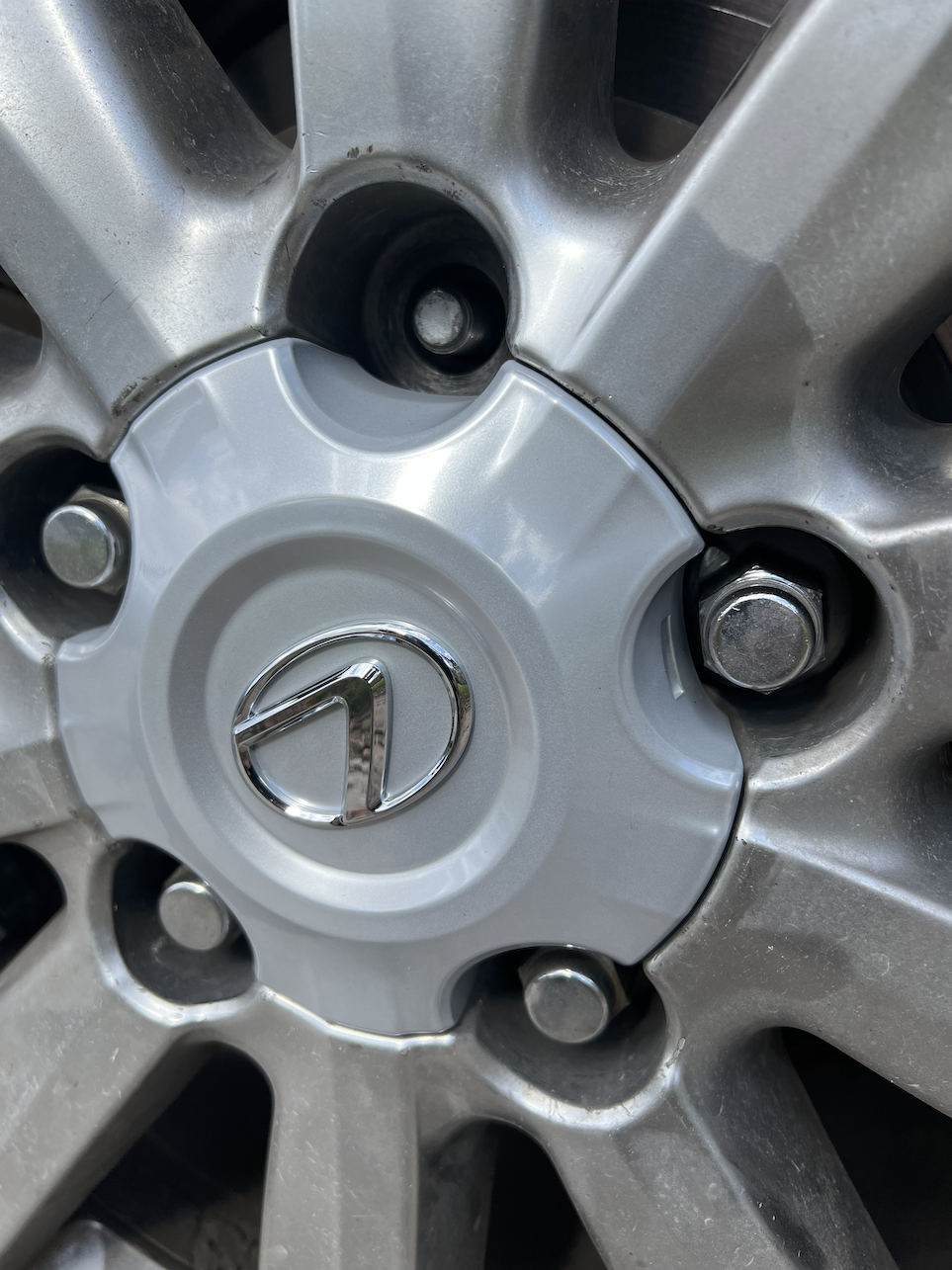

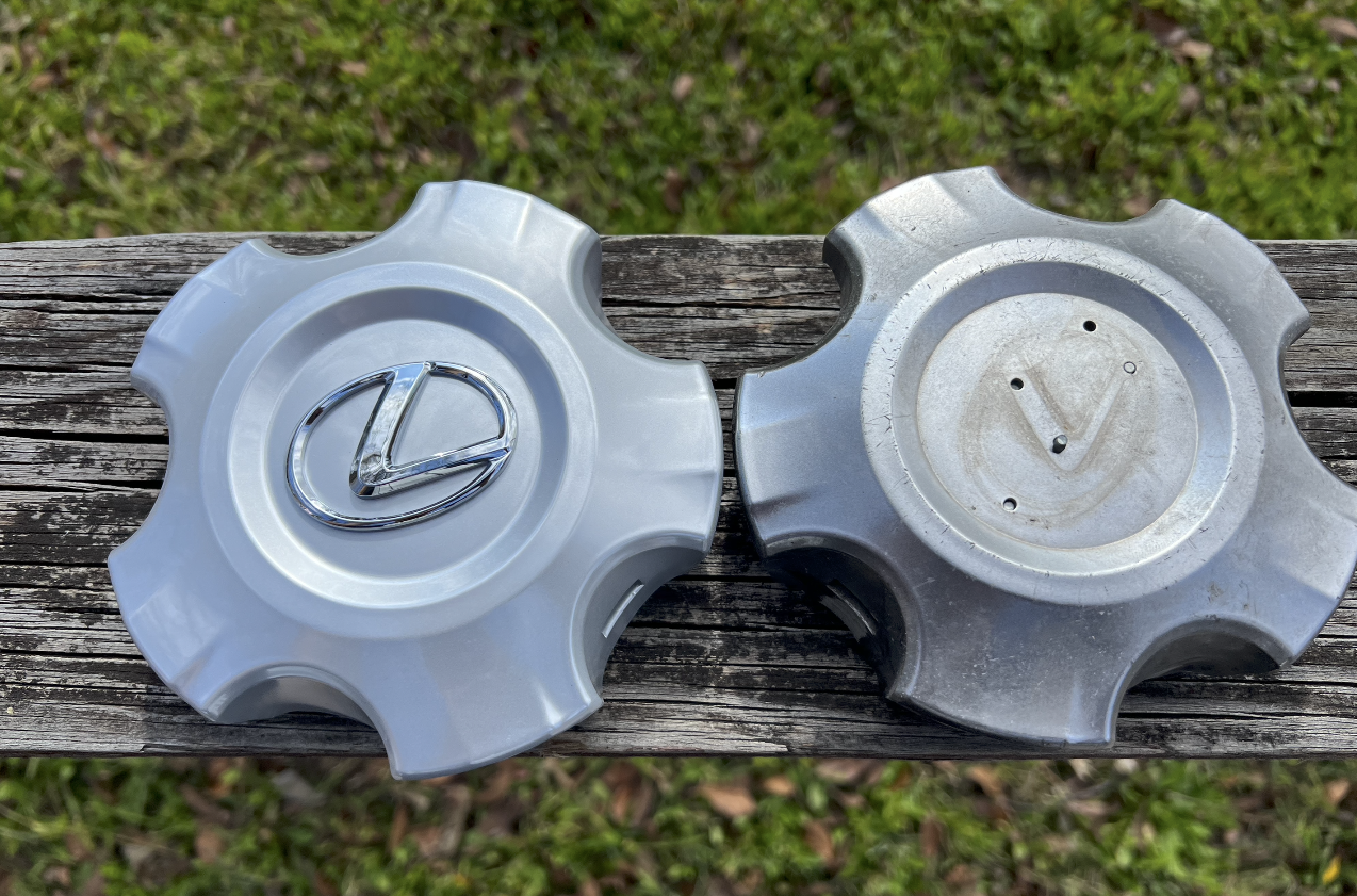

I need to replace two damaged center caps for stock LX 20" wheels from my old 2009 LX.
I recently ordered Part # 4260B-60080 from Impex, but the color is off. It's more gray and less silver.

I don’t know much about impex.. is their stuff supposed to be Genuine Toyota?
Your part number comes up as E in the following diagram
They list a silver and a "chrome" option, yours being 60080, the chrome being 60060.. I think that's the one you need from doing some image searching online.
C is 60050 and looks significantly different online.

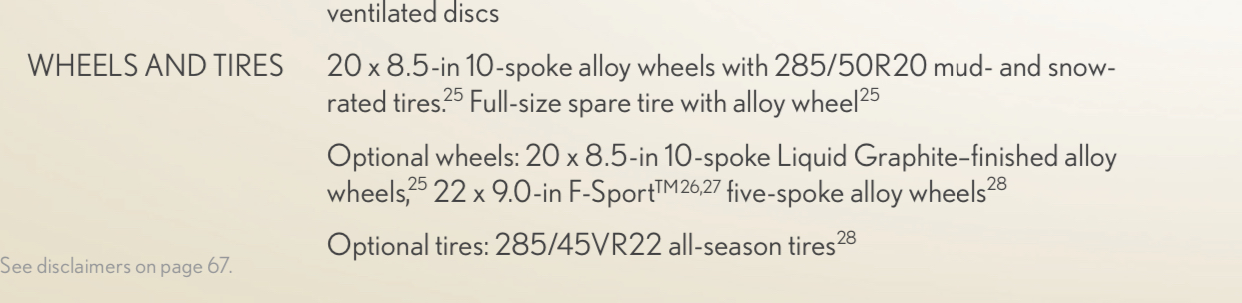

Im fairly certain that part comes in at least two silvery colors, as the premium package LXs came with a darker tinted wheel. Whereas the standard LXs had a lighter color. Seems like I’ve possible seen a chrome one as well. But maybe the chrome referenced part above is the darker version?
Edit: they called it “liquid graphite”
It’s possible that’s marketing speak and the parts system uses different terminology. But yeah, there were a few options and this is a risky one to order online.

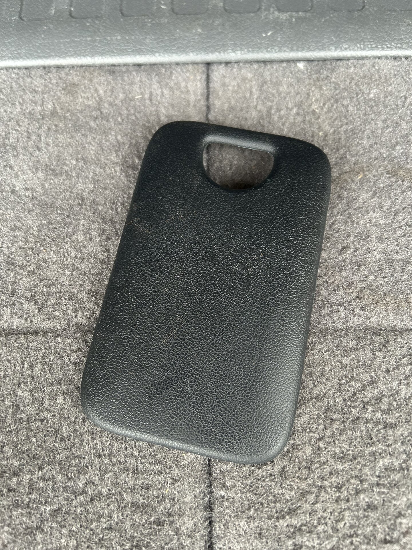

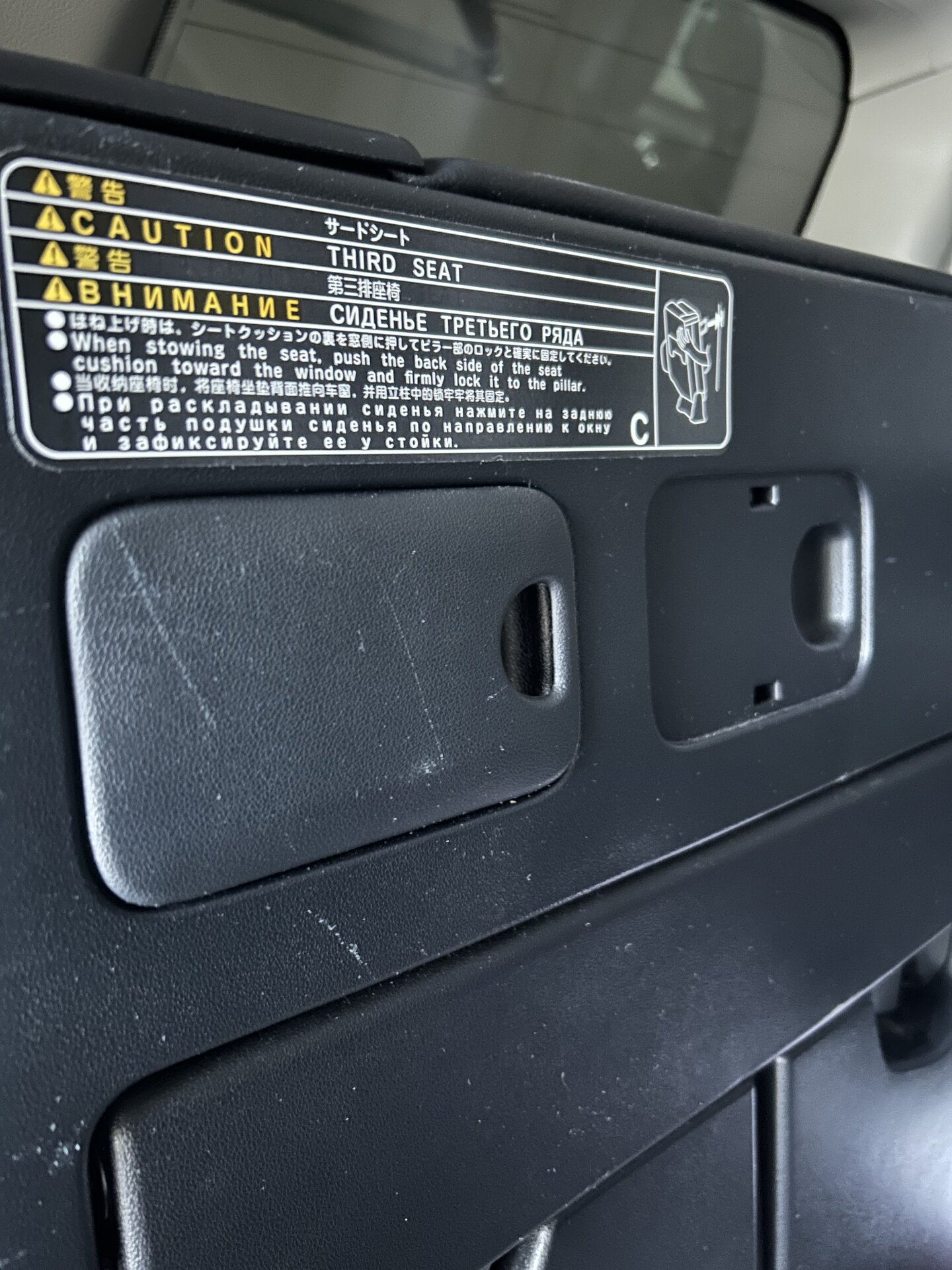

Can you help me out with the part number for this floor cover thing?

If you flip that floor hook cover part over it'll have a number on it, should be 72918-60021-C0 for black interior. For the record other colors have different suffixes. Also for the record, that number is just for the third row. Second row has a couple different numbers depending on position.

Hahahahahaha. You're telling me that my lazy ass could have just turned over that cover and gotten the answer instead? WOW!
Thank you!
Thank you!
There are probably mold marks that add a bunch of numbers into the mix, so it may be difficult for someone not used to this to determine what the actual number is.. but.. yes most trim pieces have it molded on somewhere. Most.

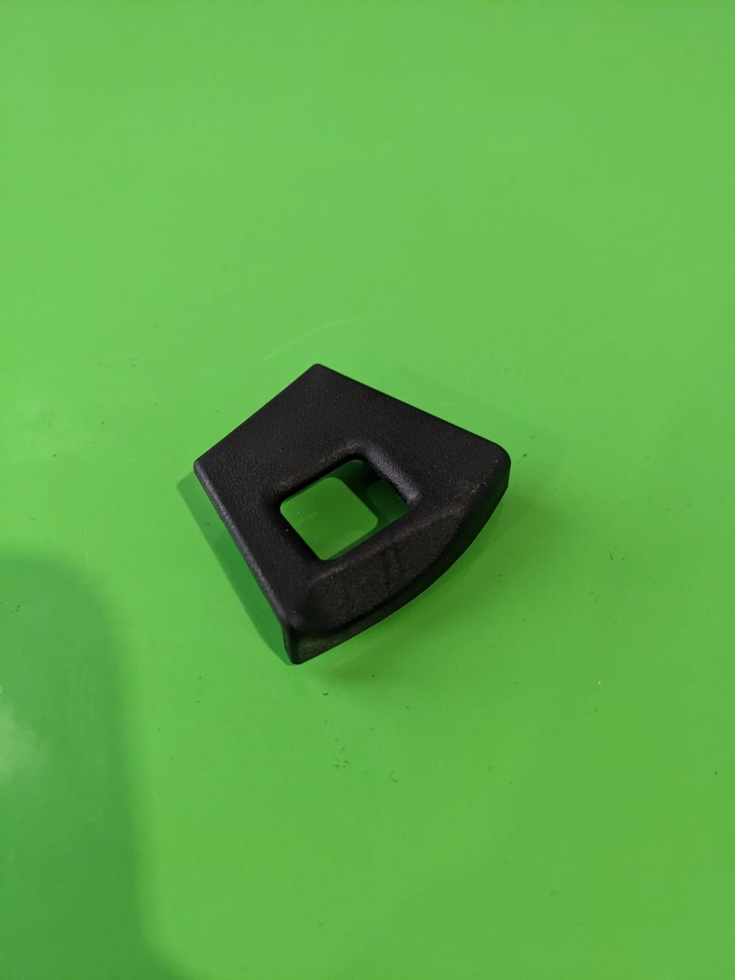

Having a hard time finding PN for glove box strikes- I don't see them in any of the parts diagrams I've pulled up. 15 LX, MFG 1/15. Both sides are out, but I found one under the seat. Molded on the back is just >PEEST< L1

I tried to look this up in the other thread and it looked like it only comes with the whole glovebox shell and door. But maybe one of the OG parts guys can dig further..
