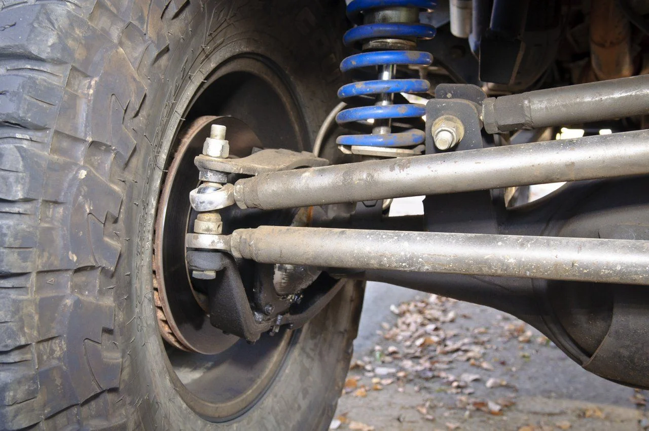

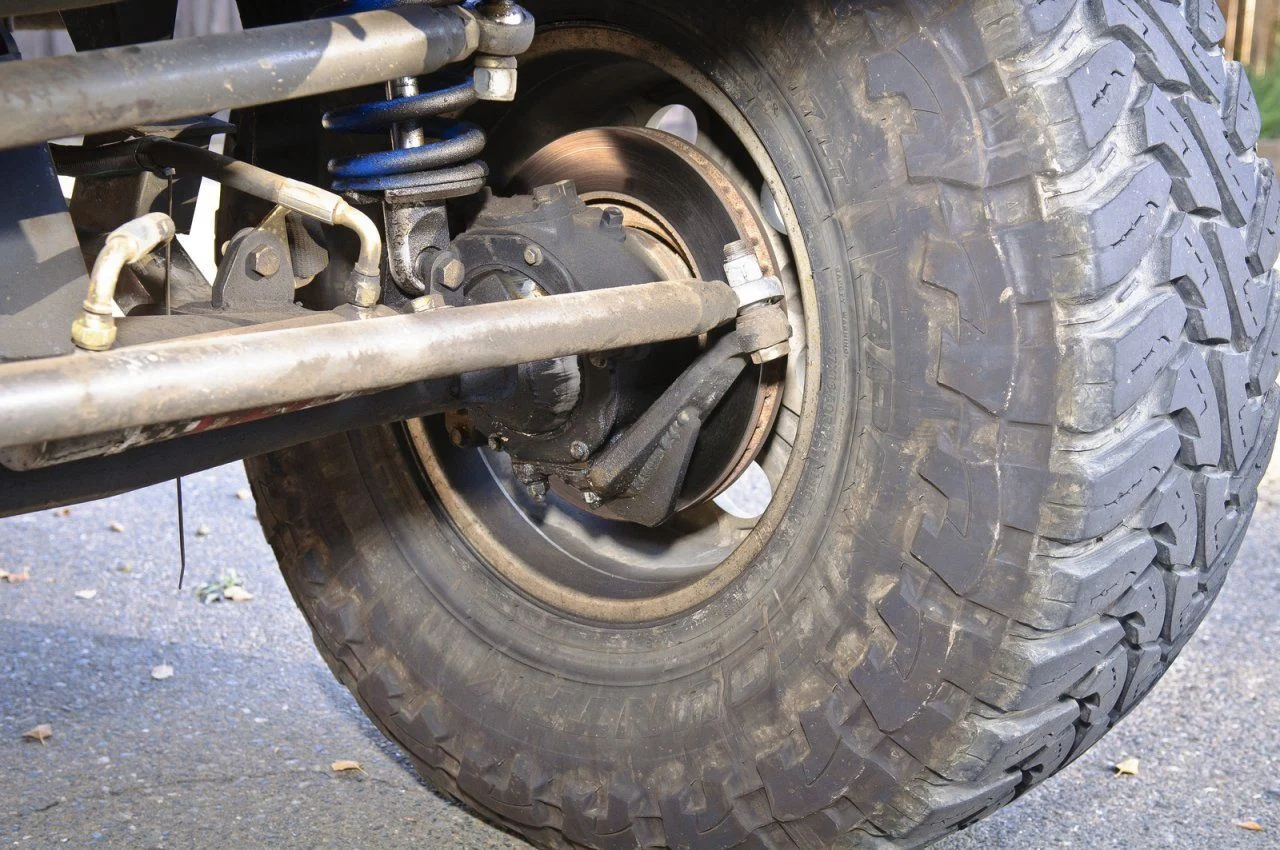

Hey JT! It was good seeing you a GSMTR a few weeks ago. I dont have deep pockets, so i am going to try and mock up some stuff to basically make a homemade high steer kit and RHD steering arm. I am planning on "modifying" a steering arm on the DS (like the first picture, except I am also going to make a plate that will go on top (like in the 2nd picture) to make it double shear. On the PS I am just going to make a plate for the top of the knuckle like I plan to do on the DS too so both sides will be double shear. The project is going to be a little slow, because I have to go over to Decatur, AL to pick up the axle and i have to figure out when that can happen before anything else can really move forward.
