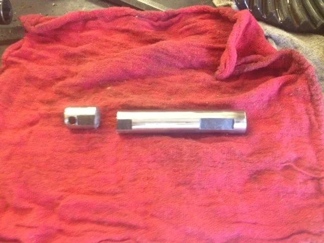

This is what we found out that what making the clunking noise, it could have been a lot worse...new one is ordered and will be here this week for last minute installation next Saturday...
glad its not the locker!
its a "cheaper" replacement part of the locker....bought a spare too :idea:

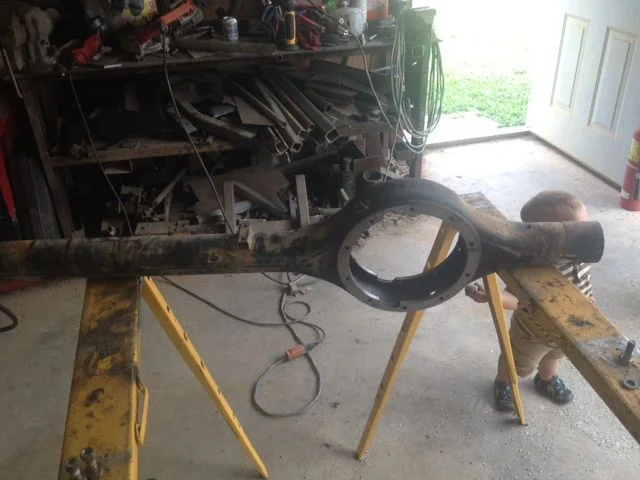

Well at GSMTR something broke in the front end of the Franken80, so Operation HD Toyota Axle and Front End is officially underway...
The goal is to convert a 9.5 SF rear axle into a 9.5 front diff with 80 series bells/knuckles/birfs. Since all this is happening, I am also moving the tie road infront of the axle, adding crossover steering, regearing to 5.29s (since I now have 2 9.5 diffs), hydro assist steering, AND 3-linking the front end...
Inevitably the Franken80 is going to be down for some time to get all this stuff done
This the donor axle (Thanks Griffin, I still owe you some beer), today we cut off the spring perches and other misc. things and cut of the axle to size. Next step is to get a donor 80 front axle and cut the bells off and mock up how everything should be lined...

I talked to Eric Hagan last night and I am going to get the bells from a housing he has in North Alabama. Its a complete front axle so I can use the knuckles, hubs, birfs, and shafts to help mock up the complete axle to make sure everything lines up like it should...
