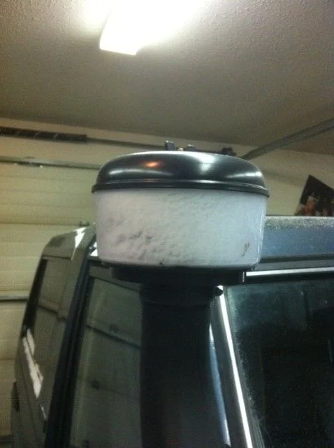

I put my pre-cleaner back when the snow hits for my ski trip.
Thought I would share my experience running my snorkel this winter. Using the safari air ram head I discovered I was getting moisture into my air filter box, as seen in the first picture.
I decided to change it out for a precleaner style head and the results speak for them self. The second pic was taken after driving in an early morning ice fog at about -15*C. It was not snowing at all. You can see how much frost the pre cleaner captured.

Ok, getting back to my original post I have some more thorough results to report. These pics are after a 50km drive last night in the most severe winter driving conditions. I am talking white out conditions with drifting snow and top speeds of 60km/h.

I think some of this can be alleviated by getting a better suited pre cleaner to handle the air flow requirements of your truck.

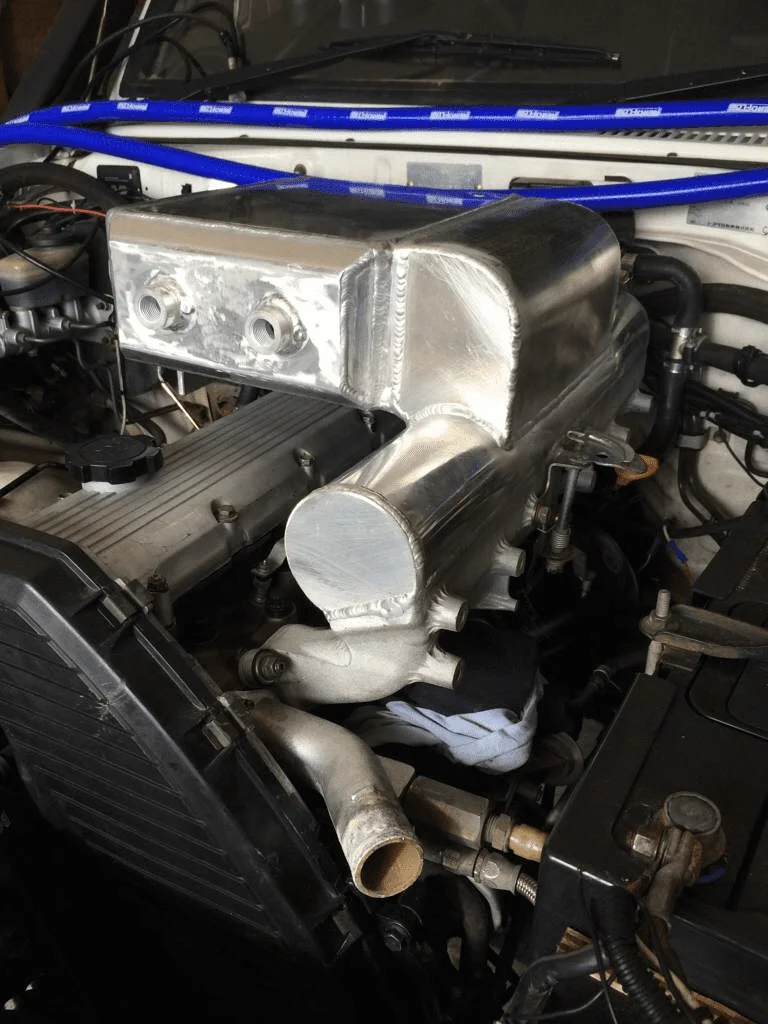

Now this is going to get interesting, I have been thinking about this as now it would be possible to make up a decent size plenum for the 1hdft
