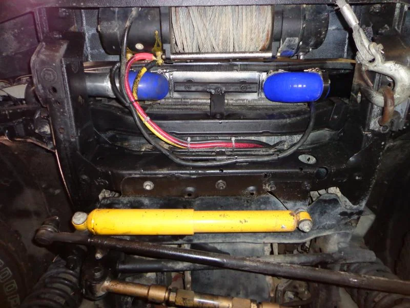

Hey, could you please post some pictures of the IC fitted in? Did you need to do any modifications/ trimming to get it in there? Do you run AC and tranny cooler?
thanks
Sure, will do this weekend. Almost no modification needed. It sits low and I removed the winch, which is in the way if the airflow. I need to refit it as we've got a wet few months ahead of us.. I will need to mod the bullbar and mountings to put some space between the winch and intercooler.

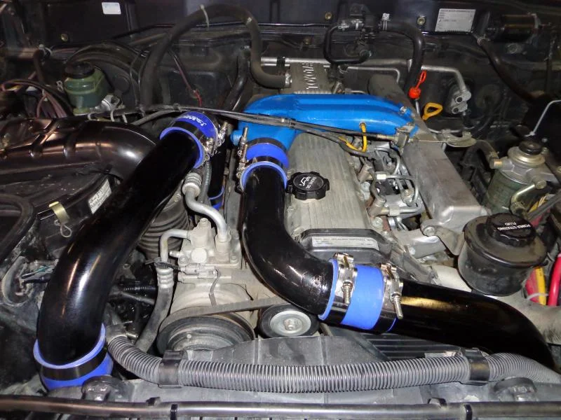

Really sweet top-mount Foreal. I'm steeling your aftermarket oil pressure sender mounting idea. Are you still running the stock sender as well?
It's not my set up but I hope to copy the intercooler down the road
As for the oil pressure gauge I have a set up planned just need to get my final parts in and install the turbo

Looks very much like mine. I have finally fitted it the other way up, mounted with flat bar brackets to the cross beam that holds the bonnet catch, winch now back in.
