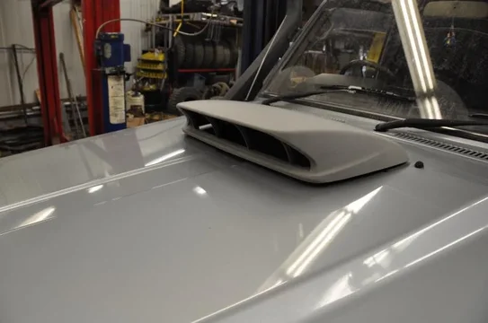

Crusher's 1PZ home built intercooler install.
Yeah the bastard stole my idea. :) I'm going to rig up a steel version to mount my big air/water unit. It's too big to work with the Denco cast aluminum elbow I have without hitting the raised portion of the valve cover (the back half).
I don't see anything wrong with using steel for that part. ?
Adam why don't you order just the intercooler from Northside 4x4
Steel and aluminum would be mating. Something would have to be put in between
Adam B said:
Too small..... :D
I'll just cut a chunk of gasket material to go between the steel+aluminum. Although with the oil that still finds its way through the intake I doubt that galvanic dissimilarity will be a concern.
Bigger huh.
You must be planning to mod the whole intake manifold.
You need to run a way bigger catch can instead of that teaspoon can. Run something like stainless scrubbers inside to condensate the pcv fines
Have you checked the baffles under your valve cover? You can close them up slightly to reduce blow by
