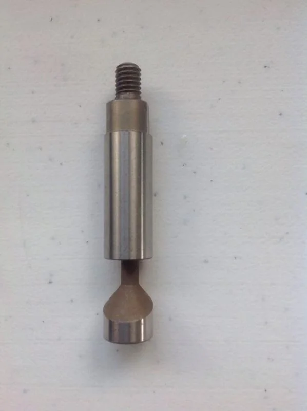

Any thoughts on upgrading the spring of the 1hd-t diaphragm to a 1hd-ft one? I am curious about playing with a more advanced high boost fuel pin.
G or BB
I just ordered my Grunter Extreme from Graeme and he suggested getting the 1HD-FT aneroid pin and spring if I can find them. Hopefully my new turbo will be here soon...

1hdt fuel pump rod
Hi guys new in here was reading past posts about people having trouble getting the fuel pump rod back in if they happen to pull it out the one with the diaphragm on it on the front of the pump near the throttle control onto of the pump is a 17mm plug fitting remove that plug fitting there is a small spring behind it .Once that is removed look inside where the fuel rod goes and you will see a small pin laying horizontally push that pin gently towards front of pump now just refit fuel rod dont forget the spring and washer once thats back in refit the plug fitting and spring dont over tighten the plug and make sure the copper washer is still on the plug
