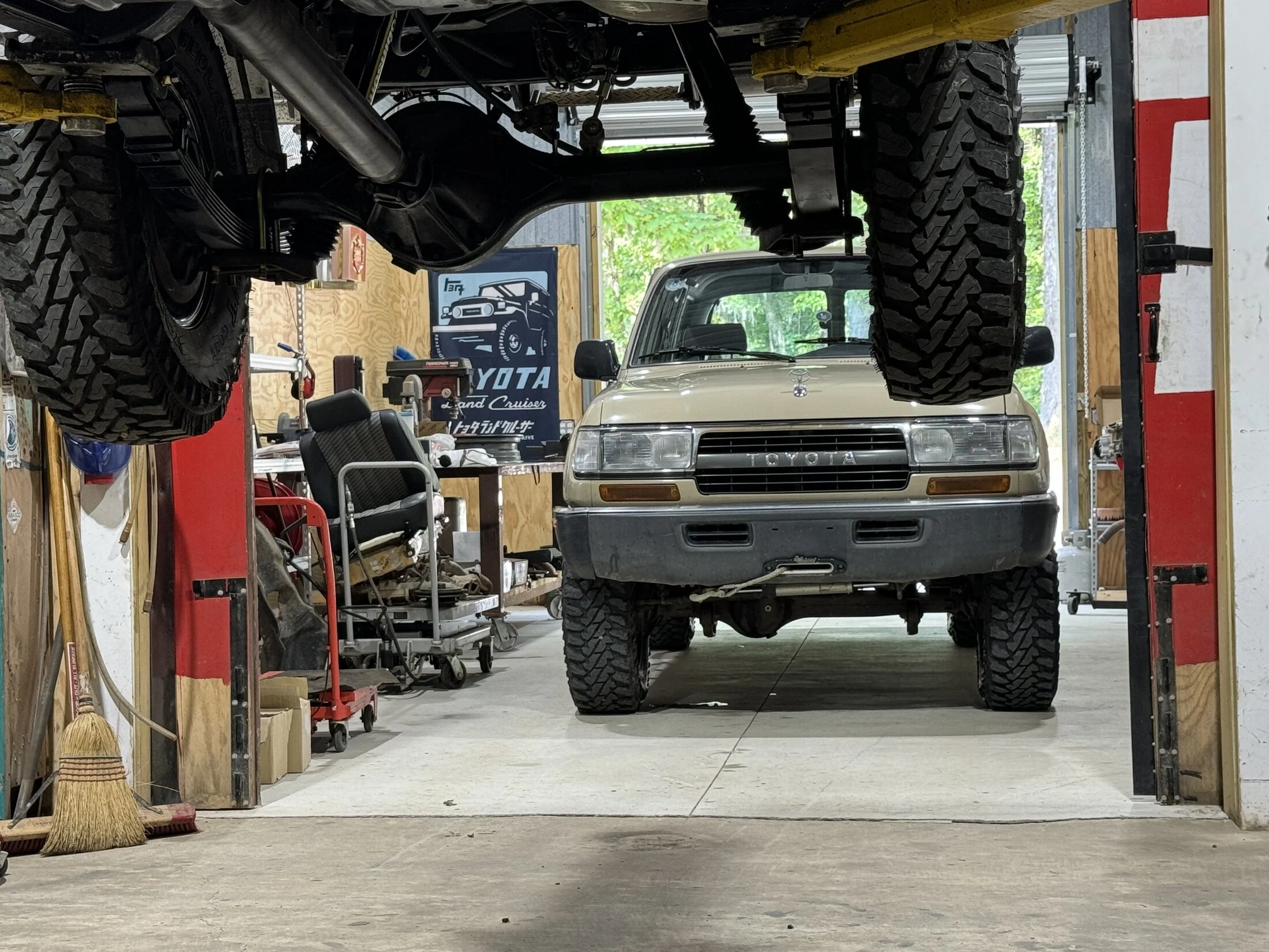

Got this thing back together with the extra shim. Seems good and tight now.

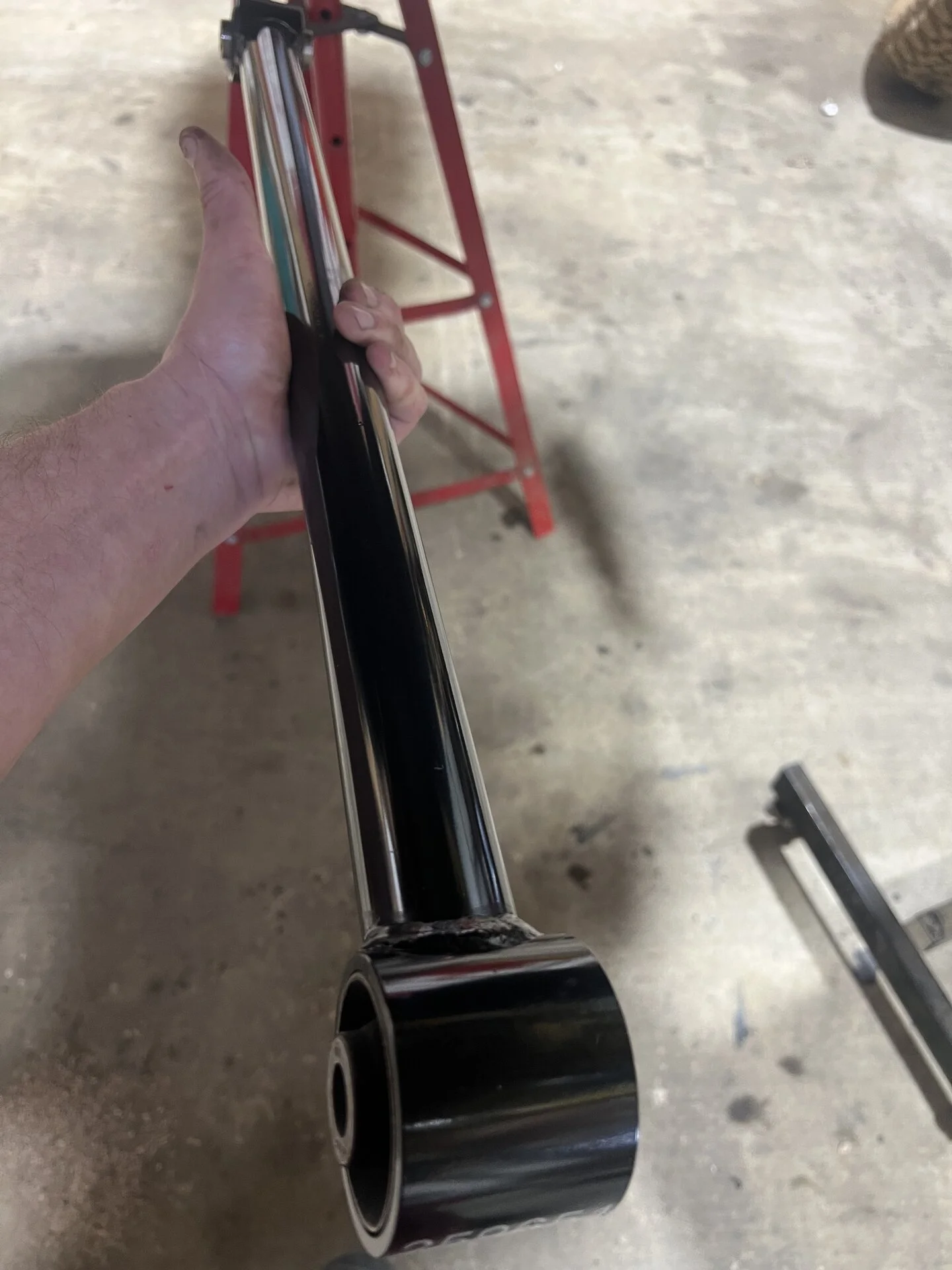

I have been hunting a “clunk” in the driveline and thought it may be lower control arm bushings. I hit the easy button and purchased some new SPC arms from Cruiser Outfitters. Turns out, as Beno said, I suck at ordering parts… I bought 200 arms
Those have to go back.
Anyway. Damn. I’ll be the PS pump Monday and this thing will go back to DD and trail truck duty. I’ve missed it.

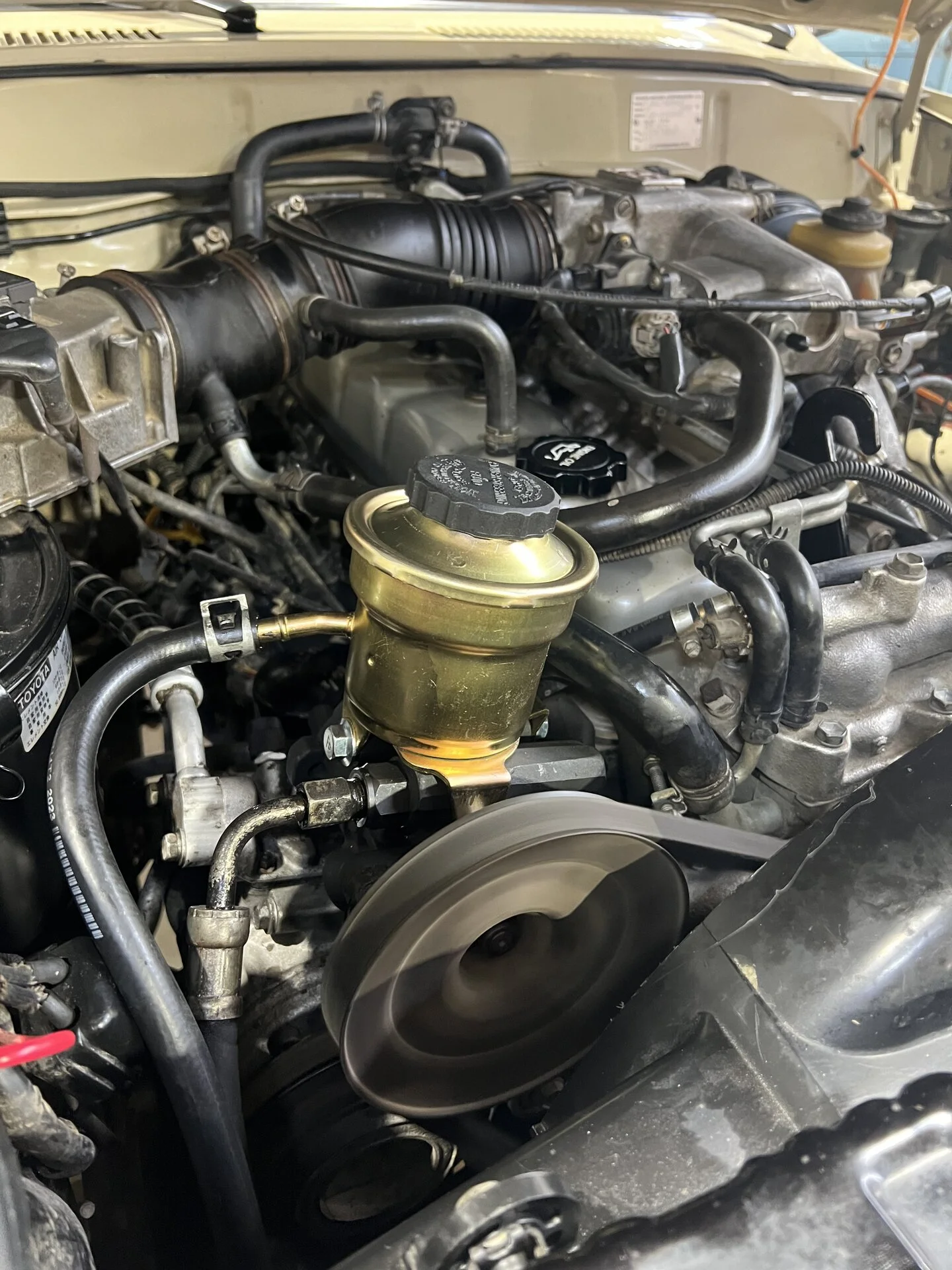

PS has had a weird “hitch” in it. Felt like PS then no PS. Rough through the sweep. Not there when the motor is off and front jacked up so I’m guessing the pump.
Ordered an OEM pump only to discover the 91-92 3FE pump is not the same as the 62 pump. 😩
Had to order a new one (non OEM) from City Racer so that is off the table for now. I don’t think I’ll put the old one back in. I’ll just wait 4 days for the proper part.

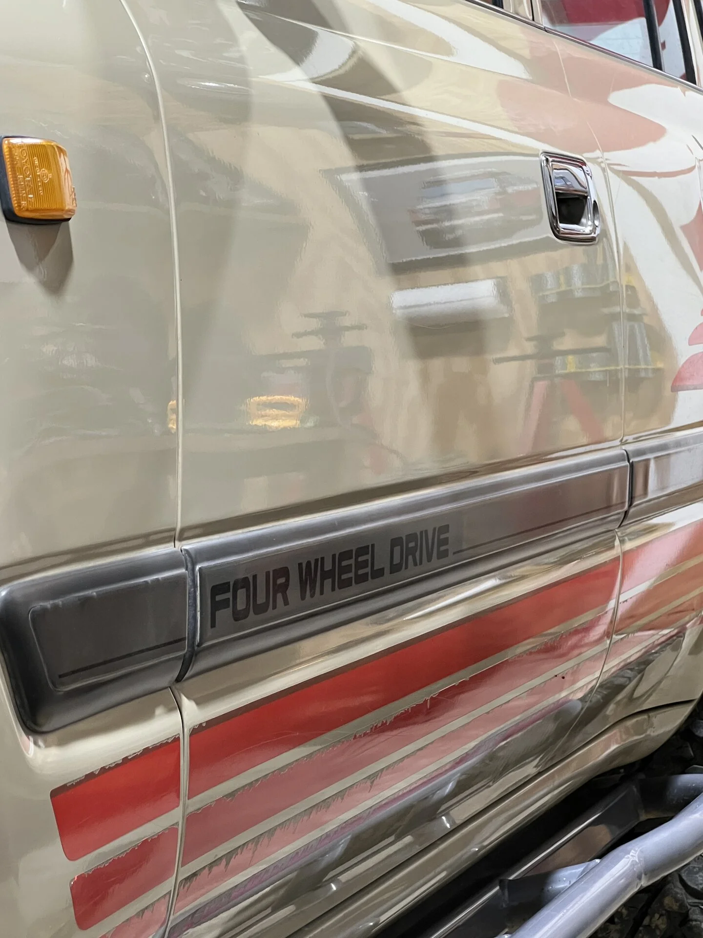

So I’m going polish the paint and give the interior a good bath.
You might want to see if a pump rebuild kit is available. I recently rebuilt the pump on one of my 2UZ's, it was stupid simple and the OEM Toyota rebuild kit was only $40.
There is. I think I will get a kit for the one I took off for a spare.

Got the City Racer pump in. They made the return in a different spot so I had to make a new return line. No biggie but just FYI if you get one.

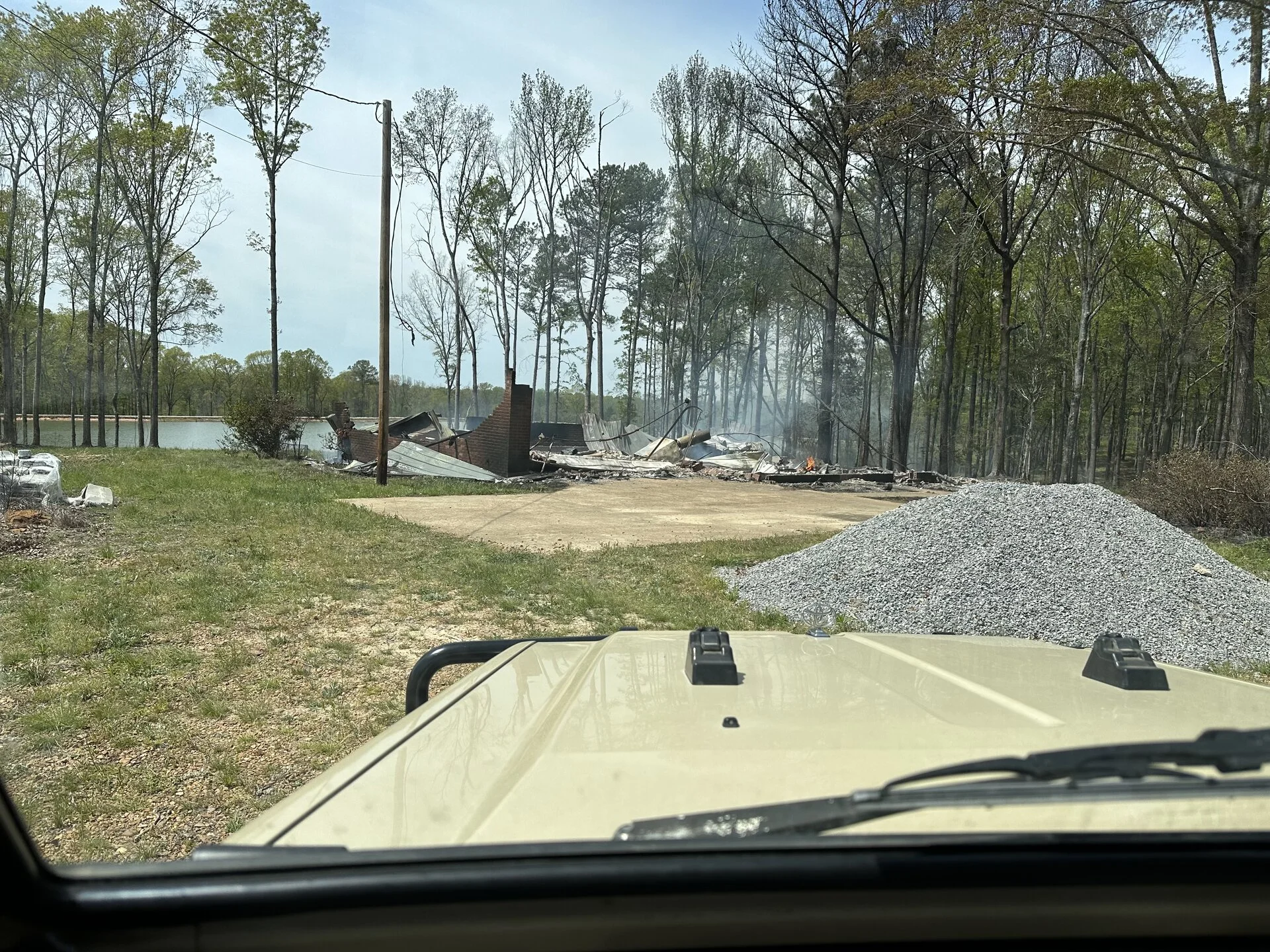

Why'd he burn it? Infested, condemned, squatters or .....?
It was a mess. Was going to knock it down anyway so we got to enjoy a good fire first.

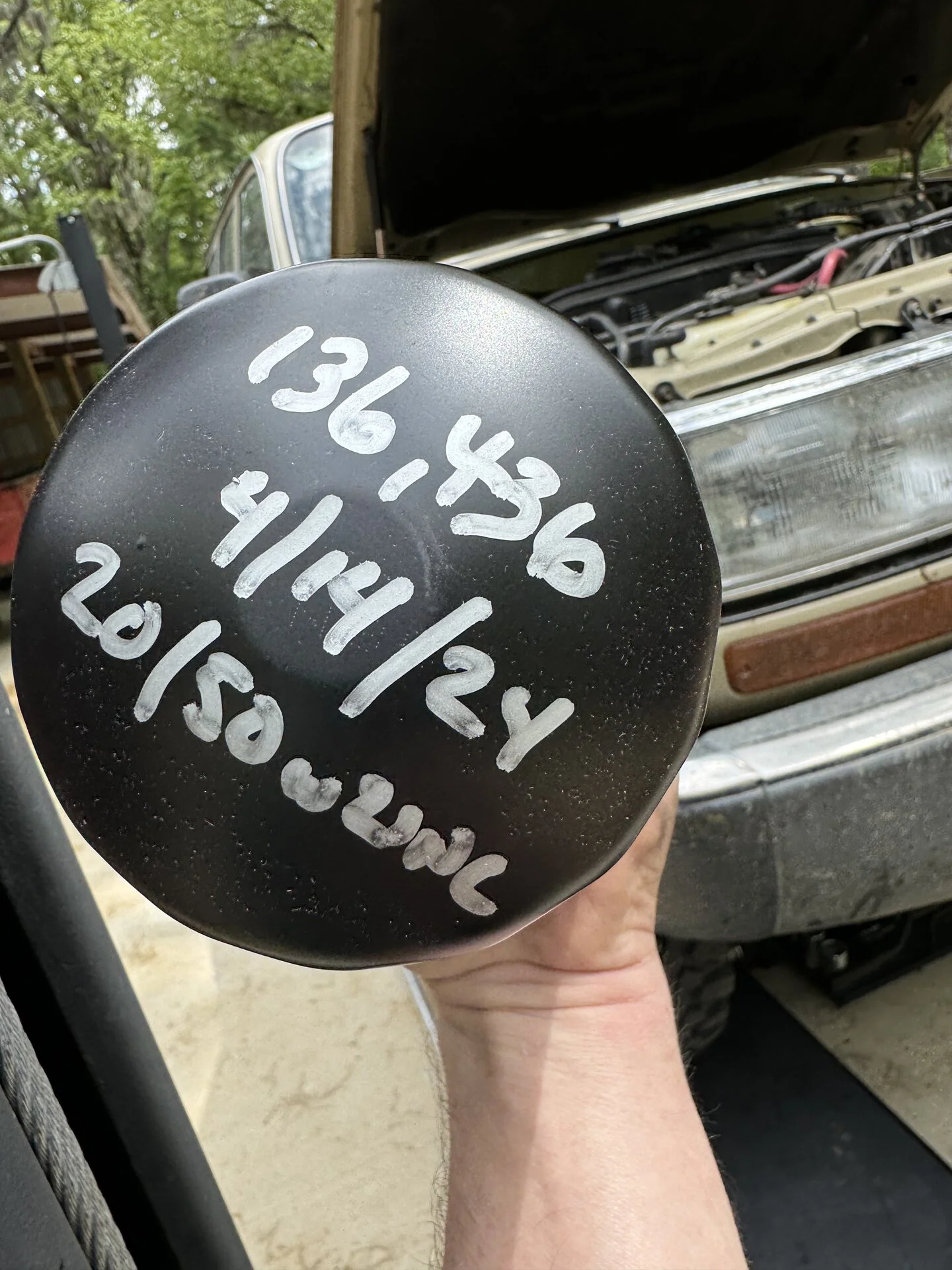

Today I changed the oil and used one of my dwindling stash of proper oil filters

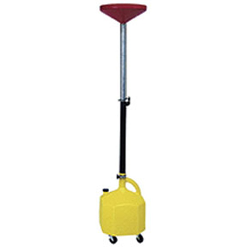

Nolan, I am not sure if you have ever seen one of these? I have one at my home shop and at work. Holds 8 gallons, so enough to drop both diffs, tranny, t-case and engine oil. You can see through it so you know when it is getting full. It is also easy to carry and dump.
One of these for larger things like an auto tranny....
And one more, pad keeps the splatter down!
Once you have used these, you will wonder why you did it any other way.
