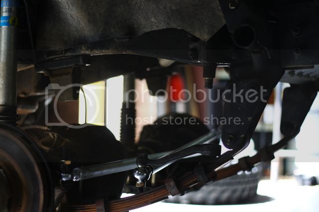

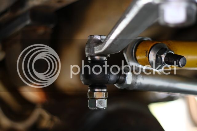

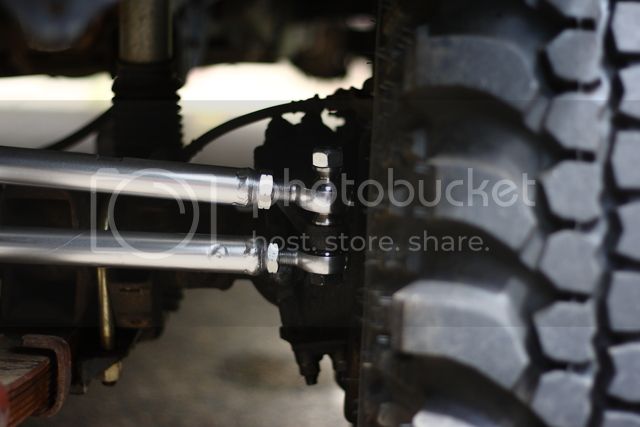

Got started on the tie rod drag arm install.
The steering arms are super hard and where a challenge to drill out on the car, I opened them up a bit with a die grinder and then honed them with a 5/8 drill bit.
Turned out really nice actually and the clearance for the bolt is very tight.
With the tie rod in place i measured up for the drag link, which i built basically the same as the tie rod but i didnt plug weld the sockets this time, the drag bar has 3/4 inch ends and hi misalingment spacer to reduce it back to 5/8 bolt.
The pitman arm hole is a hair to big for the 5/8 bolt, must be a bigger taper on the ball joint, it fits and works fine but i will in the future weld the bolt to the arm to reduce any side loading and keep it sitting paralel and square.
Decidied to move the pitman arm position to a more central position, found out there is a limited amount of turns on the steering box.
test flex up and fit, turned out spot on
Its about 10mm off the bump stop and there is heaps of clearance alround still,

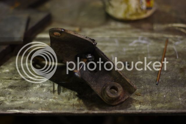

Steering Dampner bracket hot off the press,
Had to shorten and section the dampner mount to get enough stroke.

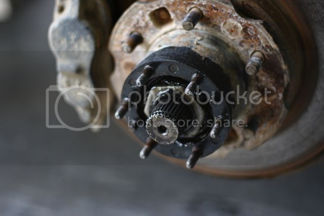

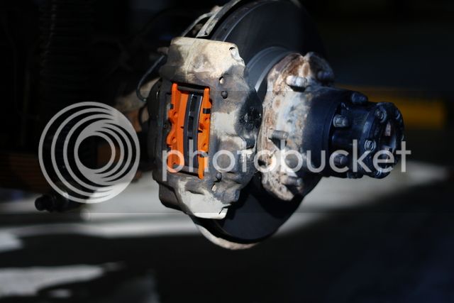

Noticed how thin the pads where the other day.
So decided to do a bit of a freshen up on the front end.

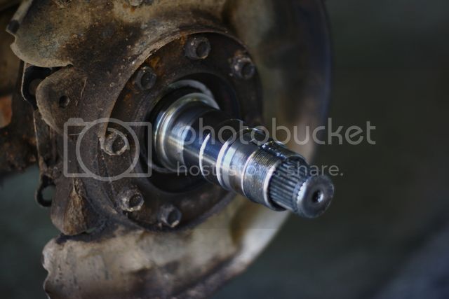

The passengers side grease had all liquified to almost an oil consistancy, not sure if this was from water egress or what, the hub was fairly loose with the large locking nuts so may have leaks on the inner seal.This may be the cause of the staining dripping on the lower steering knuckle which I thought was weeping from the axle.
Will keep an eye on it in the future
Manual hub removed,
clean axle,
Dont know why they floated the discs on the rear of the hub but eh, need to take apart a heap of stuff to get to them.
Studs pressed in the new discs
new v old, nothing in it,
Had to make a makeshift socket for the large locking nut, which on opening up the hubs was very loose.Doesnt look like much but it got me to the required torque settings for the lock nuts.

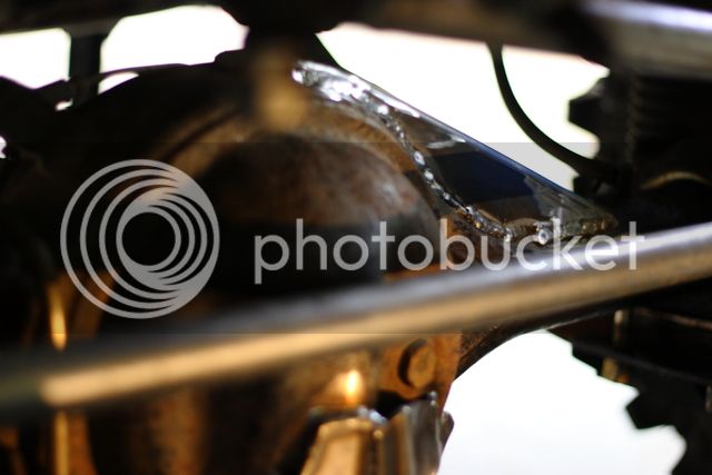

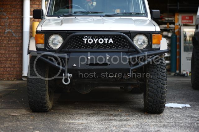

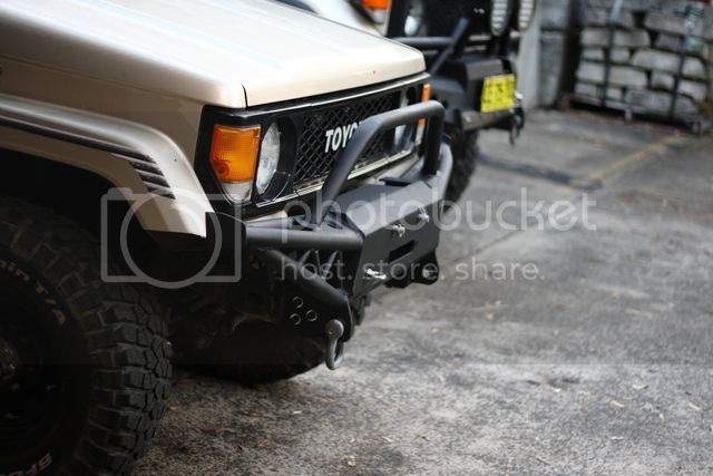

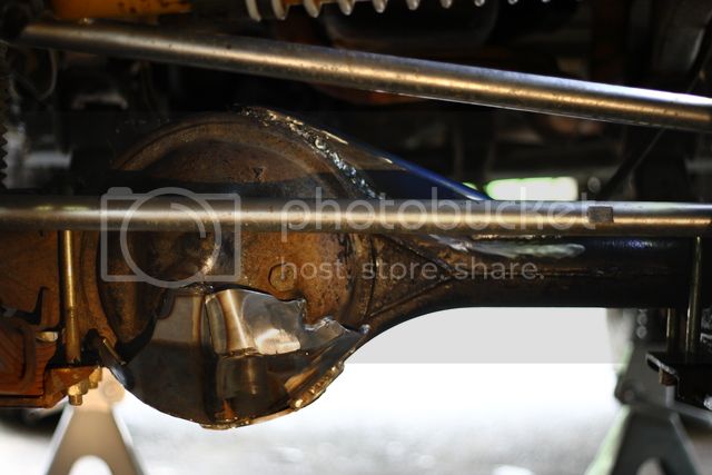

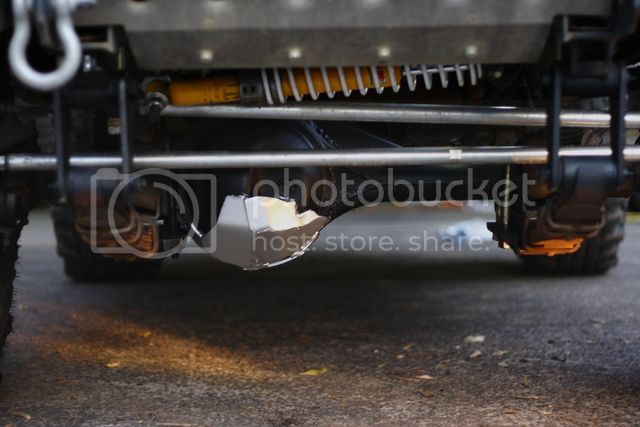

Built up a diff and drain cover, also threw a gusset on the top side of the pumpkin.
Will size up some gussets for the knuckles in the future.
Changed the oil after I had finished welding,mainly as a precaution, was pretty damm clean as the axles were rebuilt only 5 thou ago.
Didnt seem to show anysigns from the heat exposure from the welding.
With a lick of paint.

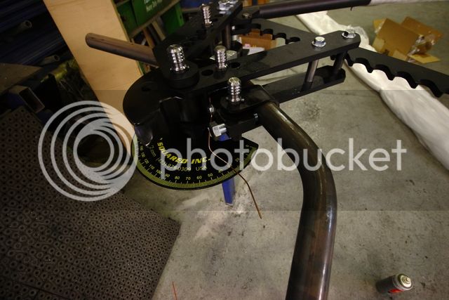

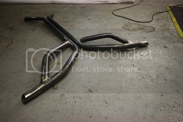

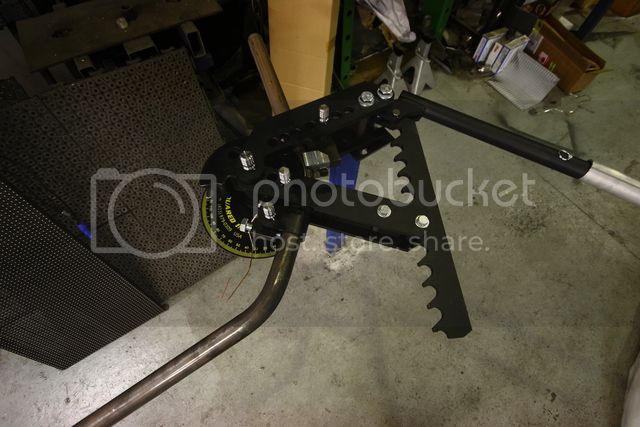

Bought myself a JD squared bender, something I have wanted for a long long time.
Got a die to suit medium 32NB tube or 42.4mm od.
The hype is granted this thing bends so nicely, did a few 180 degree test bends and then it was straight into it.
Putting in the last bend for this section.

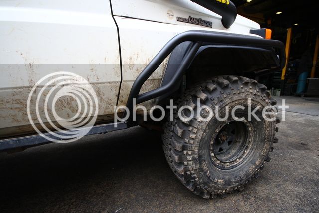

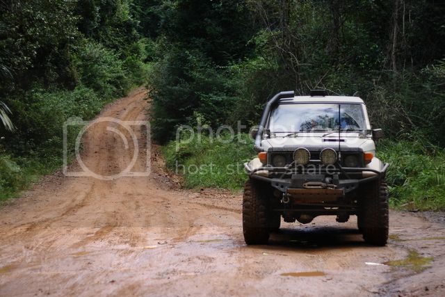

Got out this morning for some more Ouribah sessions, was a bit busy driving to shoot to much footage but had an awesome morning.
The truck took everything I could throw at it , christened both the brush guards and the diff plates.
Luke in the little Bundy that could stuck it out all day, conquering all.
Except for here, lol
