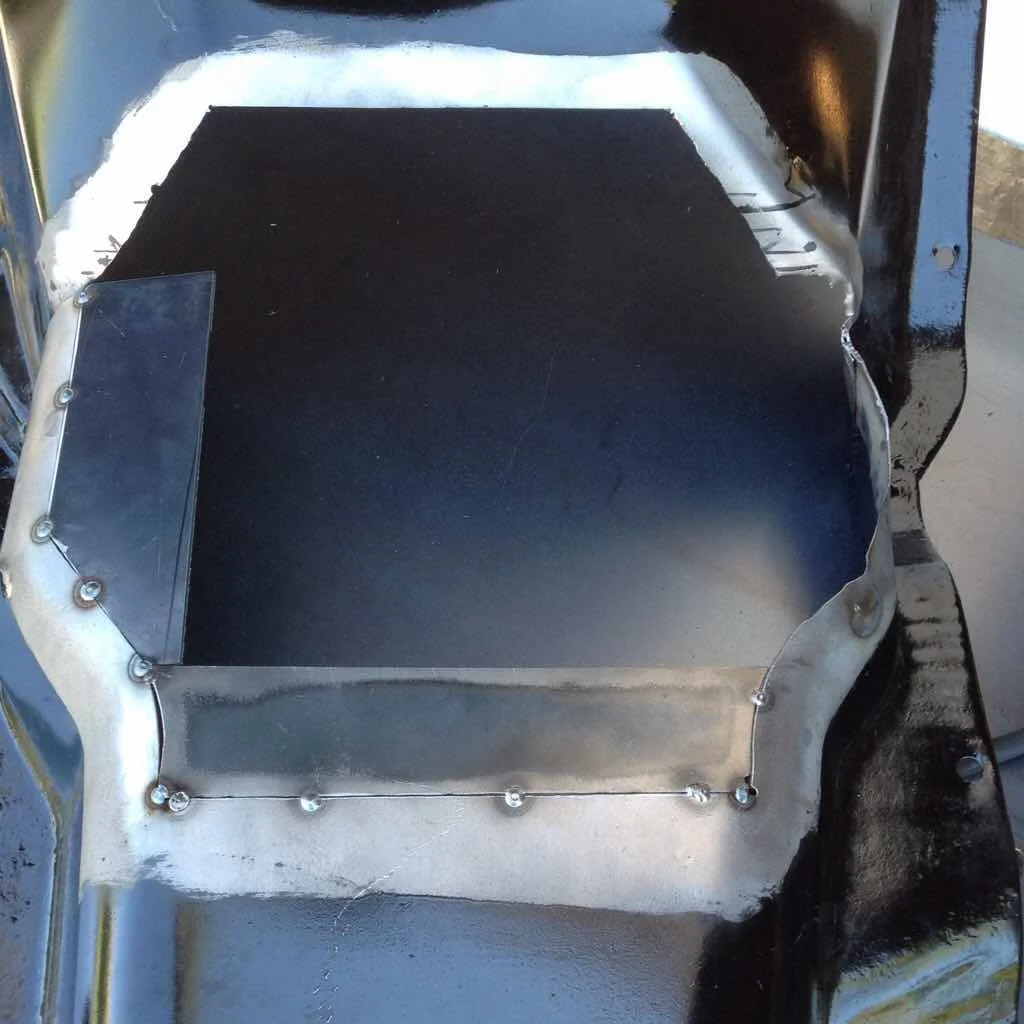

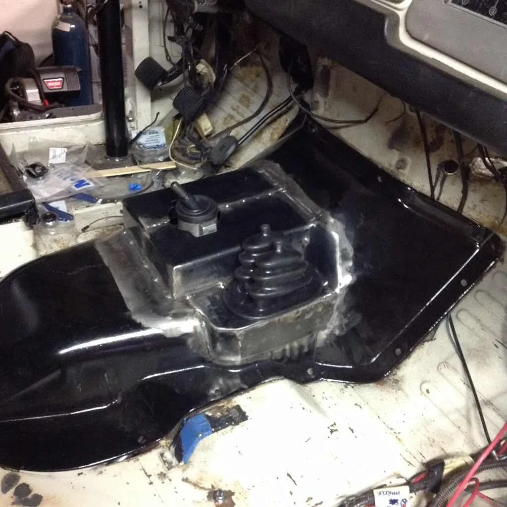

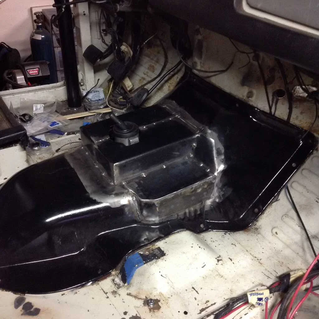

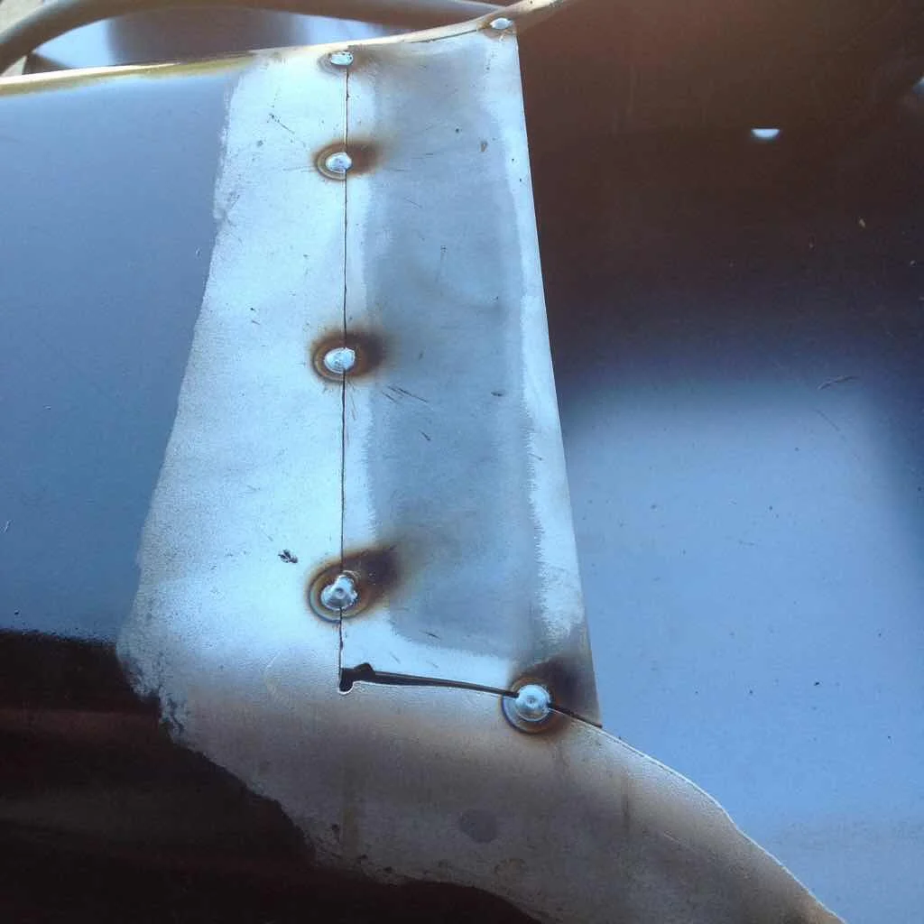

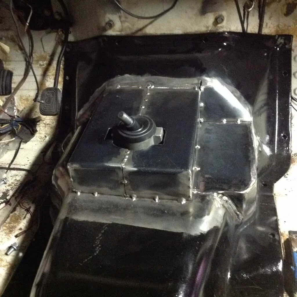

Well here's what I came up with for the trans tunnel. I'm no master at fab work. Among other things: I need to learn how to make smaller spot welds.
