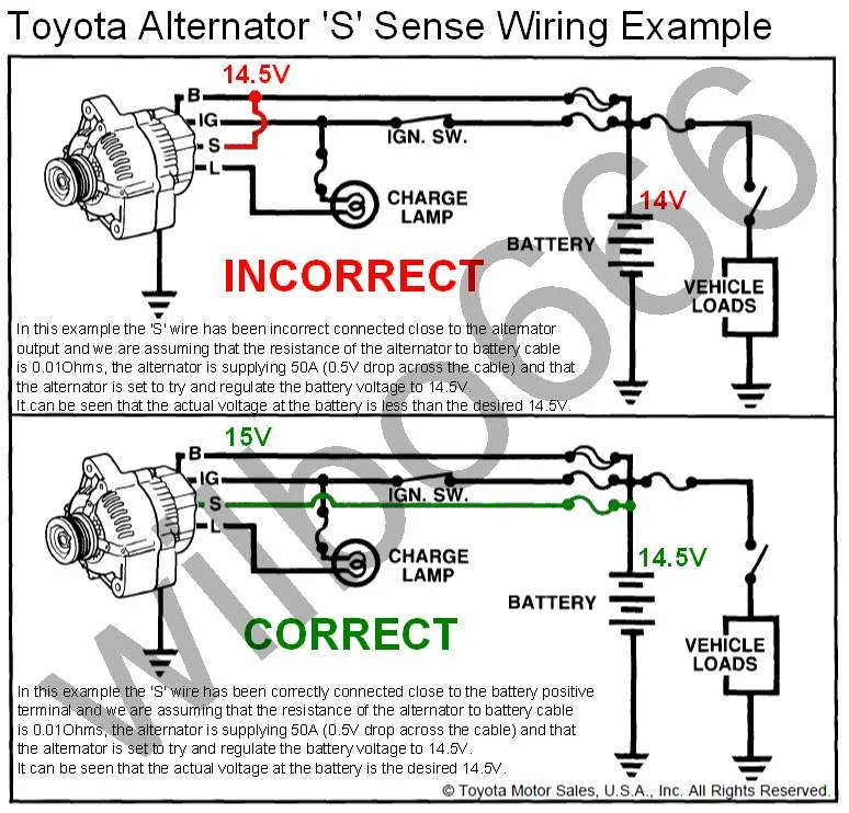

I'm trying to apply the supplied example which is a Toyota 4 wire to my Bosch example, so bear with me.
Are you saying my remote sense voltage input wire should go from the alternator to the positive terminal on the battery? On this alternator the remote sense input and battery charge output are on the same stud, which doesn't make sense at first glance because it seems like it would only be sensing it's own output.
Need...more...coffee...
From the link you posted above:
3-Wire Explained
Wire 2: Remote Voltage Sense Input
It is better to run the sense wire away from the alternator and over to the power terminal post near the battery. This will ensure that the system voltage is properly maintained.
This is the same explanation as the Toyota diagram that I posted.
Rudi
I'm trackin', but this alternator has 2 posts. One for a 12V switched source, and one for charging the battery.
I think I might just send this one back and use a GM 3 wire. I understand how that one should be hooked up.

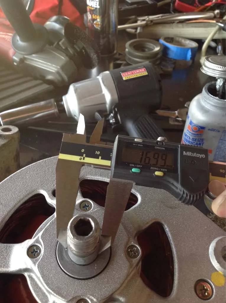

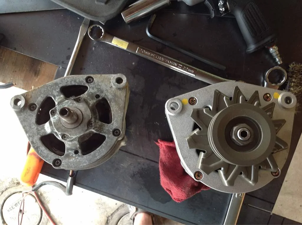

Alternator madness is over. I went with the Bosch AL 129X. It's rated at 115amps. Only bummer is it does NOT remote sense voltage, but it puts out a constant 14.2V according to a reputable rebuilder shop here.
Here's what swayed me in the Bosch direction instead of Delco Remy 10SI or 12SI:

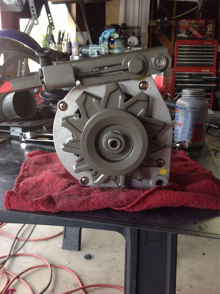

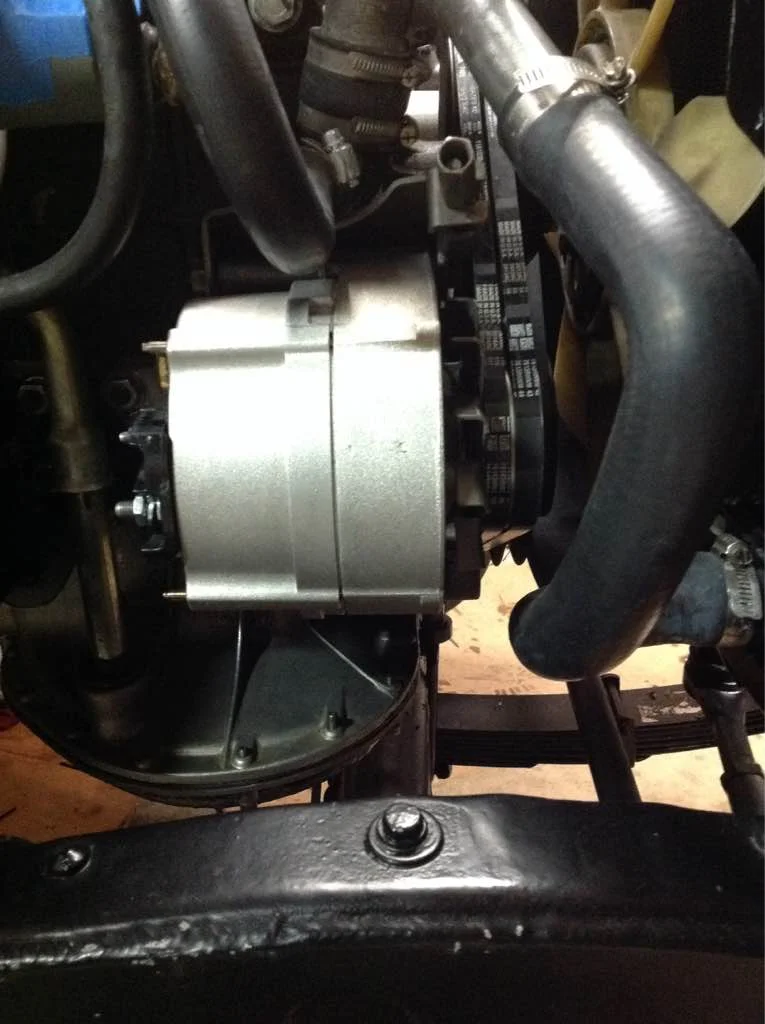

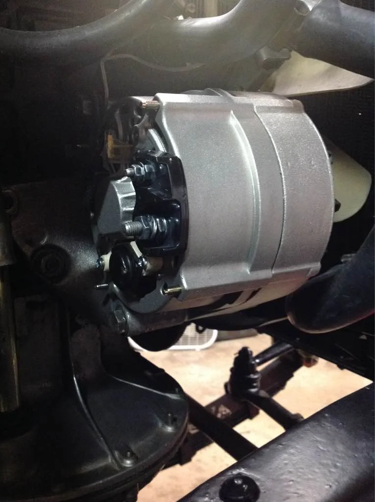

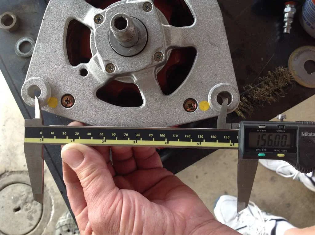

It is a DIRECT BOLT IN for the OM617A. No modifications were made to the stock tensioner or mounting bracket. With standard OEM size, 1040mm I think, belts slipping them over the pulley was super tight, but it can be done. 1 banana job. 2 hours since I repainted the pulley, bracket and fan.
Cheapest I found was at O'Reilly Auto P/N 15651. $139.99 + $43.20. Ehhh, probably not Bosch reman quality, but it has a lifetime warranty so I'll rock it.
Ask for a 1992 Saab CD Turbo DOHC I4
Here's some pics of the process:

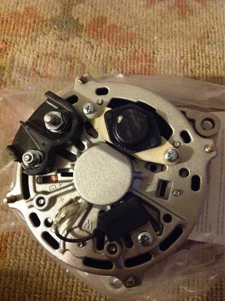

So here's the deal with wiring this baby. Large lug is the output, small lug needs 12V switched power with a 3W idiot light wired in series. Ground the case per usual.

so no voltage regulator? isn't that hard on a battery? I don't know enough about electrical systems yet to understand this. it's down the road of learning. it's a long road but one I'm headed down!!o_O
It has an internal voltage regulator. You can see it in the first picture. It looks like a black quarter-sized object at the 2 o'clock position opposite the B+ lug. It's replaceable on these alternators. I'm buying another to carry as a spare in the glove box.
so it's just either on or off then? maybe I'm not getting what you meant by "it does NOT remote sense voltage". I like it. I just want to understand it too!!
Don't think of it as "on/off." Its just that if the system requires less than 14.2V, it just doesn't have to work as hard...
Some alternators, specifically the Delco-Remy 10si and 12si are capable of "sensing" the requirement to "up" the voltage in order to keep electronics operating in the 12-14V range. This is especially important when the battery or equipment is at a distance from the alternator. It's a better system than what this is, but I'm going to see how the AL129X works out. If things are getting dim, I'll go another route.
The small lug with a 3W idiot is not only for powering the alternator. It's also tells the (internal) Voltage Regulator what the voltage in the truck is and regulates from there. The set point of this unit is 14.2 Volts. So it will keep the voltage at 14.2V at all times unless the draw is bigger then the capacity to charge in which case the voltage will drop a bit.
Rudi
Rudi
Sage advice as always. You're the man Rudi!
