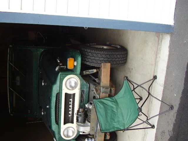

It all started with a 6 mos search for the right HeeP, with a short side trip gawking at a few Sami's.
Then this Cool looking pile appeared on Craigslist.
It had sat for 3 years the PO didnt even bother to get it running b4 selling.
I being the trusting soul that I am took him at his word. And bent over paying the price he was asking. (not that I didnt try to talk him down). He wouldnt budge.
So here I am with new a hobby.
My intentions to make a capable wheeler that is able to be a DD
No intentiuons of actually usuing it as such but would nice to have a 2nd car capable of DD.

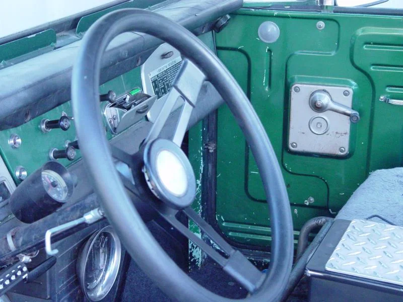

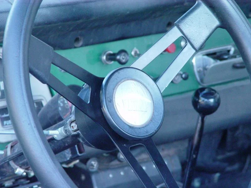

Steering wheel had One broken spoke so I replaced it.
The new padded wheel is awesome "Feels so nice" When it gets
Shabby It is only 37.00 to replace :)

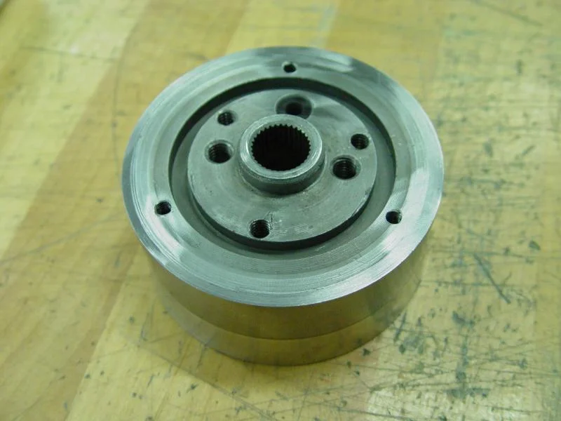

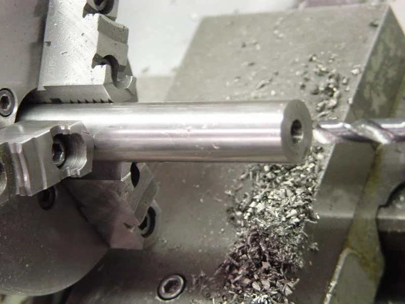

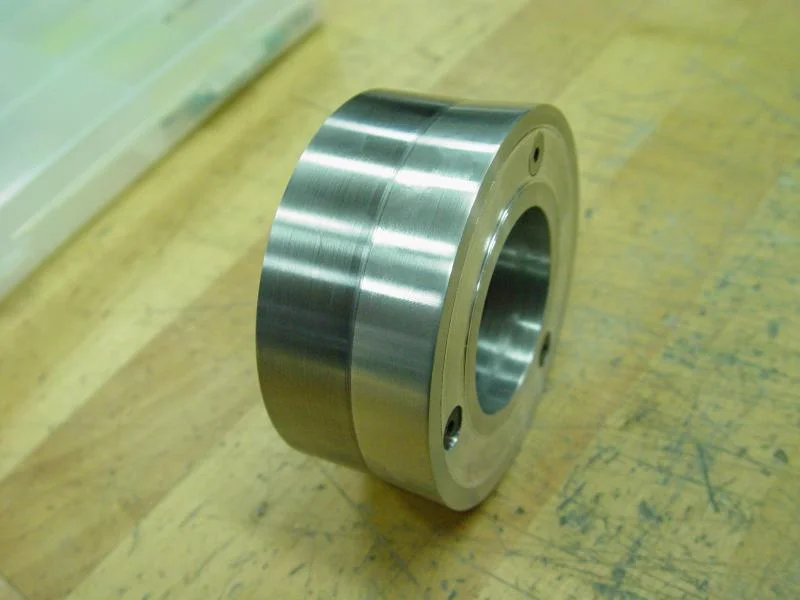

I cut off the outer circle and the spokes of the original wheel.
Put on a lathe and turned the hub round.
Bolted a piece of aluminum to the hub on the back side and turned it with a taper to match the Column.
A little ace Satin finish black in a rattle can.

Great job fabbing that steering wheel 'mount'. Looks very clean.
You could sell a few of those if you had the cores. ;)
Don't know about that turn signal stalk though....:grinpimp:
all you need is an orng stripe on the side and you could call it the ninja turtle! Have funwith it and good luck.

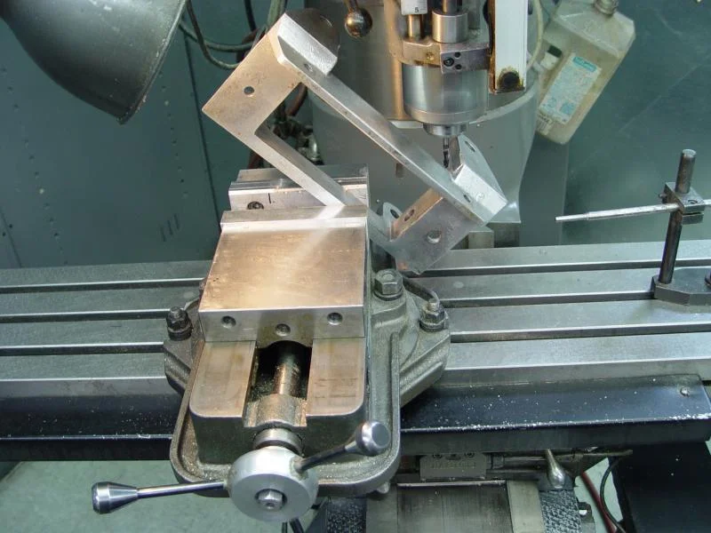

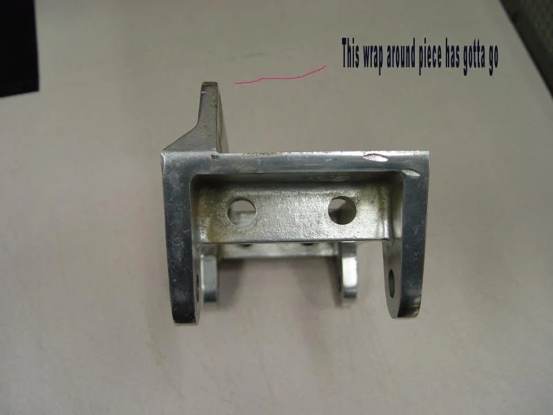

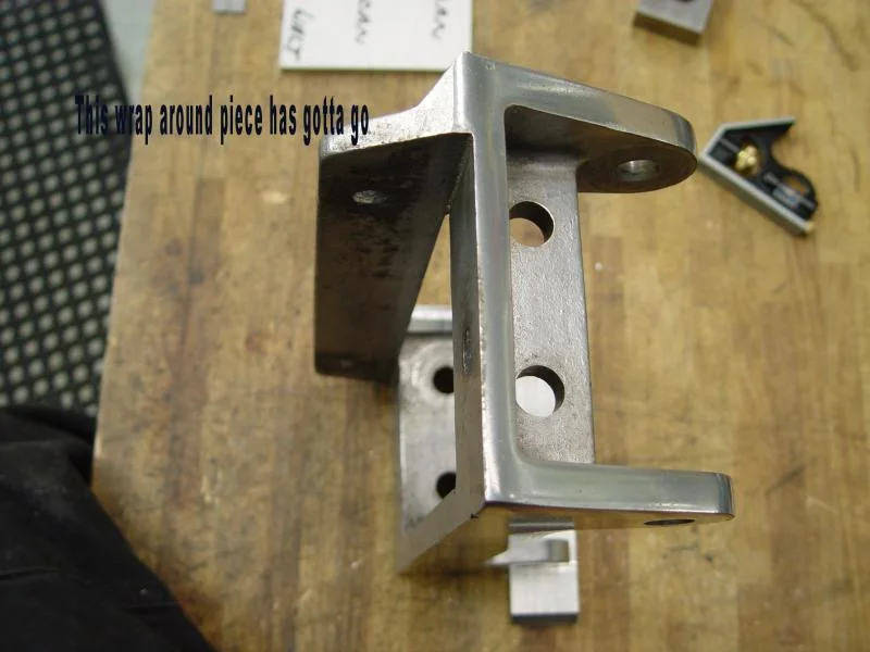

Getting back on track. I am building a new bumper, my fairlead
is a wrap around type that is over 30yrs old. Its mounting holes
are not center'd .
Long story short it needs to modified to use modern mounting.
For the day when i Feel I am rich enough to afford synthetic rope and need to buy a new fairlead.

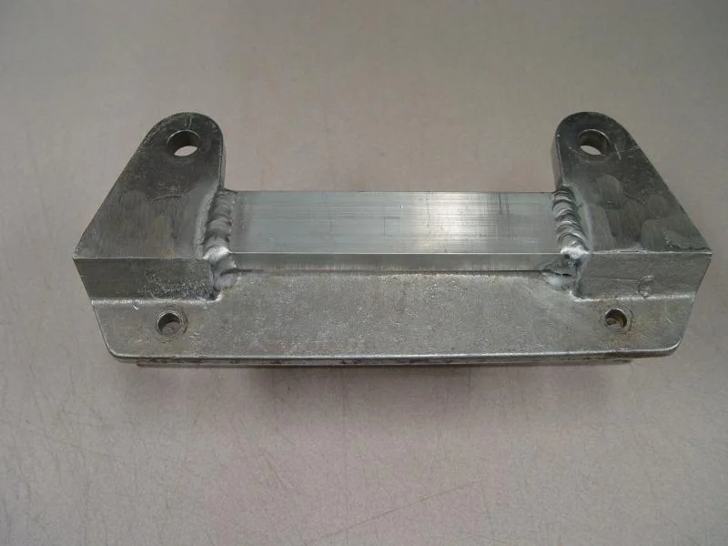

More Fairlead

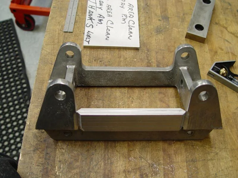

The last pic is me cutting a way sides in prep to weld in a new piece to the support for that side, when I cut out offending piece
First pic of this post is the fairlead prepped and ready to be Tig'd
Second is Welded.
Third is offending piece nicely removed

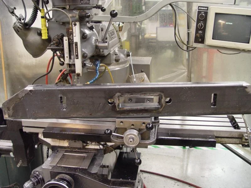

now for a little bumper to go with that fair lead
This has been one long running project.. this bumper that is.
Here is the beginnings

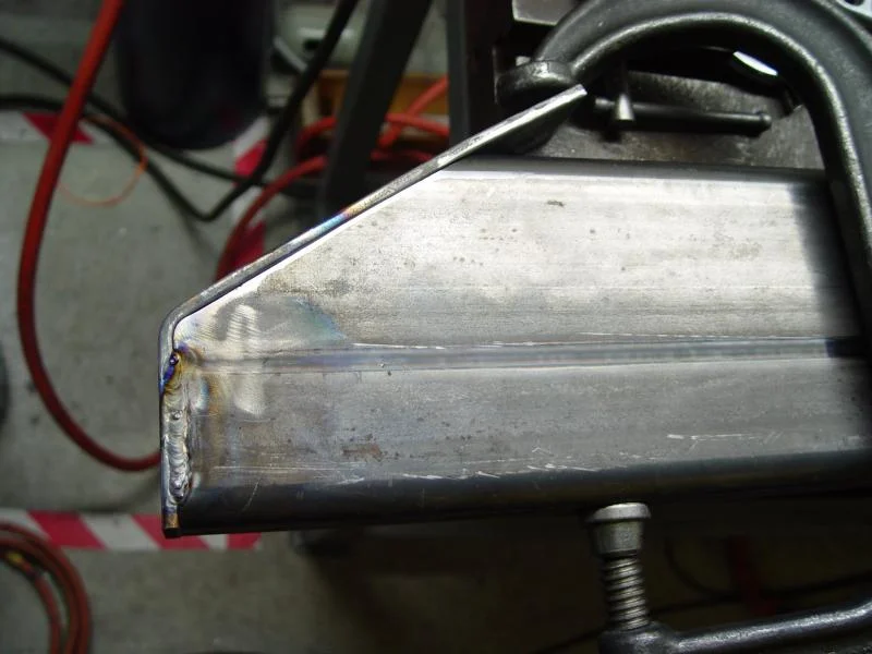

pic 1 shows the first method of putting on the end cap.
Didint look to well so I cut it off and went with plan B
pic 2 Shows what it looked like.. really wasnt that bad primer and paint It woulda looked good.. but I strive for perfection. Rarely attaining but ending up with an acceptable outcome.

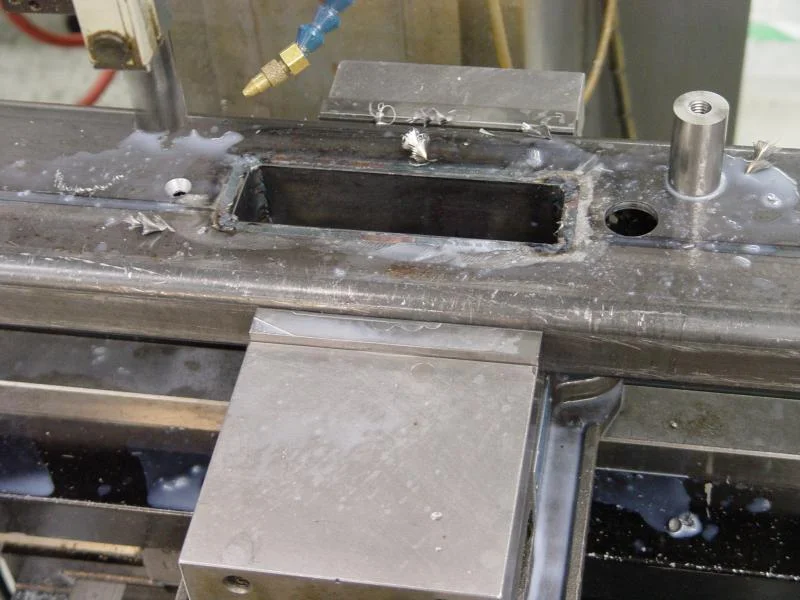

pic 3 Shows the holes cut for the FairLead and the shackle mount
I have a bellvue winch and have to make a new mounting plate and put a couple of new holes in the bumper for the lower mount of the winch.
More to come.
