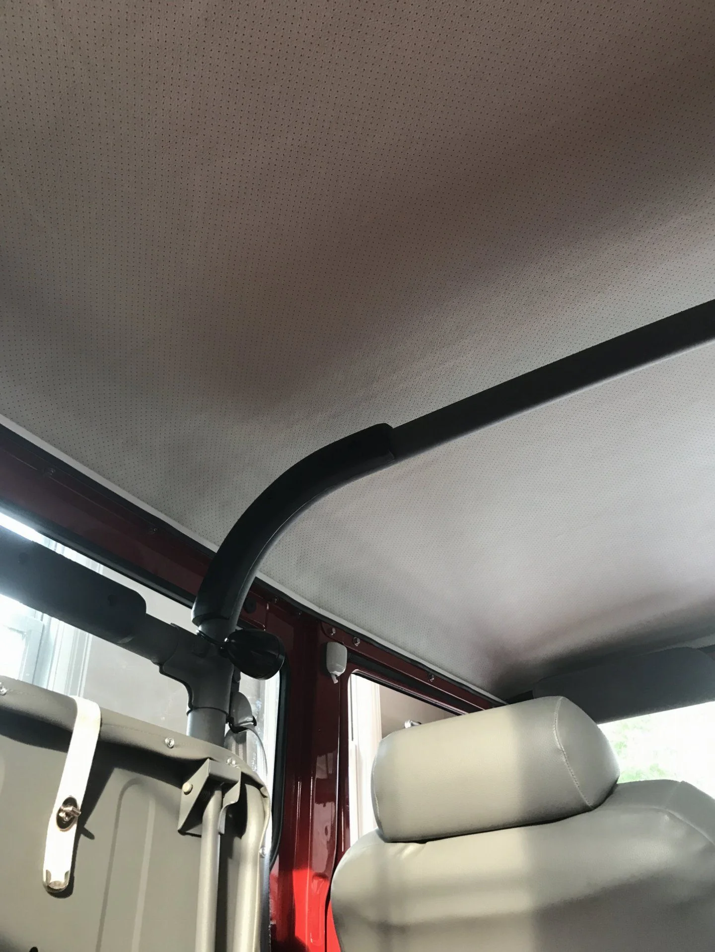

Picked up my top today. :bounce:
That looks really good matches up nicely !!

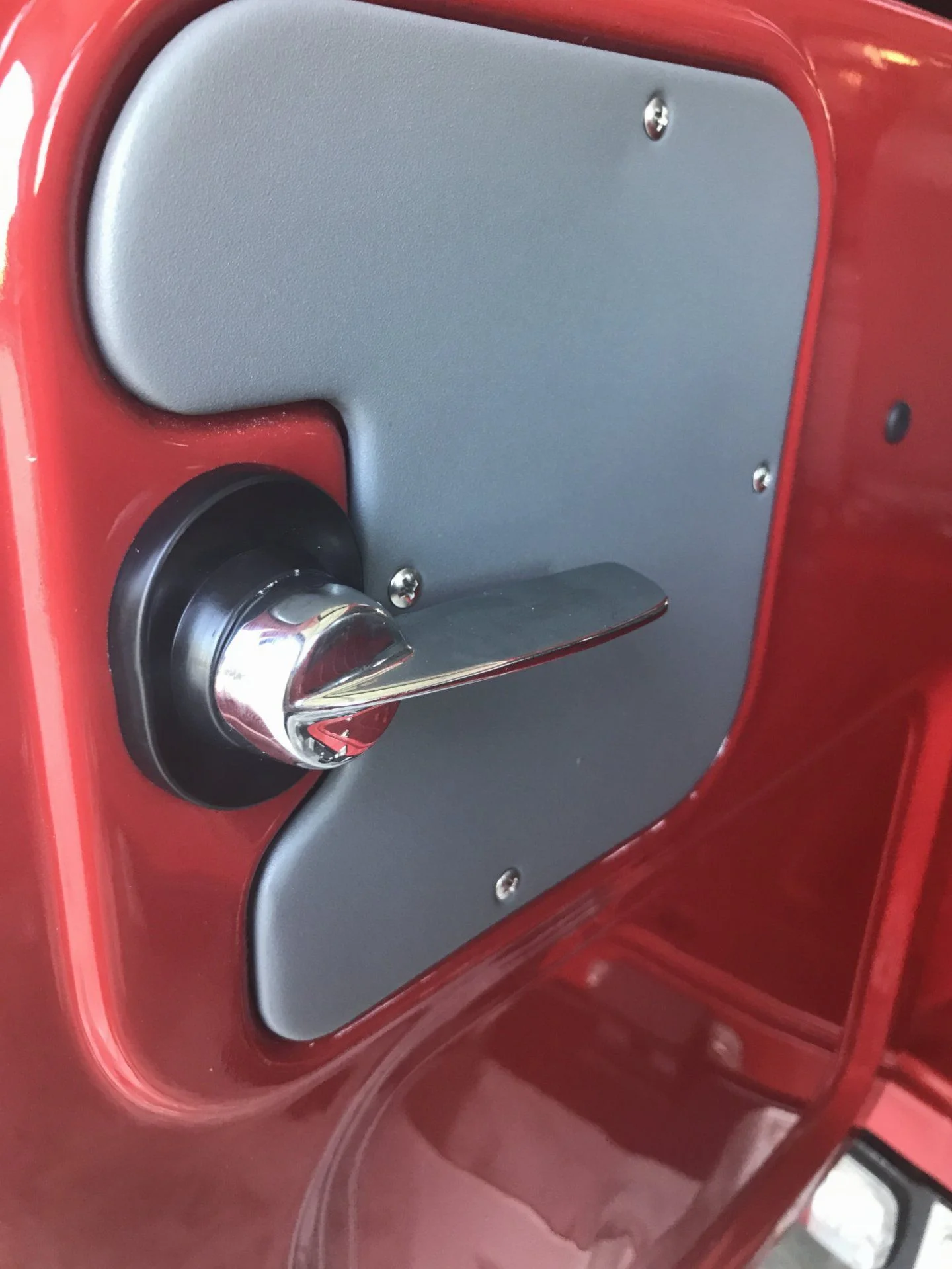

yes, as far as I can know. the escutcheon (black cover) came from toyotapartsdeal.com The handle came from one of those overseas ebay sellers. Took about two weeks to get here due to Irma, but they sent an email about the delays, came in Toyota packaging with part number on bag just like the hundreds of parts I've bought in US. No indication that it was a copy. Rear door escutcheon part number is 69265-60010.
