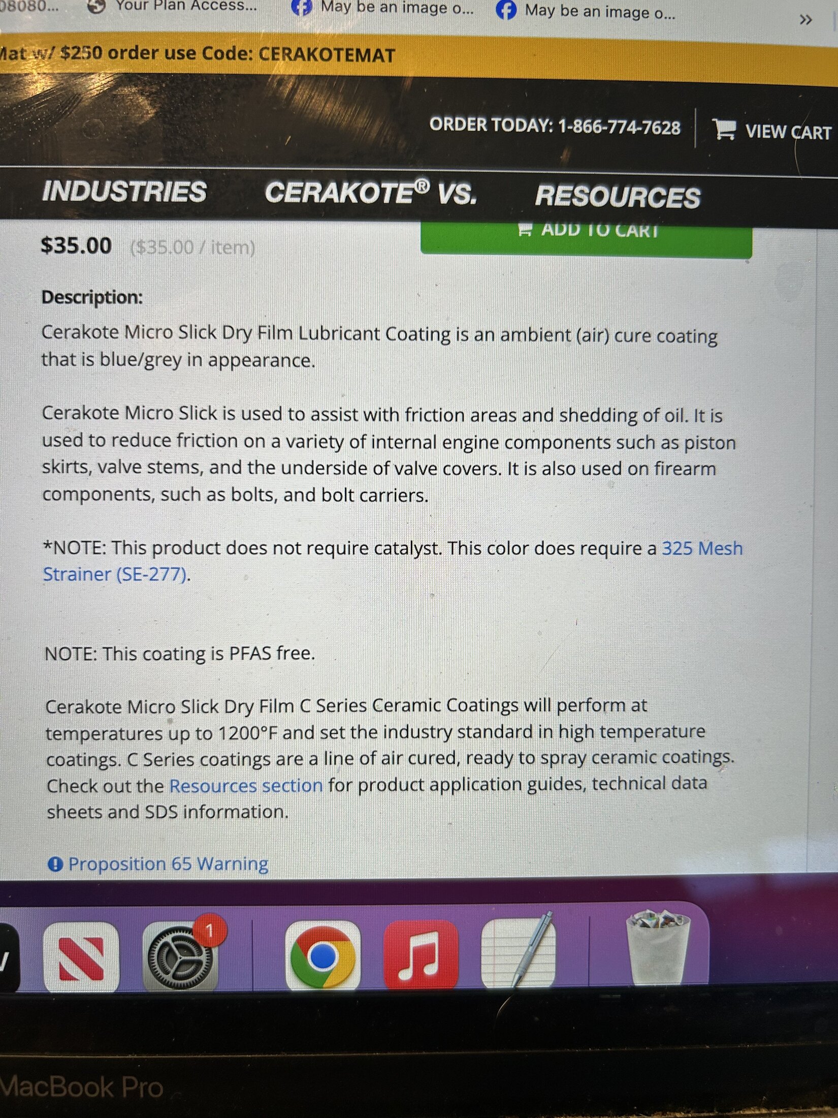

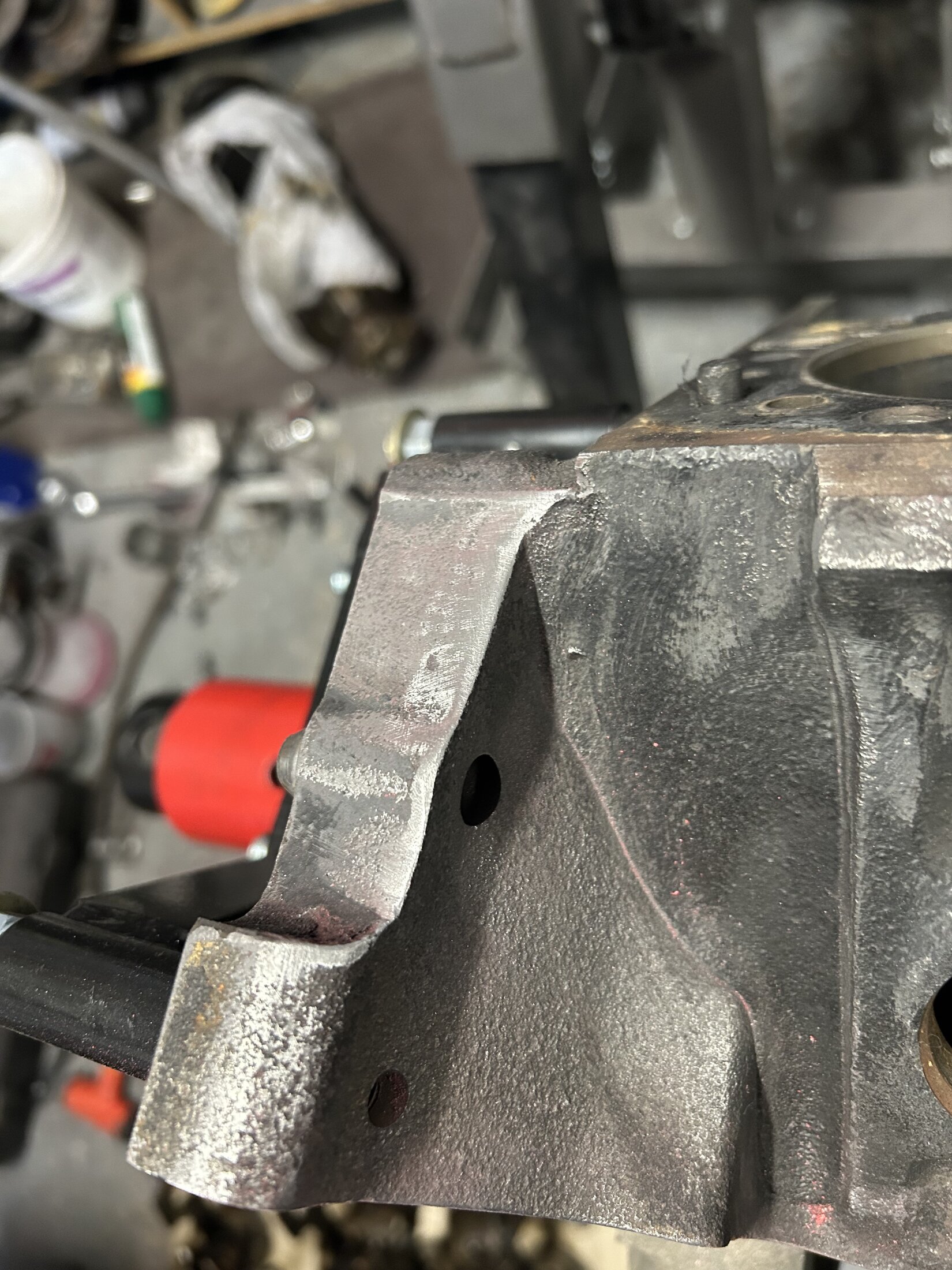

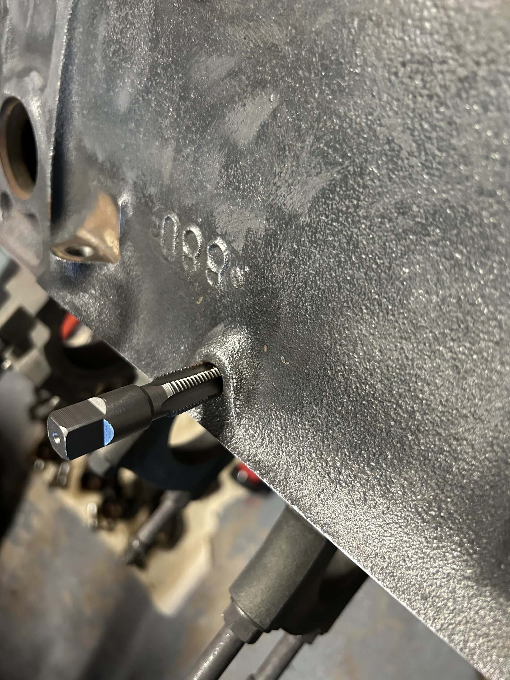

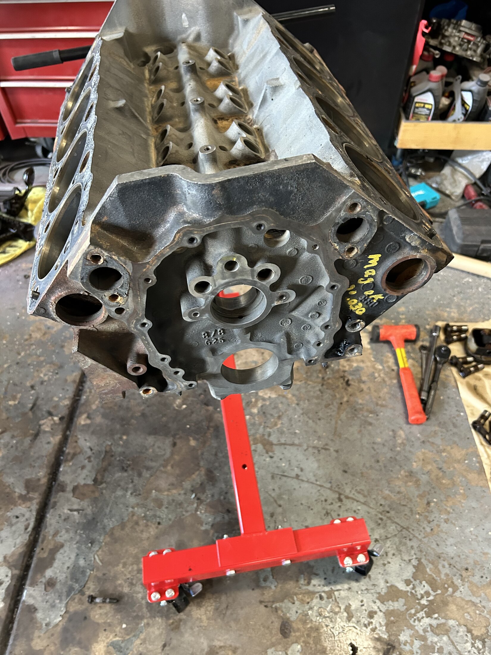

I was not sure if I was going to post Anymore since🤔. Inspector Pesty has his magnifying glasses on 😎. But what fun would that be . I picked the block up from its soak in the tub and had it magnafluxed. I also picked up some specialty Cerakote

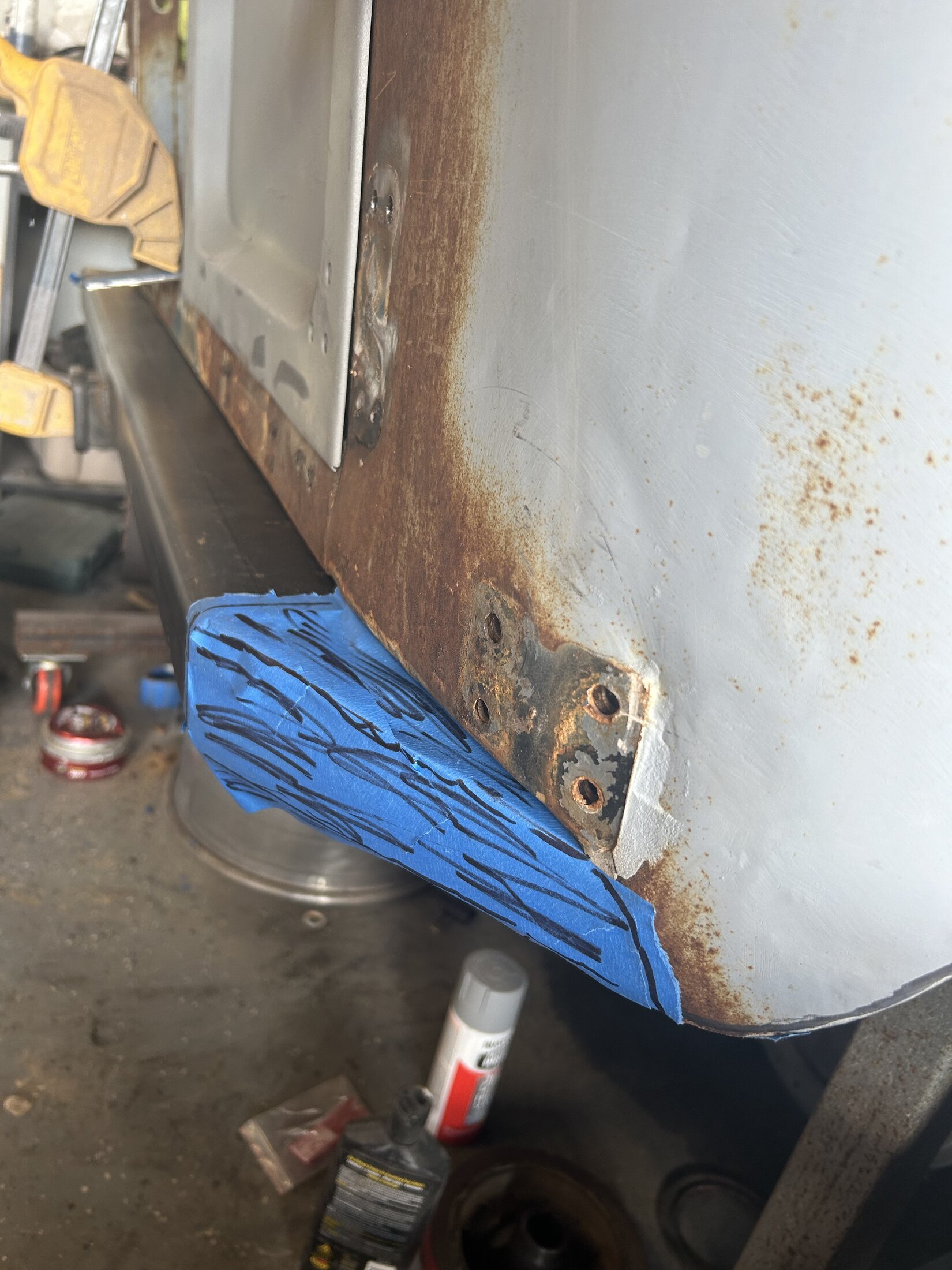

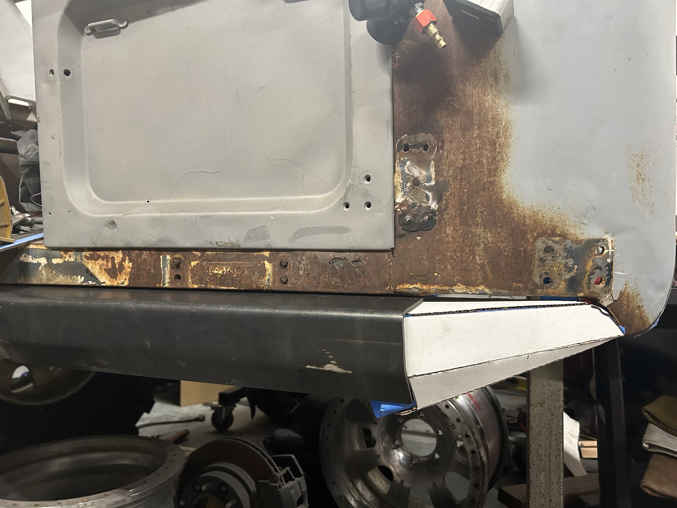

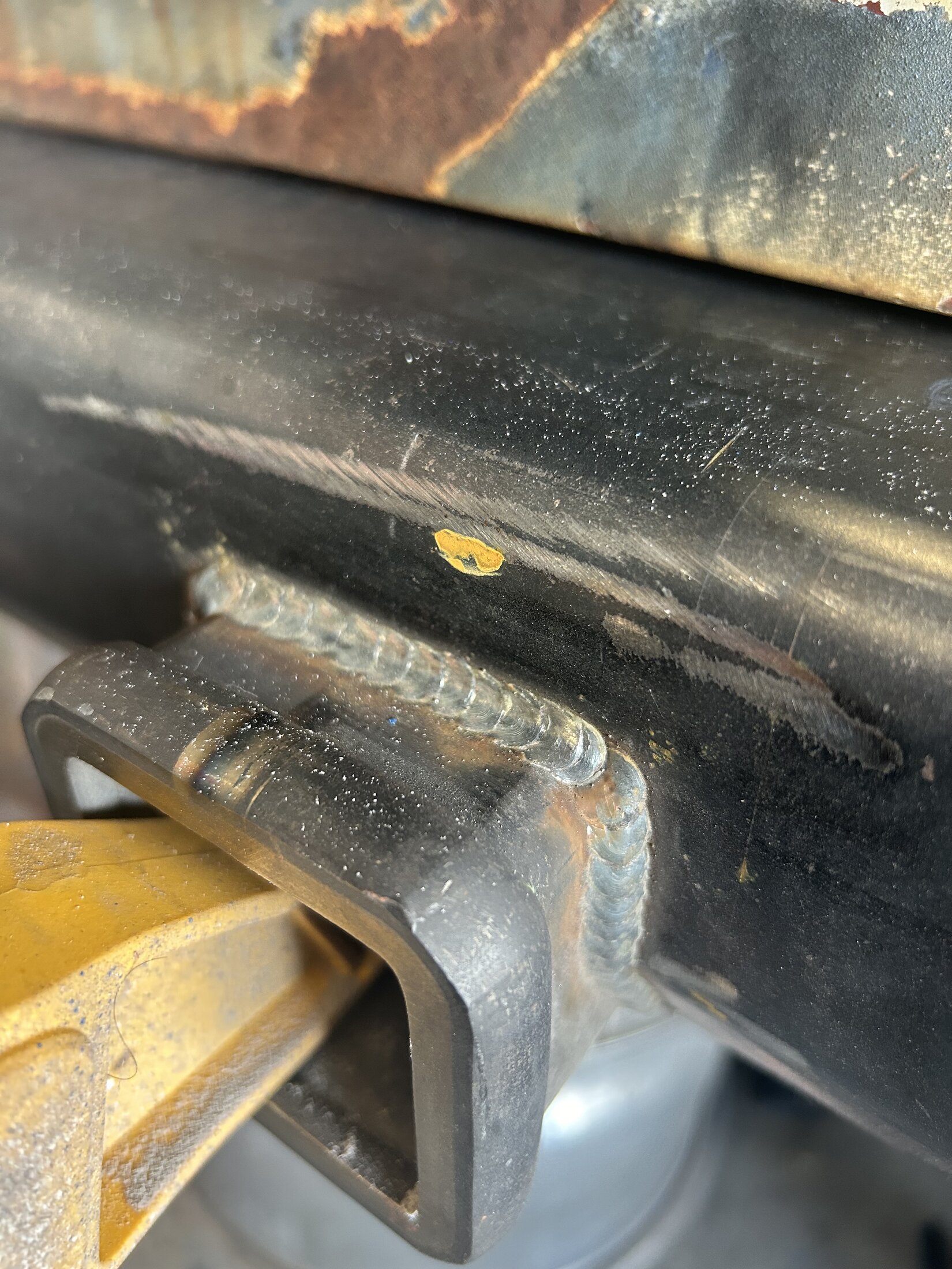

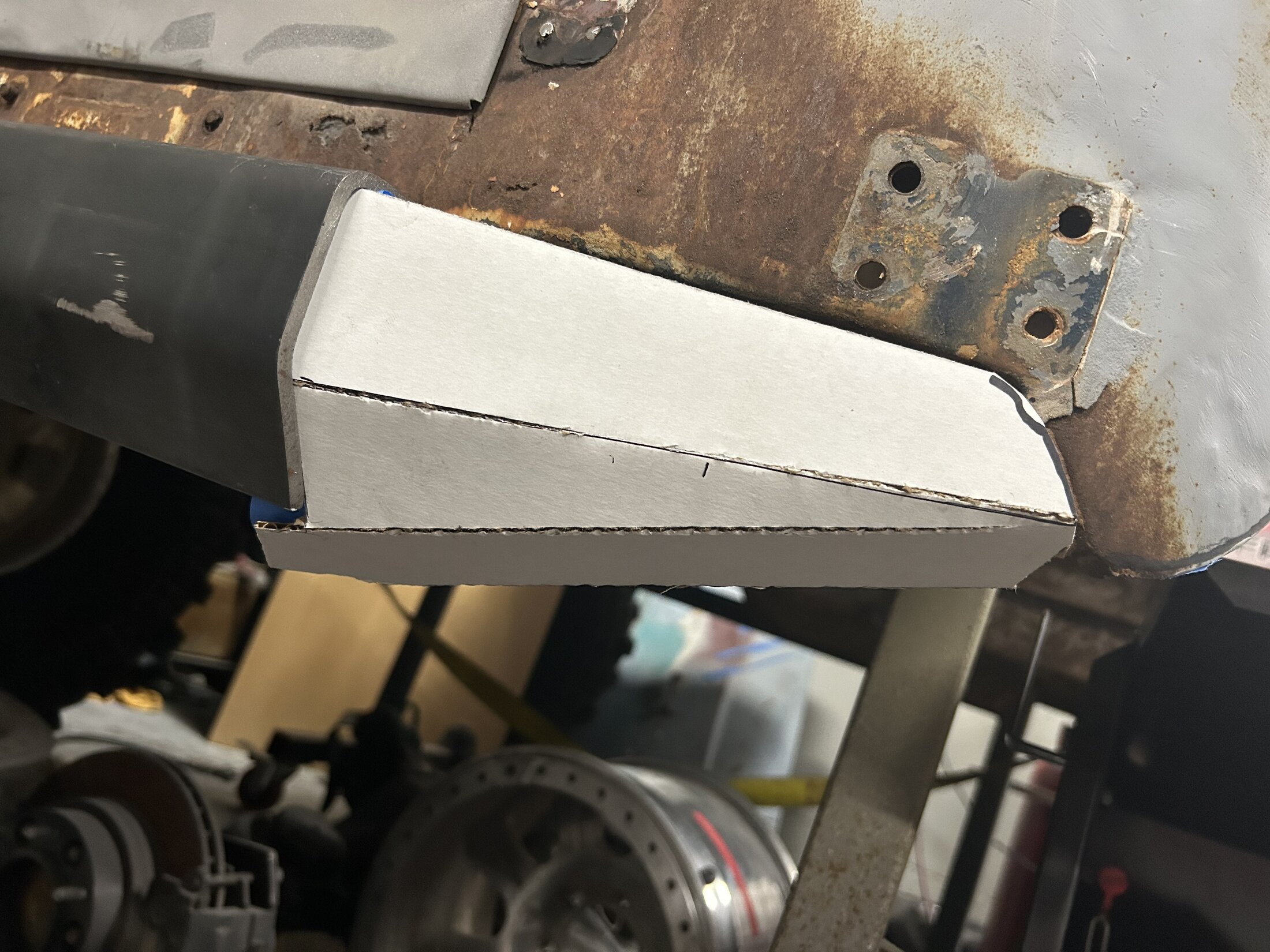

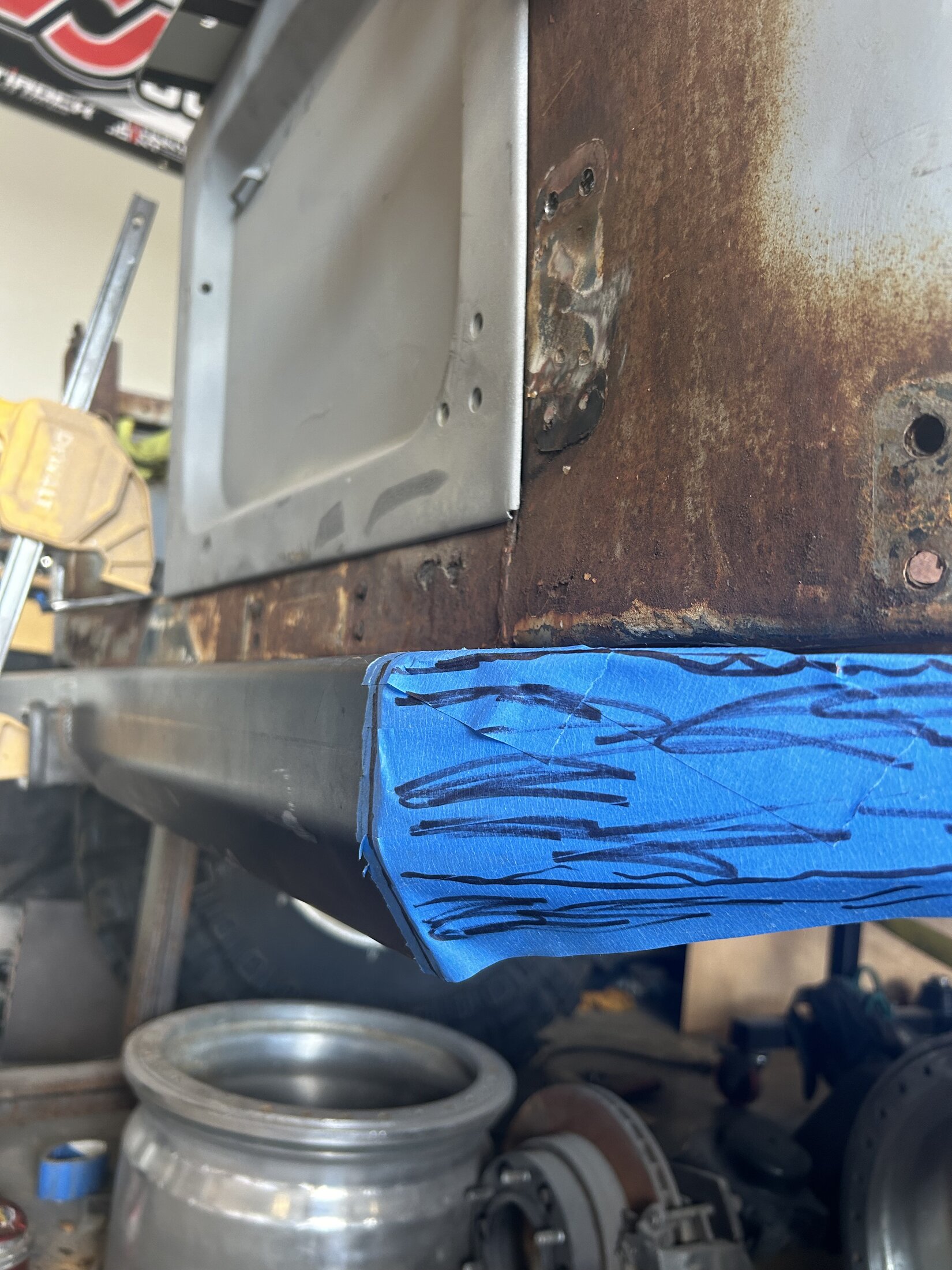

Also I figured I would just build myself my own bumper since I have a few pieces laying around . Going to tapper the ends up and in We will see 🤷‍♂️. Using old blue as a test mule 😃
Similar to something like this
After we had a design and pre production meeting 😆 Elsie got to work on supervising
Ready for the production team
Block deburring and polishing is usually done on the inside to improve oil return and reduce misc. material in oil, FWIW. Astetics are important too.
yes and i know I just dont show step by step of everything i do lol
