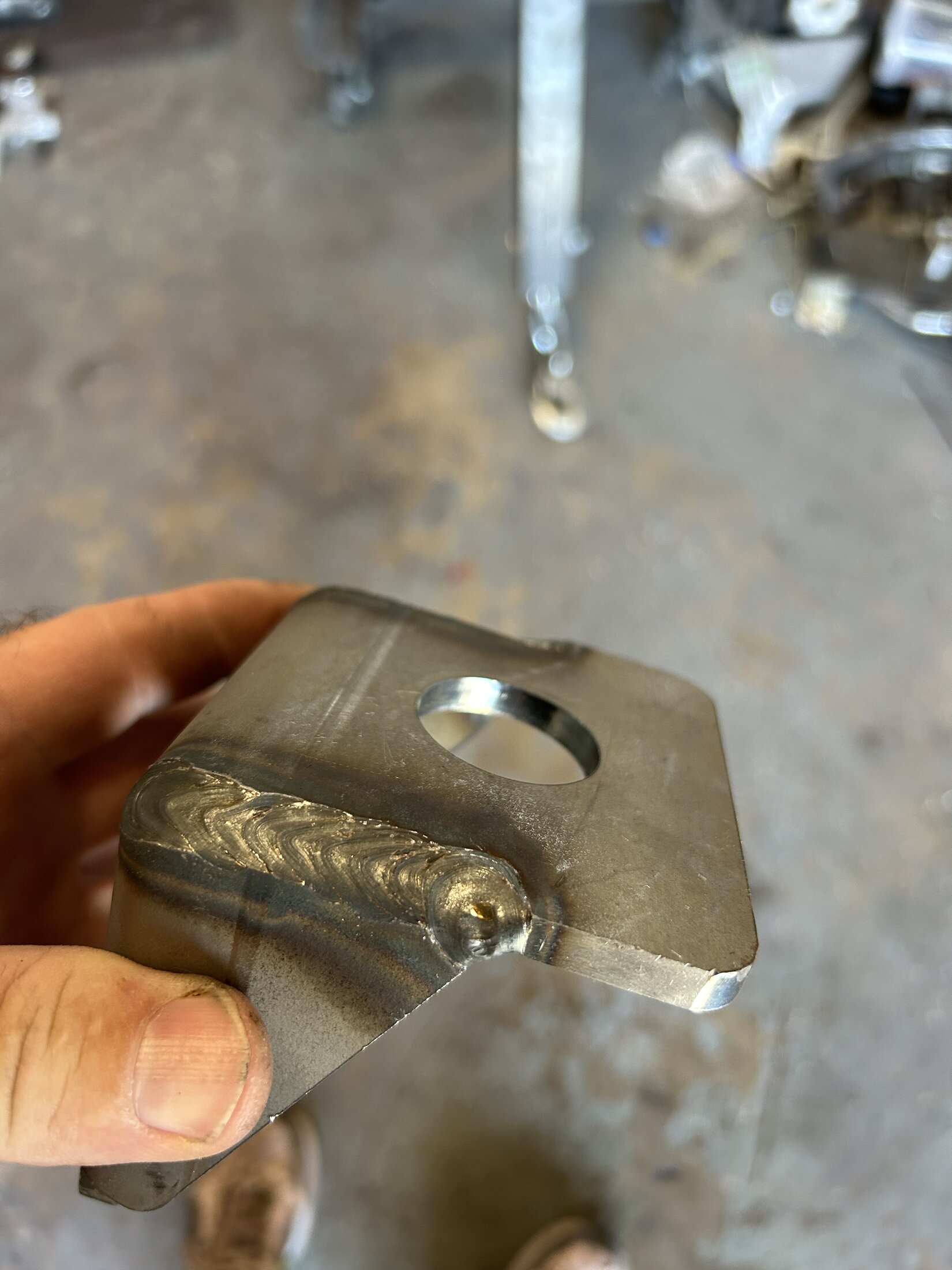

There is a reason I put them that way. I don’t think the 40 knows if they are upside down. As they work the same either way. To put them the other way means pulling my exhaust and that not happing right now
Yes I understand the puck has that little part that sits in the hole. But my frame mounts do not have a1inch hole. And to drill them is not as easy as you think The rubber works the same either way

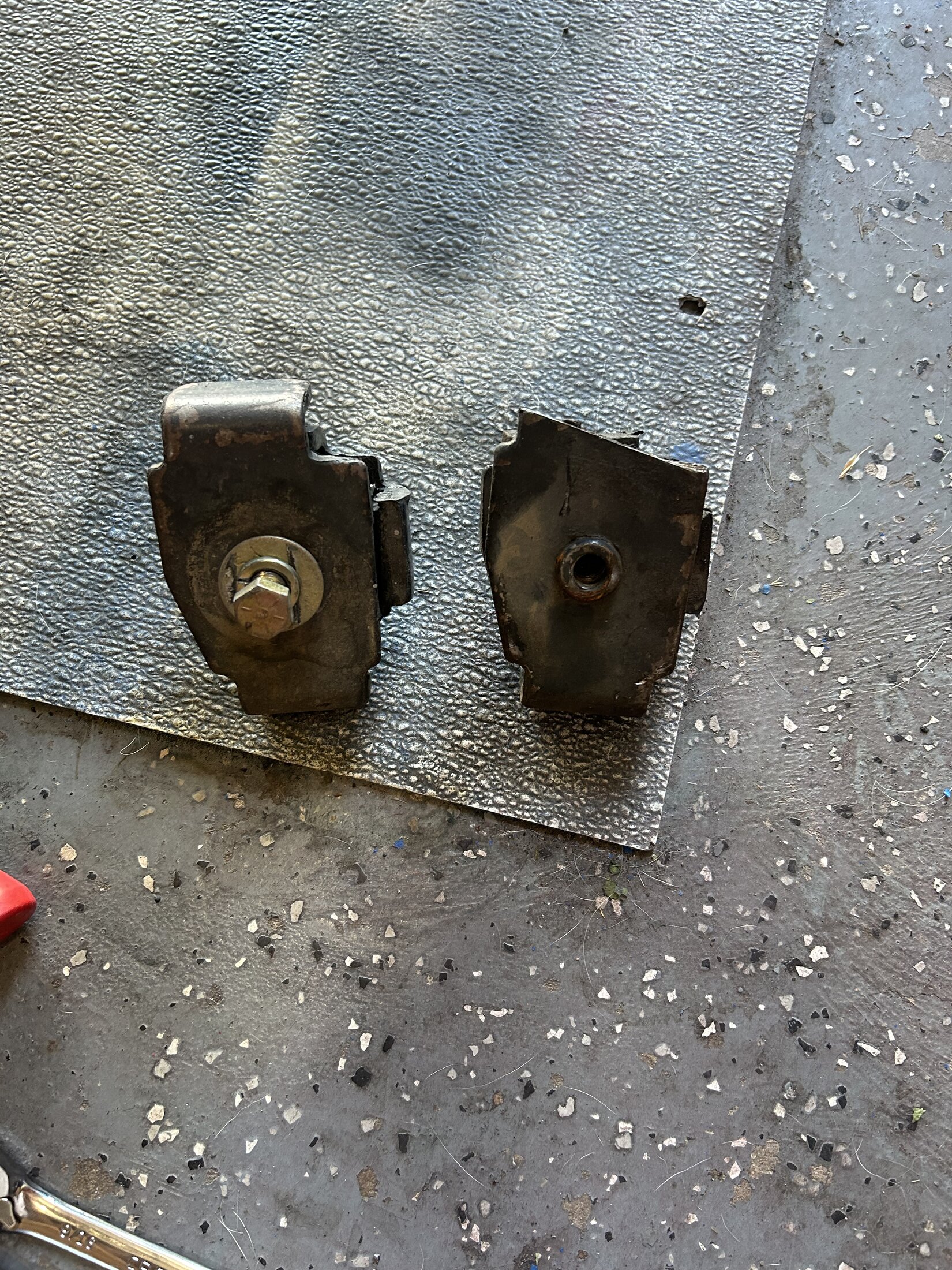

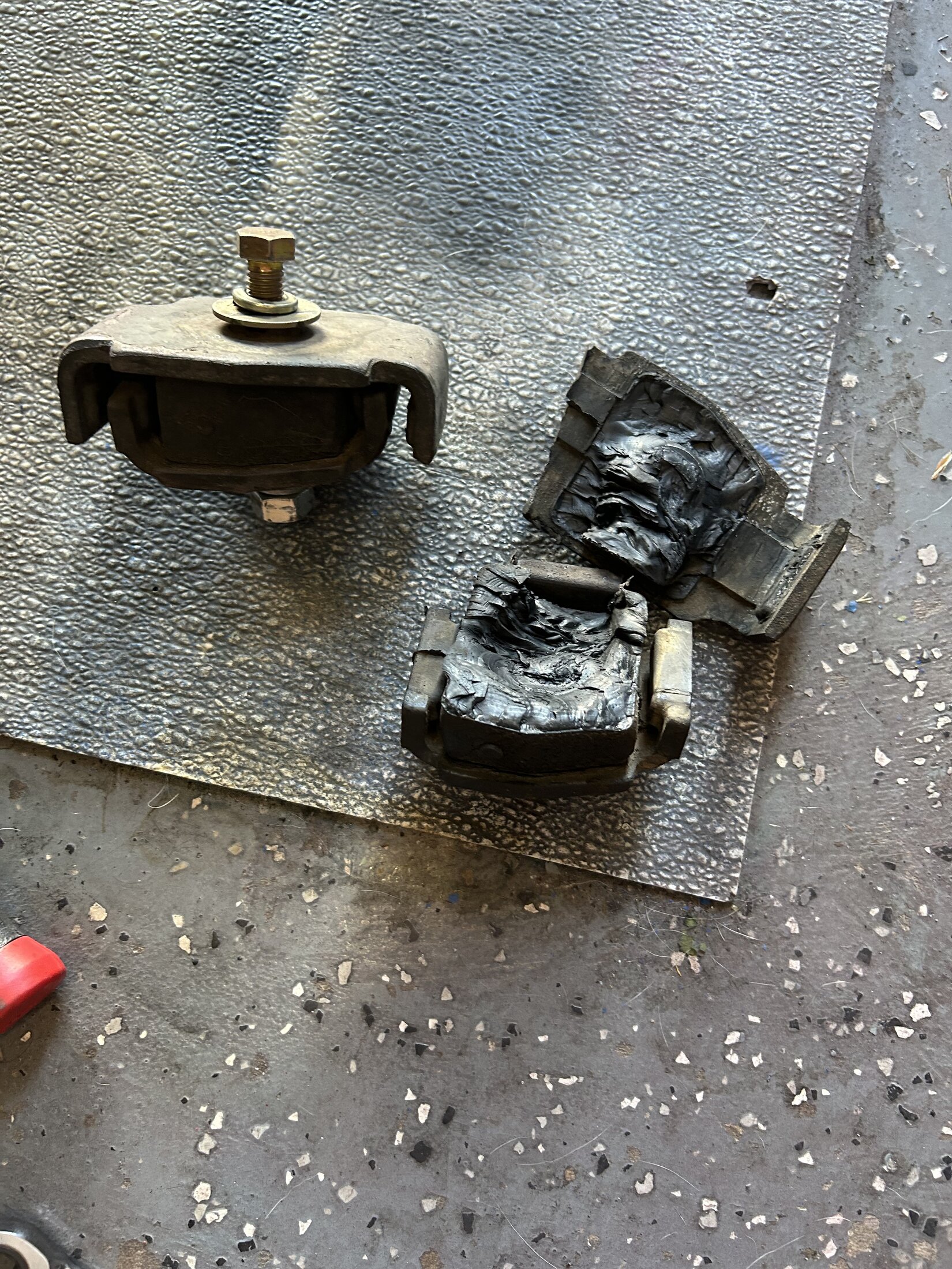

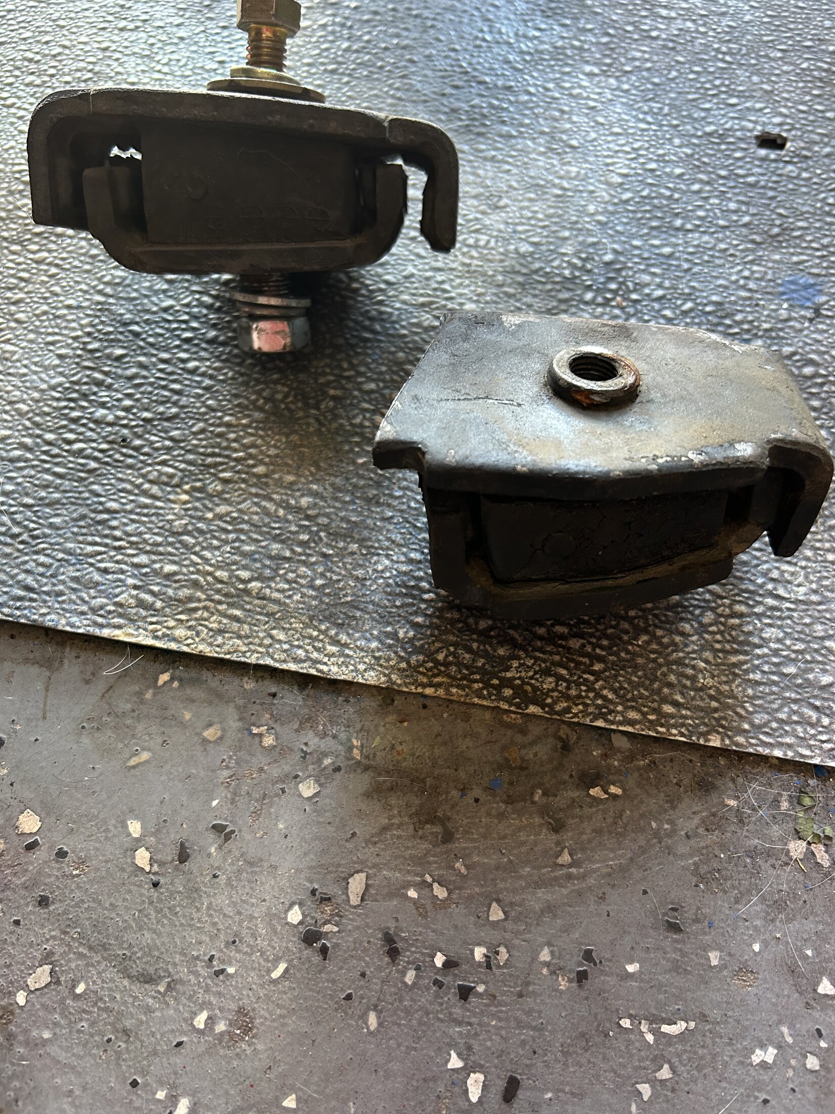

So my 40 had a clunk when I would put it in reverse. It’s been this way for over a year. And I have never been able to find it . Today I figured it was time to change out the motor mounts to the ones that I originally bought . ( I honestly do not remember why I didn’t put them in to begin with 🤔. Anyways I found my clunk . They looked fine and it’s been fine . Glad I am fixing this kinda stuff in my garage

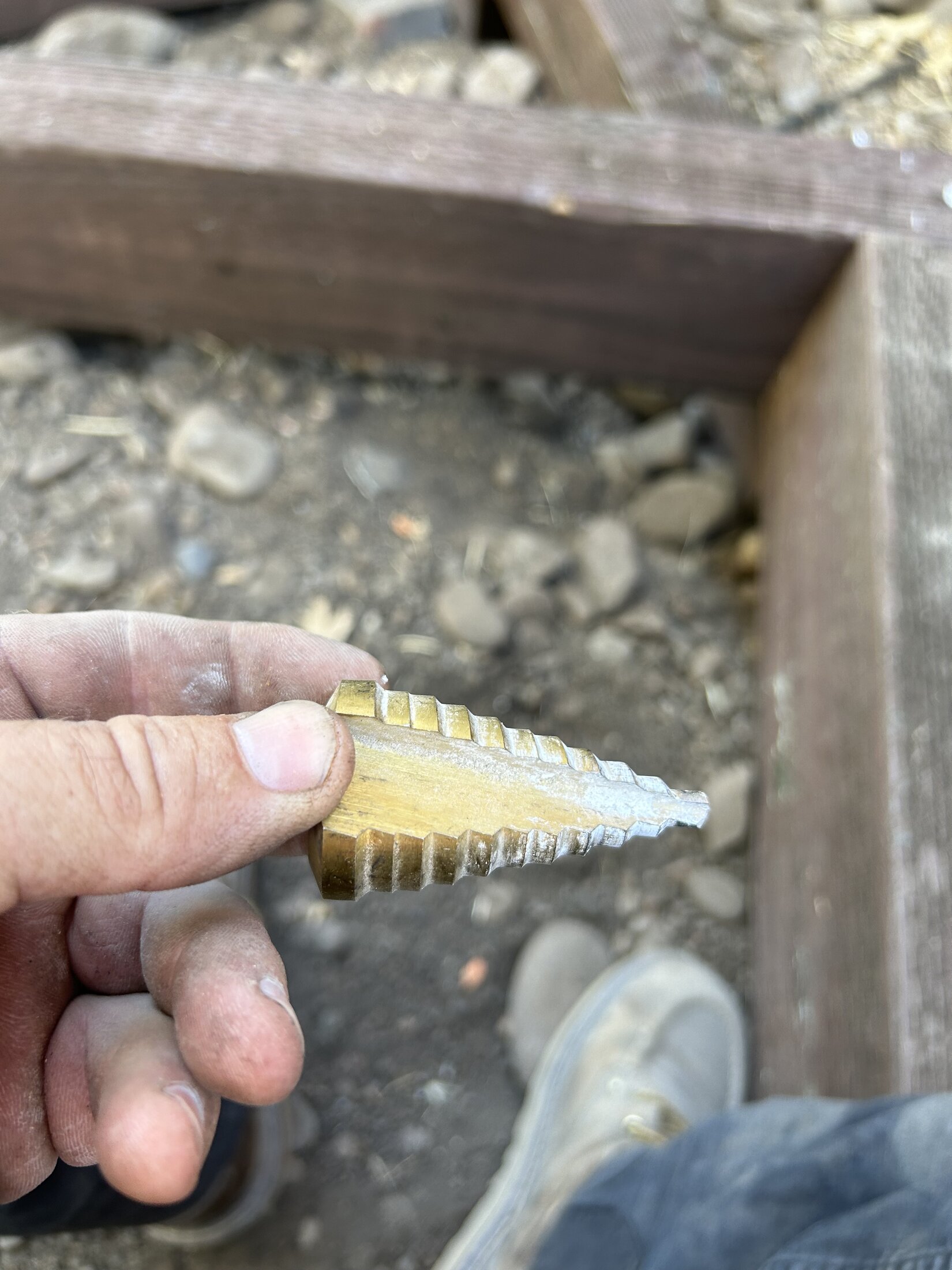

Well I have not slept in several days now. After Pesty made his concerns about the rubber of the motor mount being upside down 😞. And I was just looking for something and it was as if it was a sign from pesty. There it was my step bit to drill out to 1inch 🤩. Don’t you worry Pesty. We will be sleeping like kings soon enough 🥳
