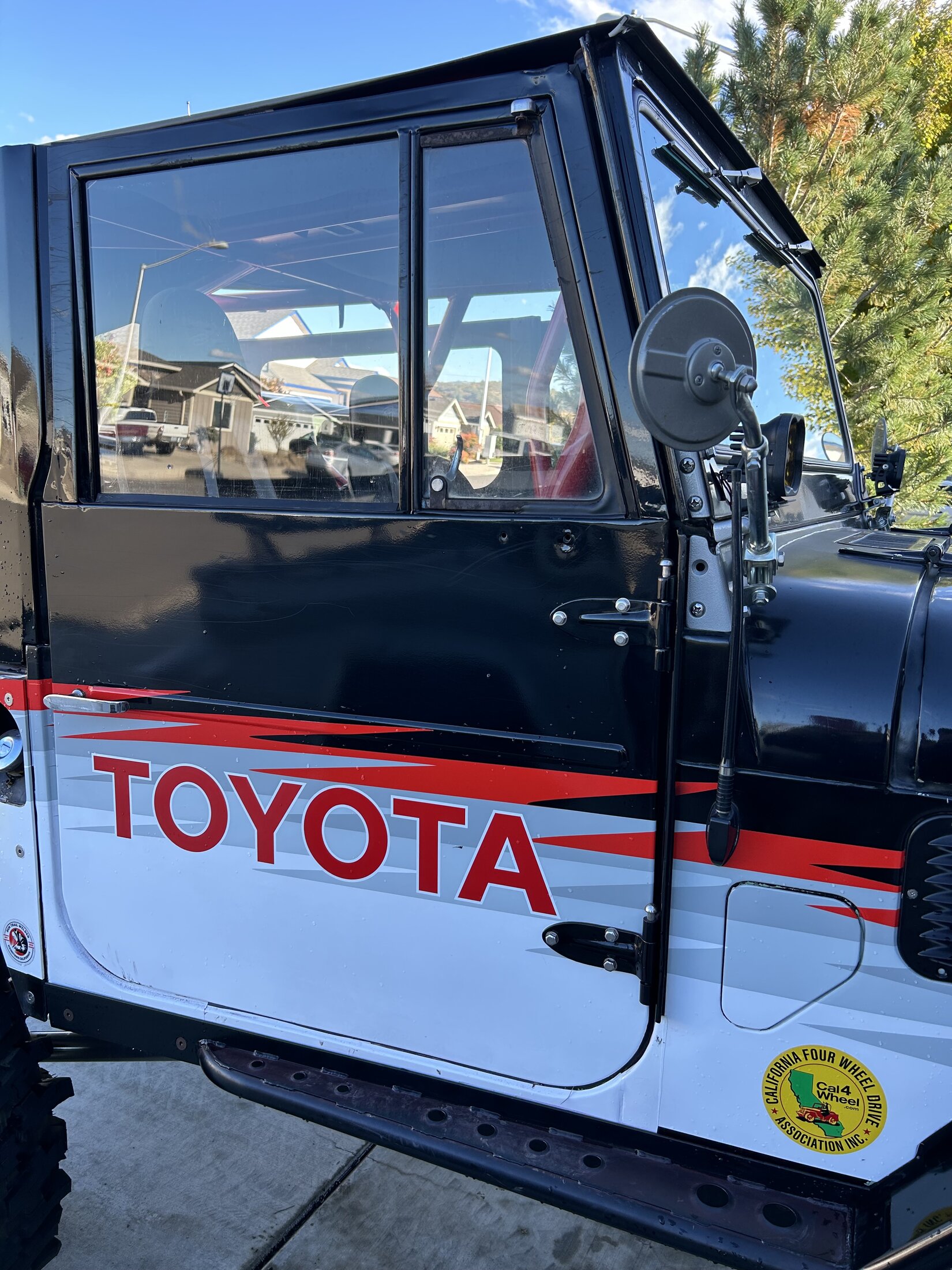

After 3 years I finally have windows that roll up
And down 🤩. Snow wheeling soon enough 😎

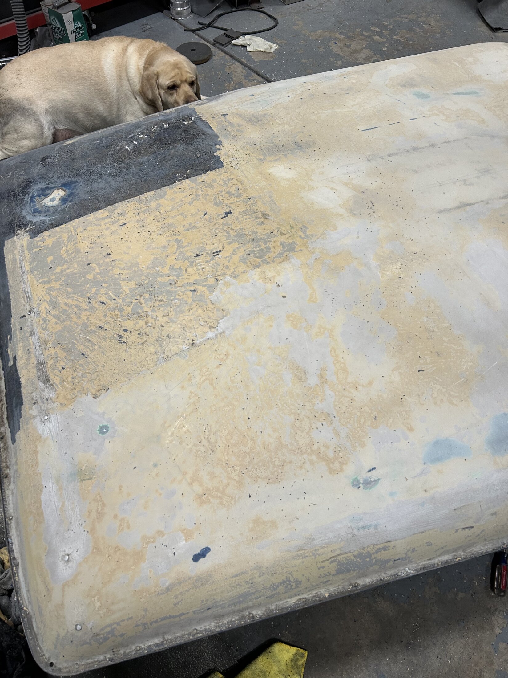

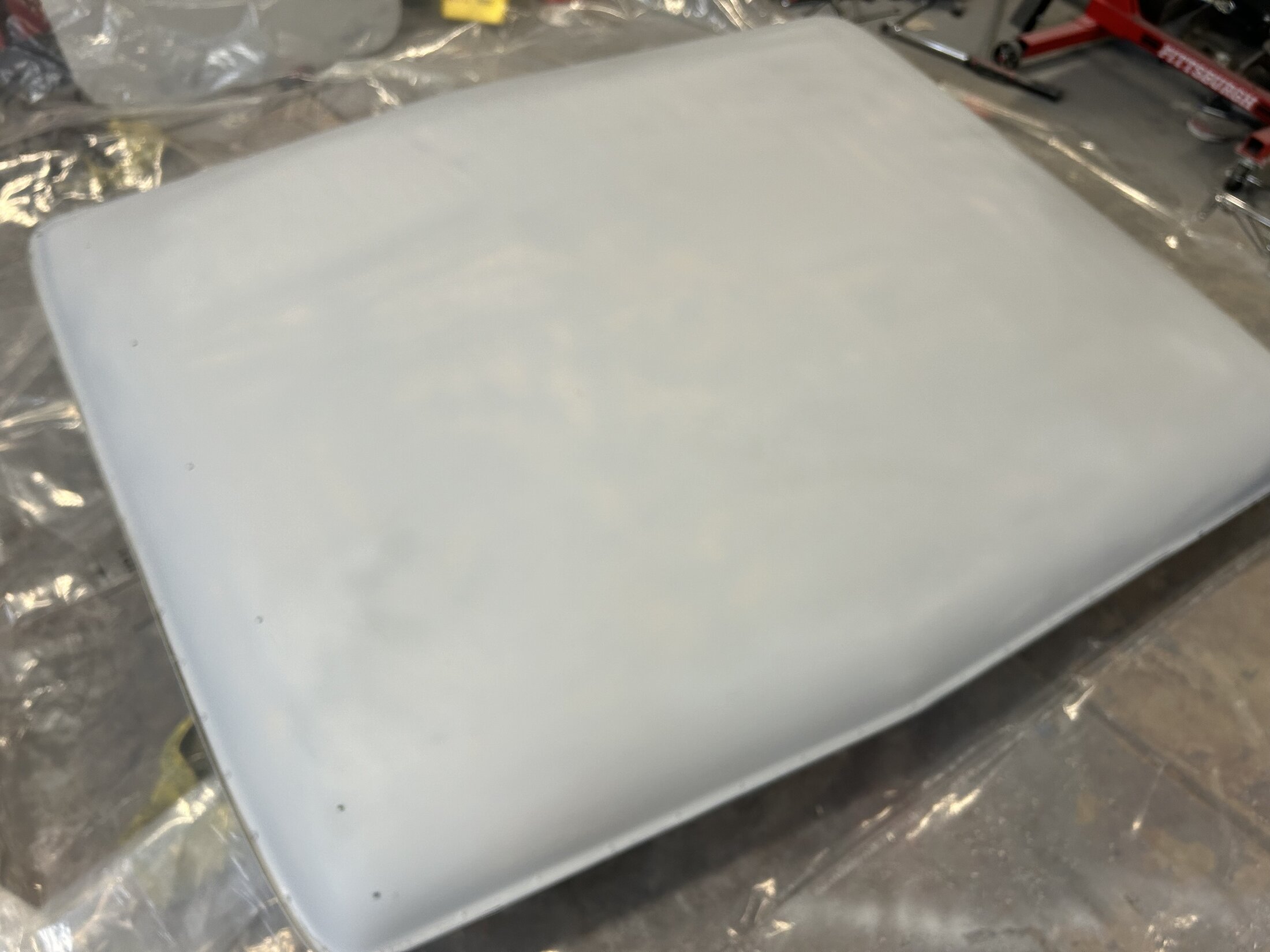

Finally I decided it was time to finish old crusty . Today was the day 💪. Sanded. Primed and raptor lined . Looks better than a purist build 🤷‍♂️🤩😳. I am undecided if I want to just spray the underside 🤔 or get a headliner . Going to sleep on it

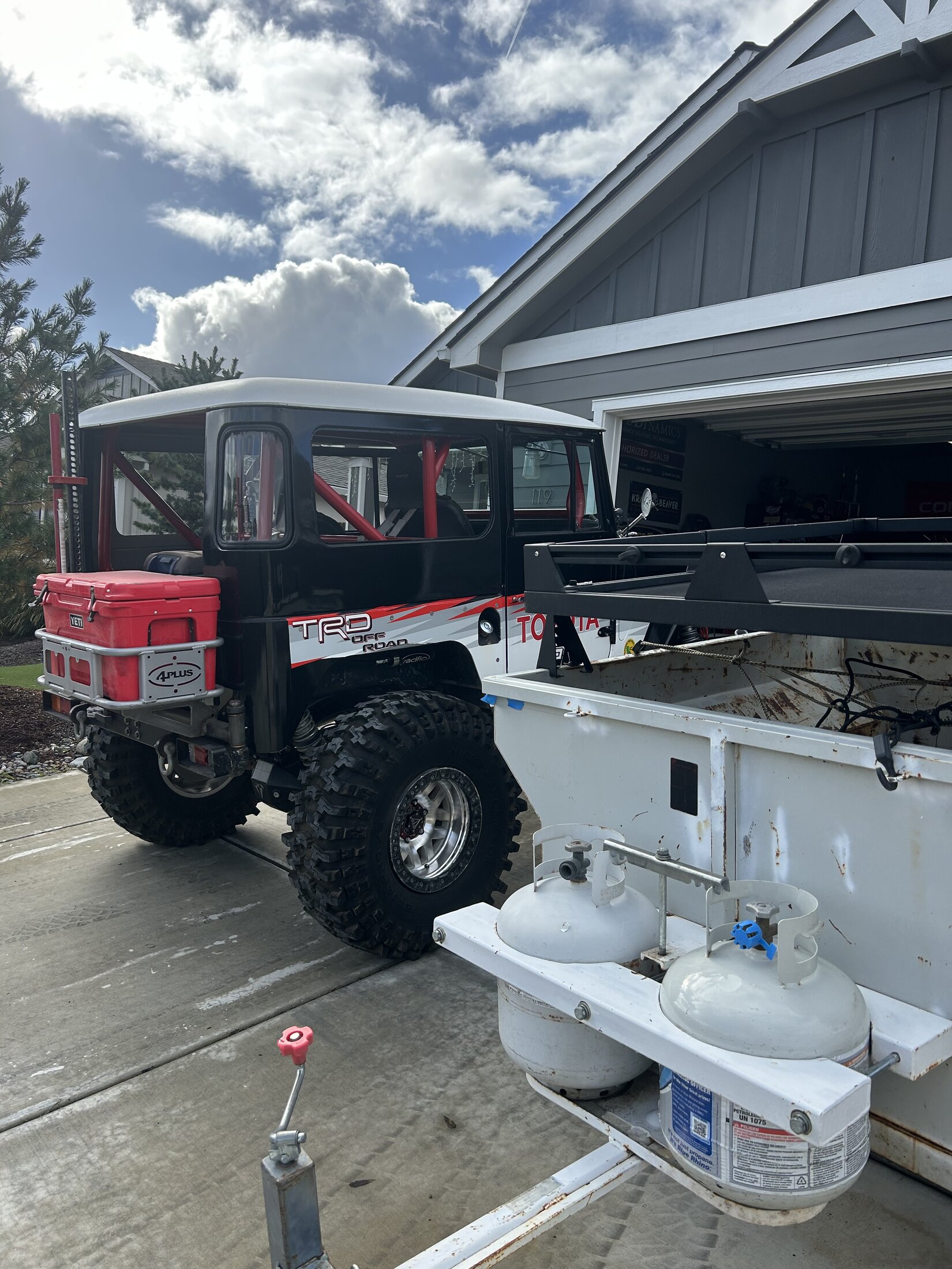

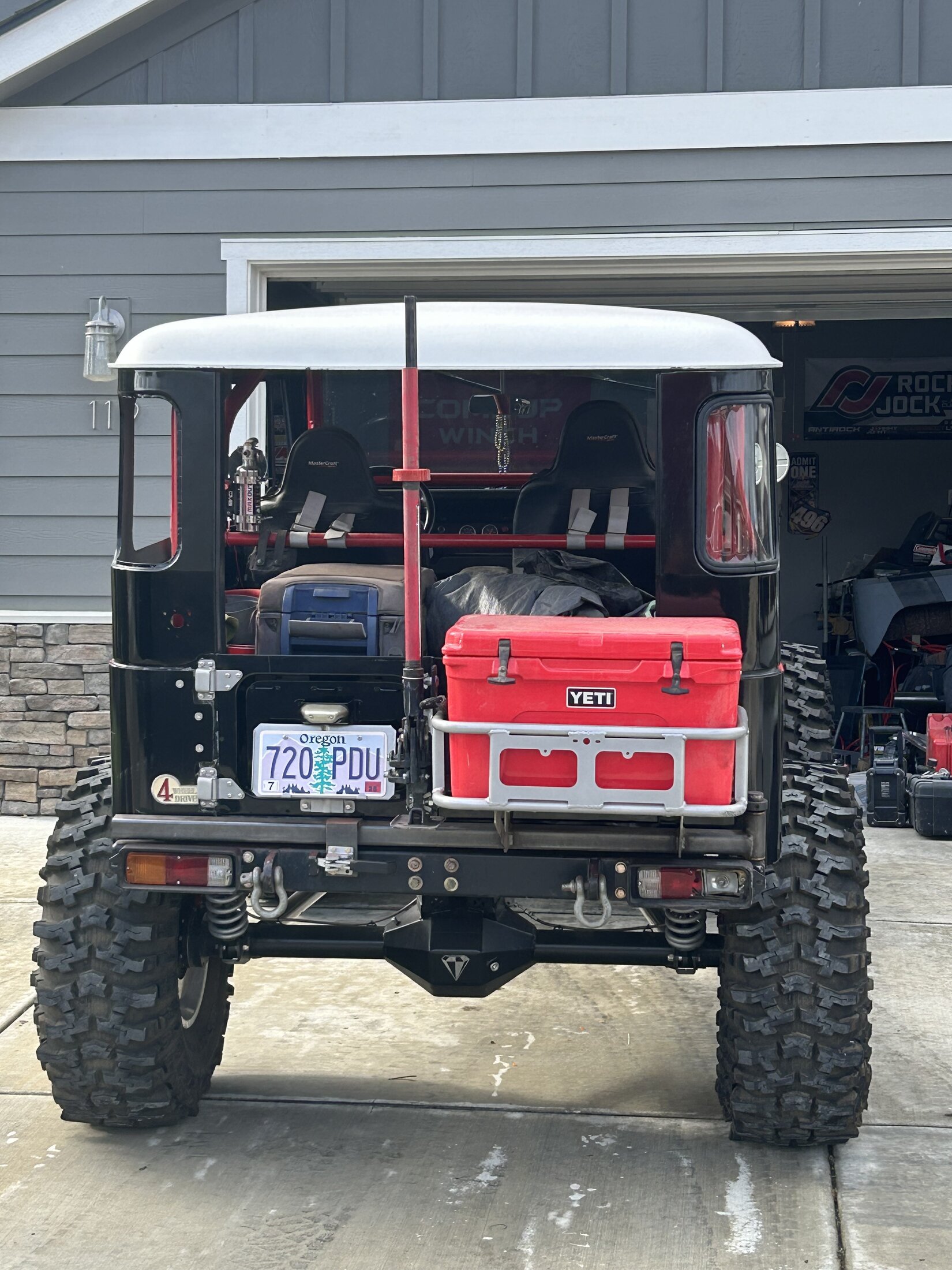

I have all the oe heater parts I just have my Battery mounted where the Blower should go . I am looking at some electric heaters ? Unfortunately space is critical . Elsie takes up half of the rear area as it is . Driving it on the street is not really a issue It drives fine I just would not take it on a trip . I drive it around Tahoe when i am down there and Rubicon to Fordyce . The front end is a little wider than i wish it was . I can narrow it 3 inches buy changing my wheel hubs just not sure its worth it . If i can get the top done and some sort of heat Maybe even just a 40 rear heater would be ok ? and i can get it in the snow then i am sure that will make me happy . Off road its a beast . I am going to get a SM465 trans today Not sure if that is going in the Blue 40 or i just say Enough is enough and pull the TH400 trans . I really would like to have the engine back a few inches . I have had Many very nice Toyotas and not 1 has been the perfect rig . This one is getting close but its never going to be a Buggy that drives like a new 250 . The burning question in me is what would i need to do to make it ?
And before Pesty Blows it up 12x with his magnifying glass. Yes i see the little spots on the drip rail Pesty . I need to Flip the top and prep it and spray the underside still I just needed to make some room and put it up there for a few days

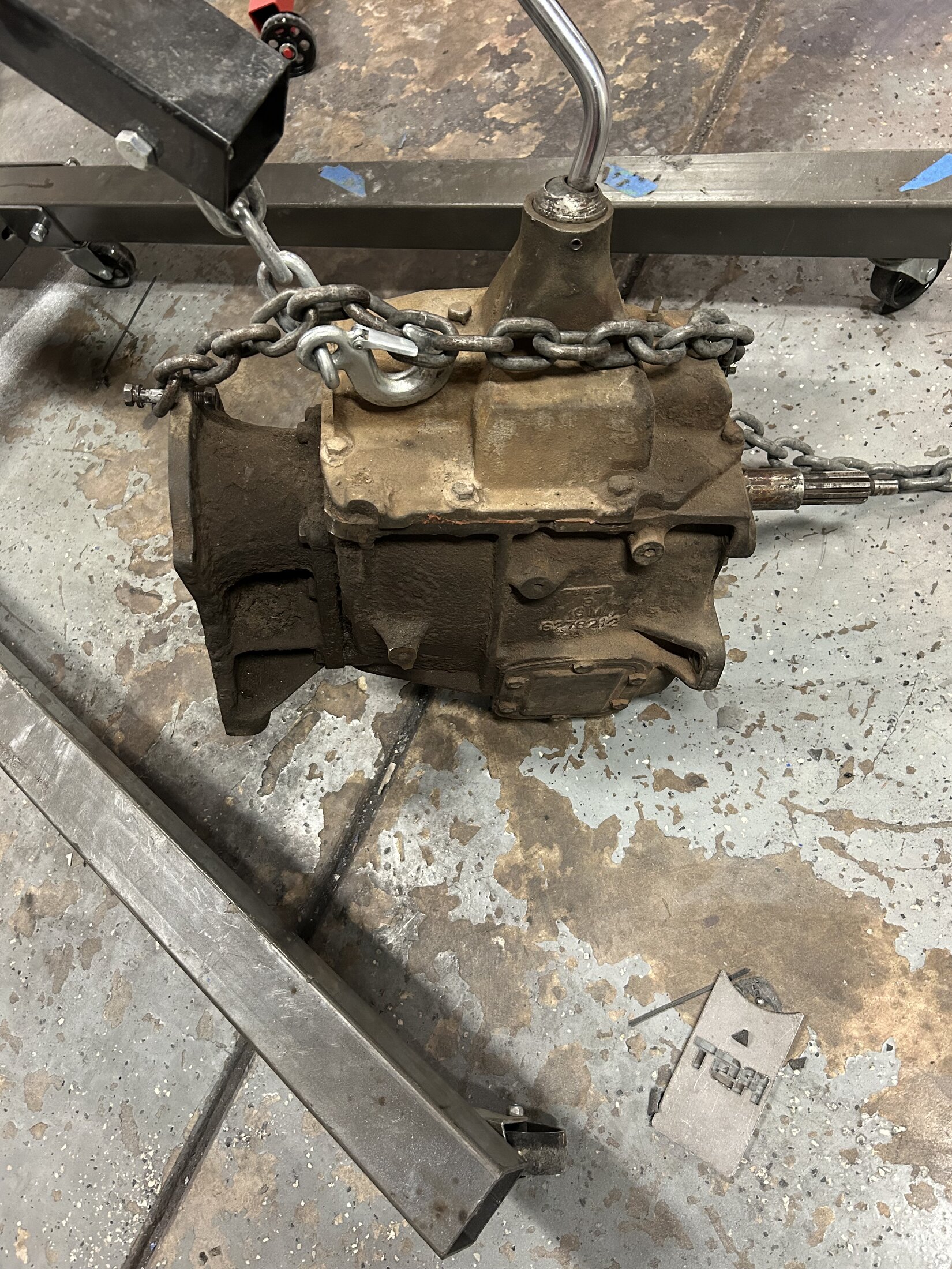

So not sure if I will go this route or not but it was a good deal and I may just do it . SM465. I have to see if I get the behemoth t-case or atlas If it will be any shorter I really want my engine back a few inches . And I would like a real front u joint. With the th400 it small like a little jeep u joint
I have to see maybe I can use my Orion still . I really hate to spend another 3500 to do the same thing it does now
My sm465 is perfect for me, but our local driving tops out at 60mph. It’s not a smooth shifting machine and on a grade it could use another gear between 2&3. But for putting around the valley and trails it’s a good comprise.
An auto would be nice on the trail, but I’ve accepted that this may very well be the last stick shift I own. It also fits the old school mentality perfectly.
i am hoping with a 465 and my orion or if i go atlas it will be low enough . I like my auto i just do like how close my fan is to my Rad Yes it works but i can just feel that fan eating that Rad at some point when i drop down something hard .
